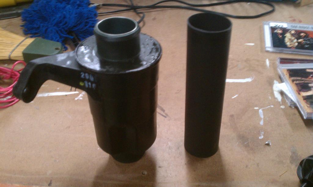

Alright guys I finally got this done. I was on vacation in my hometown this week and had my Euro master mechanic friend help me out. What took him 10 minutes would have taken me quite a bit longer! As previously stated 8" of 2" diameter exhaust pipe was perfect. Total cost with paint was less than $15.
Here are the pics.

Resonator and delete pipe comparison:
