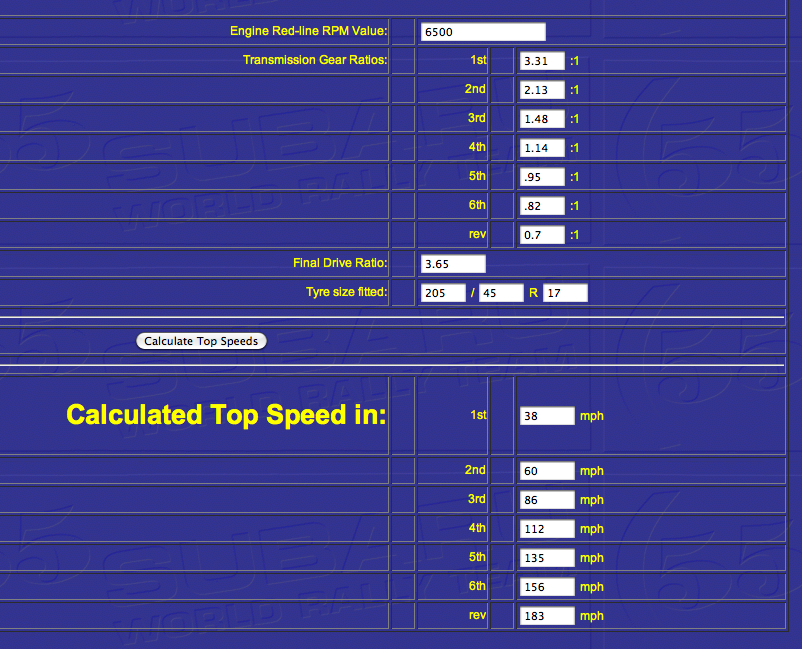

This is what I got:
Your speeds are off by ~15% it seems.

Wow, looks like we should be using reverse for max top speed

Those are pretty similar to the numbers Harry's gives me. It seems to be calculating max speed as 85% of max revs. I'm not aware that its made a difference to anything.
Edit To Add: It seems to be calculating max speed at max power, 5500 rpm.

Seems like you're right! When I changed the max power to 6500rpm from 5500rpm, all the speed calculations are now correct. I guess I will keep it this way.
