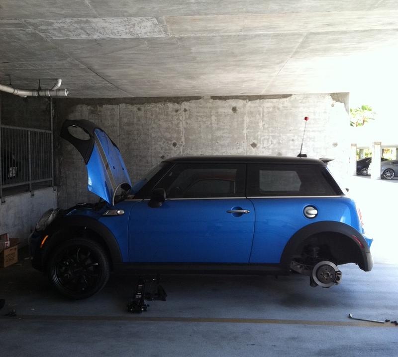

That's what I do....

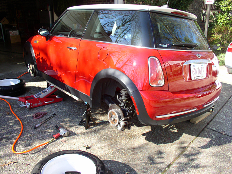

The board for jacking under the door sill should be a 2X4, not a 4X4. I use a low profile "racing jack" placed under the board as close to the front jacking point as possible. It will lift both wheels so you can put jack stands at the front and back jack points. I also have wooden blocks that fit inside the recess of the jack points. The wood sticks out a little so the jack stand is sitting on wood instead of plastic.
