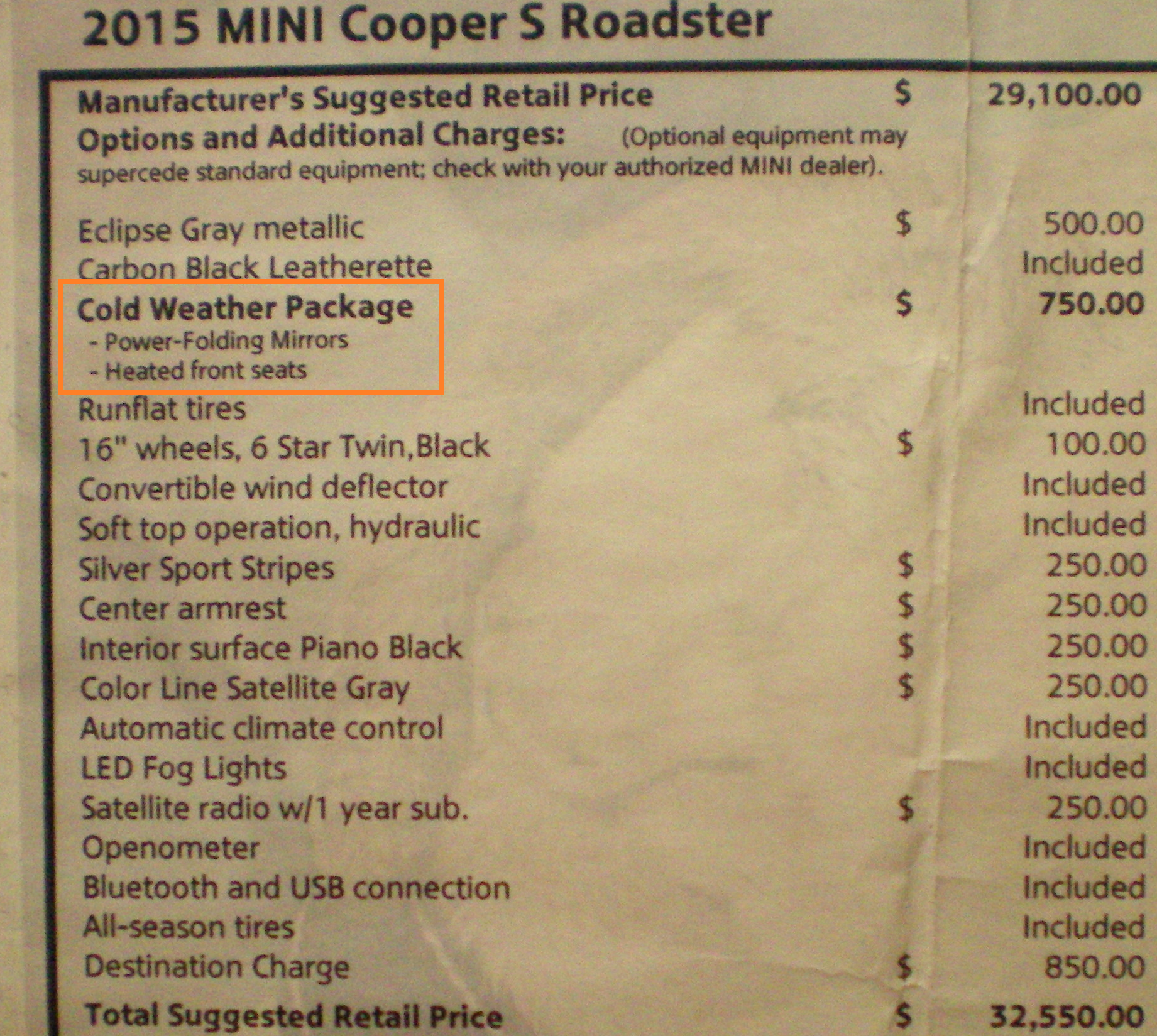

on my '15 R59 S, folding mirrors (manual) were a part of the cold weather package ..... not standard equipment
