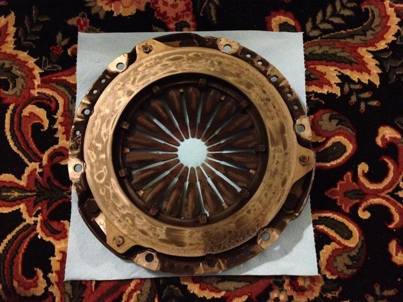

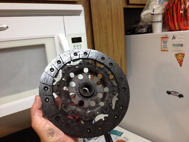

Well I finally picked up my MCS today, boy did it need a clutch job. When I finished paying for the work I went to drive my Mini, put my foot on the clutch pedal and holy hell I thought the dealer screwed up the hydraulic system. Pushing in the clutch pedal was so easy I thought something was seriously wrong. I remember it requiring much more force to get the clutch pedal in, my leg would get cramped at a red light, no more!
When I looked at my pressure plate, clutch disk and flywheel all three were super shiny! My clutch disk was worse on the flywheel side, my flywheel had cracked in many places do to the extreme heat. Just have a look! Is this the fault of the parts or the previous owner? I mean what does one have to do to get a clutch to look like mine?
Attached Thumbnails anyone change their transmission fluid yet (R56)?-img_1037.jpg   anyone change their transmission fluid yet (R56)?-img_1057.jpg   anyone change their transmission fluid yet (R56)?-img_1065.jpg
