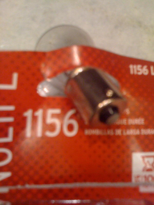

One of my tail lights burned out and needs replacement. Does anyone know what the replacement bulb is? I tried the Sylvania 7528 like the books in the auto part stores recommend but its not a fit.

This is what the owner's manual says:
21 watt/5 watt bulb, W 5 W

I believe its a 7507? Or that may be for the fronts.

7507 is the turn signals. The tail/brake (dual filament) is 1157.
Ill give 1157 a shot.. or just to stop by the dealer. The bulb I pulled out did not have a dual filament.
If the bulb has two contacts on the bottom, it is dual filament. Did the base have only one contact in the center?
yes

If it has one contact and two bayonet nibs on opposite sides, it is 1156. Can you post a pic?
Thanks! 1156 Worked. Here is a photo of the OEM bulb. It's great but as you can see, single contact.
