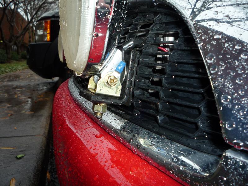

Here are a couple of snapshots. The backside of the grill just has the bolts coming through with fender washers, lock washers and nuts to clamp everything in place. The angle brackets have different length legs so they can be reversed if you have thicker lights that need to sit further from the grill. If you look close, you'll see the thin rubber sheet behind the bracket. This cushions the bracket and keeps it from rotating against the grill.
Are those OEM lights that you have? They look smaller than the Hella 500's. i think the hellas are a little too big for my taste, but they are cheap...

Those are Eagle Eye brand lights from JC Whitney. They were around $30 for the pair if I remember correctly. They're not bad lights for being so cheap, however, they are NOT waterproof as advertised. Still, they've held up pretty well and I just preferred the look of chrome over the black plastic housings of the Hellas.
