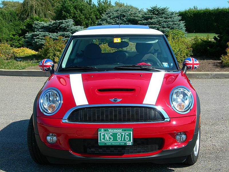

We've had a couple of days of zero degree weather here in Northern Vermont, and my 08 MCS (her first winter) has had no problems so far and hasn't made any bizarre noises. (knock on wood.)
