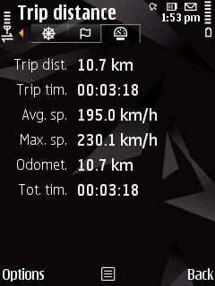

This is the speedo VS GPS!
Attached Thumbnails Speedometer Accuracy-screenshot0008.jpg   Speedometer Accuracy-18112008380.jpg
Hey, Mom, look! 240kph with one hand on the wheel and one eye paying attention! Wanna try?
Old Nov 21, 2008 | 08:54 PM
uae247's Avatar
uae247
Joined: Sep 2007
Posts: 35
From: UAE
Apologize,
But it was TWO hands OFF the wheel.... to avoid Camera shake, you know!
