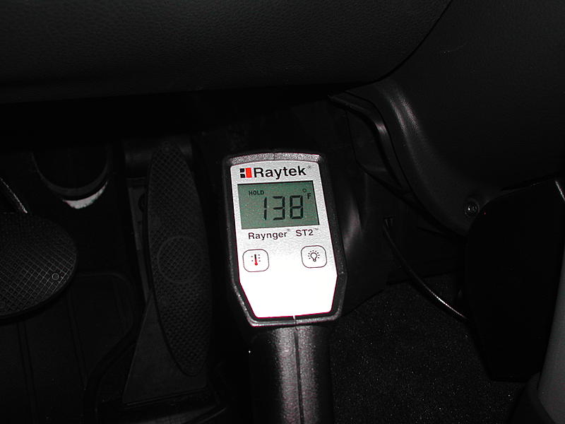

Attachment 30105The foot well on my '07 MCS gets incredibly hot. I have heard of others complaining of this issue. I took the car to the 2 local dealers (Vista and Lauderdale Mini). Both said it was a design flaw that I would have to live with. From what I understand, there is no shut off valve to keep hot water from circulating in the heater core when heat is not wanted.
They took readings with an infrared thermometer and got 138 degrees on the side next to the gas pedal. It should be noted that it only takes 15 seconds for human skin to get a 3rd degree burn at 133 degrees.
My wife can’t drive the car - she wears open toe shoes and has burnt her feet. I live in S. Florida. We wear flip-flops here. Not with a Mini – you’ll burn your feet.
Mini refuses to fix my car. They offered me less than wholesale when I requested to trade it for a BMW. I have hired an attorney to try to get a lemon law buy back. Failing that I plan to make it my mission to let the world know that Mini has design issues and that they will not stand behind their product.
My goal is to get them to do a recall so these can be fixed. Who knows, maybe during the fight they will offer to buy my car to shut me up.
Anyone who has experienced this problem please let me know. I would like to compile a list so that my attorney can show this is not an isolated problem and that it represents a serious safety issue
Steve
Ordinary aluminum foil is amazing at reflecting heat (Stick some tin foil in your oven at 375 for 20 minutes, you will be able to pick it up afterwards, cool to the touch). You can buy self stick foil that they use for protecting lines in engine bays at most automotive stores. This may help if applied as a backing to the panel back. Wrap the lines in something to absorb heat. Foil will just reflect it back and could damage the lines.

A little information on something called tolerance stacking...
this is a phenomina when allowed manufacturing variances all "stack" in one direction. If you have 10 parts that go together, and there's an allowed variance of 0.010" per part, USUALLY the random variation in how the tolerances stack result in pretty small total variance. But every now and then, all 10 can stack one way, with a total variance of 0.100" There's lots of math you can throw at this to find the probability that this will occure for large populations with a normal distribution of parts variance, but you don't need to dig this deep to understand the effect.
For what it's worth, this isn't that rare an issue. My first job out of grad school I worked on a product that was about 16" long where the tolerance stack (prior to some re-design) was over 1/2" (lots and lots of small parts).
When you have a statistically significant percentage of a large population that show some sort of anomoly, it is usually a combination of tolerance stacking, and non-random variance in parts tolerance that combine to make a non-universal problem out of parts that all meet spec.
Hope this helps....
Matt

I drove my Mini in 90+ degree temps for 3+ hours last weekend and this panel was warm but no where close to burning my fingers.
