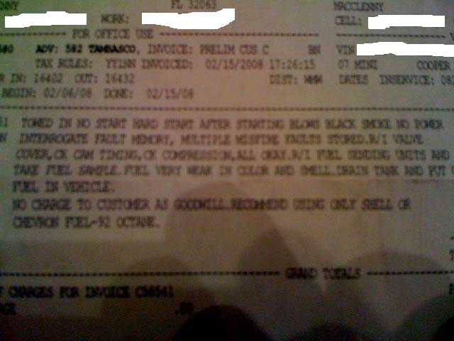

So I got the car back today... they claimed bad gas again.
The first time they told me they had done, it but the truth came out from their service manager... the tech said it only had a "wee" bit of gas in it and just filled it up. SO if the gas in it was bad, good gas wouldn't fix it. Even 3/4 a tank...
So I ran the gas out of it tonight (it was almost to the low fuel alert) and put new gas in it... still starts fine... Perhaps it's finally fixed.
They did say, no bent valves or any engine damage... like they originally assumed.

Well the car is running fine. Good news !
I forgot to mention that diag fee... That was so they could take the headers off and look-see if the valve stems were bent (I think that was the way the shoppe manager put it). Nah they never charged it.
If it happens again, I will call MINI. Otherwise, I'm satisfied
