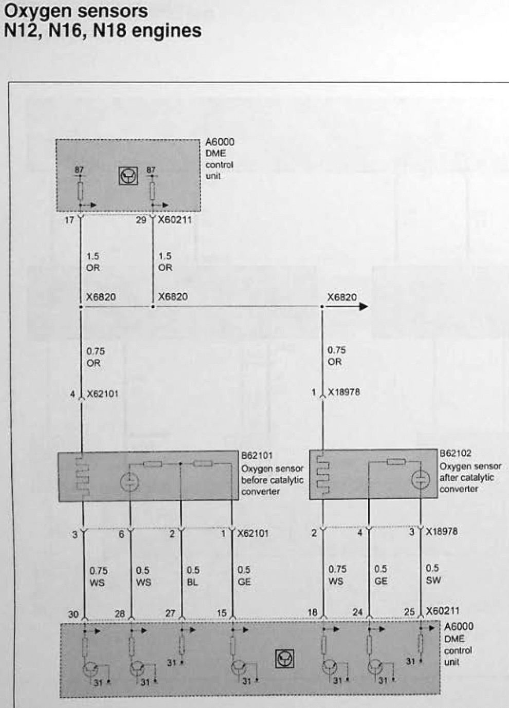

The code actually suggests that the problem lies on the DME activation/ground side (pin 3, white sensor wire) of the upstream sensor heater element, so start there.
For the continuity test, the wire diagram further suggests that the heater element white (ground) wire runs to pin 30 of DME connector B (middle 53-pin connector X60231 for the N12).

If you don't read continuity between sensor pin 3 and DME pin B30, then repeat the same test between sensor pin 3 and DME pin B41. Also, on your door jamb sticker, what is your car's build date?
The test can be done safely if you disconnect the battery, the sensor connector, and DME connector B.

Nice, thanks for the diagram!
Mine show 09/09 for a build date.

Your 09/09 build date is in the LCI-Transition window. For your build date, the upstream O2 sensor heater control (PWM) is potentially located at DME pin B11. Check whether DME pin B11 is a white wire or possibly a white/yellow or white/green wire.
