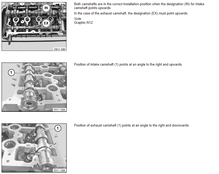

Here is how you know the cams are in the correct position:
Since you're locking the flywheel and checking the cam timing, are you in the process of replacing the timing chain? If so, I would lock the flywheel, remove the timing chain, move the cams into the correct spot, then install the cam holders. With the flywheel locked and the cams in place, the timing will be correct when buttoned up.

I just ordered ECS timing chain kit, valve cover gasket, along with crankshaft small hub. I was just unsure if I should replace the intake and exhaust VANOS sprockets?
I will be carefully rotating each cam clockwise into the correct lettering up position.
I appreciate the knowledge here. Thank you for the help.
