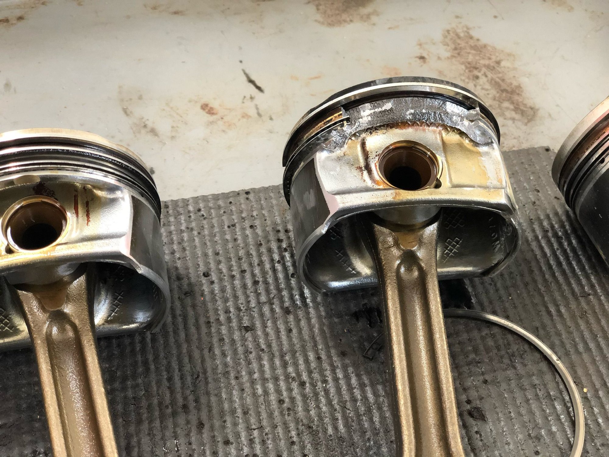

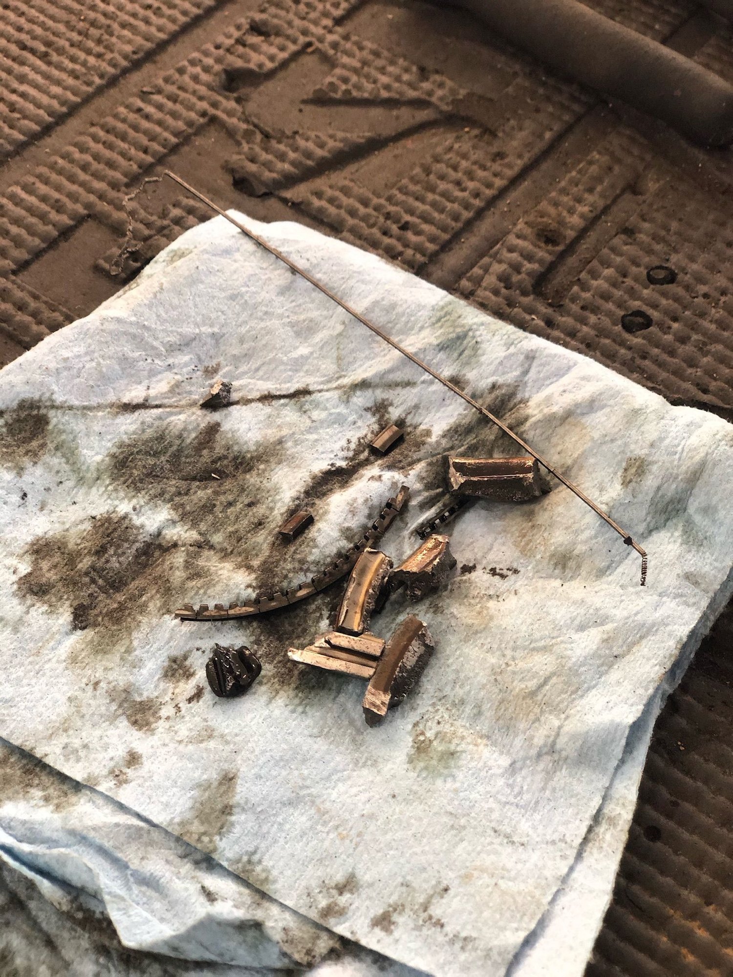

An update - Piston #3 lost part of its ring land on one side. I retrieved the bits when I pulled the pan. All others looked fine. The bores from top to bottom look good. I may have lucked out! I don’t see so much as a nick. The previous owner said it only ran 2 miles once it busted and smoked. I’m hoping to install new pistons and rings and hone the block without removing the engine. I’d like to keep her somewhat stock but with the tune installed I’d feel better with a forged piston. Anyone have a recommendation for a decent set of pistons?

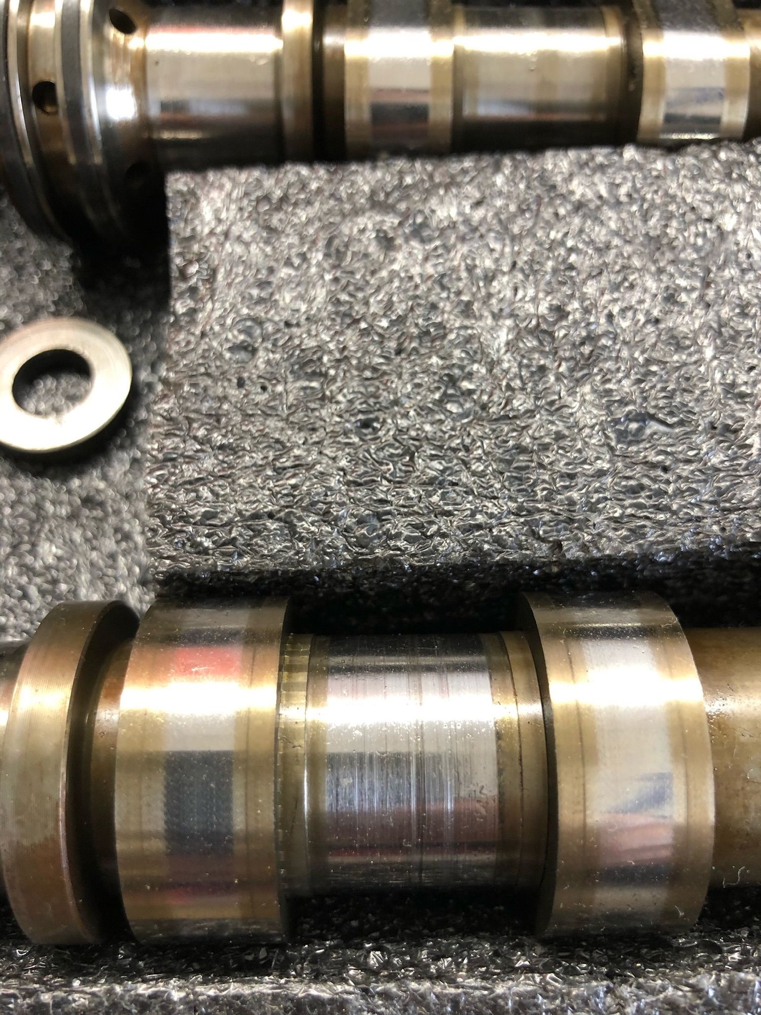

I removed the cams and noticed a couple of cam journals have some slight scratches.... the respective head journal surfaces have slight scratches as well. The previous owner had the combustion chambers walnut blasted and there are bits of walnut media EVERYWHERE!! They’re in all sorts of nooks and crannies!!! Wondering if they used too much media and too much air pressure when they blasted it?

My advice would be to measure the wear of your bores before dropping $700 or so on new pistons (not to mention TTY bolts, gaskets, etc. $$$). You mention your bores are smooth with no obvious damage, but I would be shocked if the bores are still round and straight. Piston to wall clearance will very likely not be correct. I have no personal experience with "just a rehone" and new pistons, but the piston to wall clearances are spec'd for a reason. It's really not a huge amount of additional labor to pull the engine and send it off to a machine shop for proper evaluation.
Also, for the record, my cam journals looked exactly like yours. I reinstalled them as is and haven't had any issues.

What are your expectations for life expectancy after the rebuild? (the motor's, not yours!) Is your goal to drive for another 120K? Or just get another 30K - 40K out of it? If it is the latter, I suggest you avoid spending new piston money and get one used piston and "hone" the bores with a flex tool of some sort. If it is the former, then bite the big one and pull the engine. I would also wonder if the #3 injector is partially plugged.....

Was just the #1 pair of cam journals grooved? Cam journals are usually very lightly loaded so it takes a lot of miles for wear like that to show up, and then you would expect more than just the #1 to show damage. Seems like some of the busted piston made its way past the filter. I would be inclined to knock off the high spots with some 400 grit paper. Inspect the journals in the head for embedded particles and remove.

So a first inspection - I didn't see any wear beyond what a 105k-mile car would have on the big-end bearings. The cams aren't in front of me right now but I believe the wear shows on the #1 and maybe #3 journal and cam surface. (Not tremendous wear but noticeable as the other surfaces are pretty dam good.) I thought about piston "bits" sneaking past the filter and pick-up screen and working their way around but I'm not sure how a piece would find its way between a journal and a cam surface....
You can see in the above pic the little bit of wear on the thrust-side of the piston skirt on 3.... They all have slight wear marks on that side which is kinda expected BUT it could be the bores are ovalized a little too much which I'm hoping a measurement will prove or disprove.
