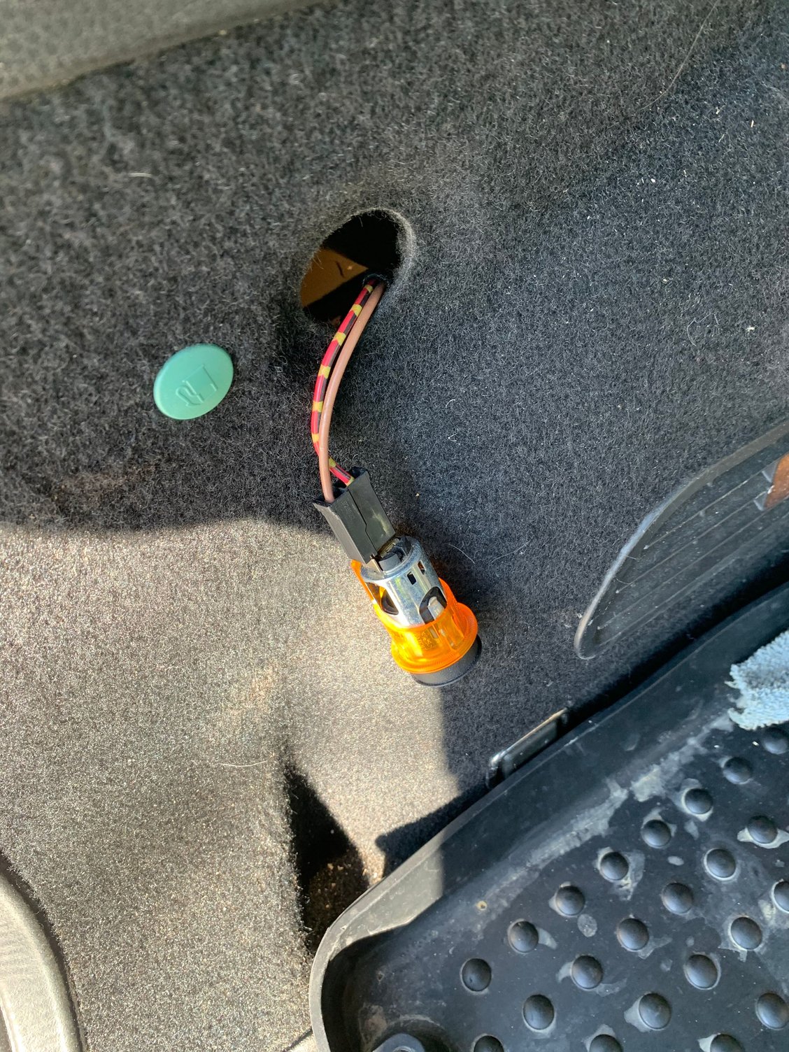

Mine is just hanging there. The hole in the trim piece is much bigger than the outside of the orange plastic thing that holds the power outlet. Since I bought the car used I don't know what goes there but I'm obviously missing something
Anyone have a photo or a part number so I know what I'm missing? Anyone have one?

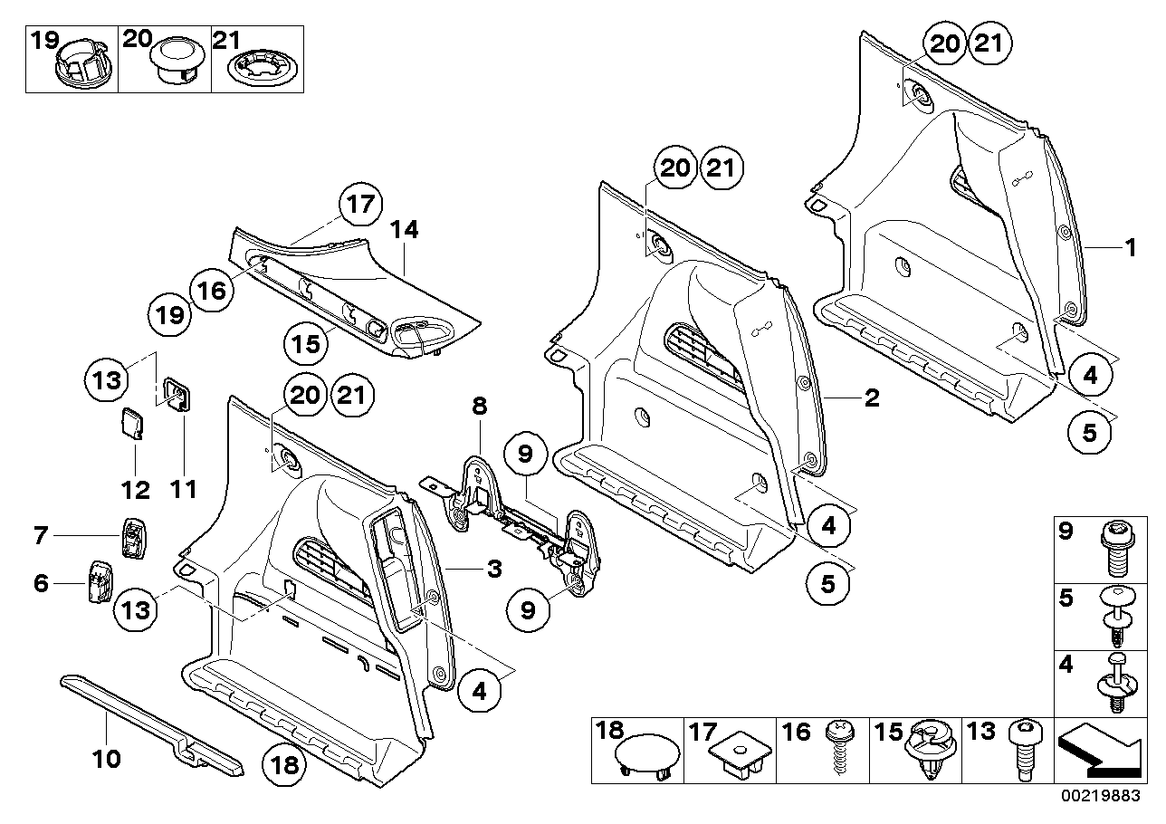

Looks like you might be missing this thing:
https://www.ecstuning.com/b-genuine-...t/51477252642/
#21 here:
https://www.realoem.com/bmw/enUS/sho...diagId=51_6837

it looks like I need both 20 and 21 from that drawing.

#20 is a blind plug for the socket
