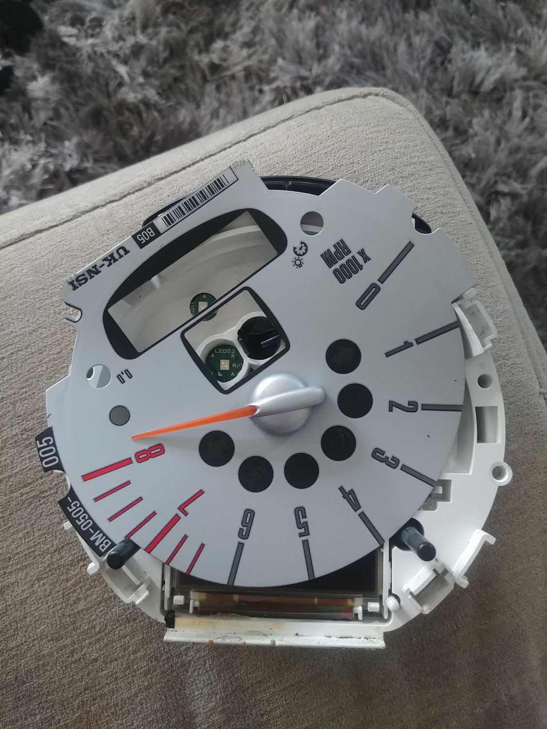

Opened and cleaned to remove roaches and excess electrical grease causing moisture.
Removed corroded led.

Rpm counter
