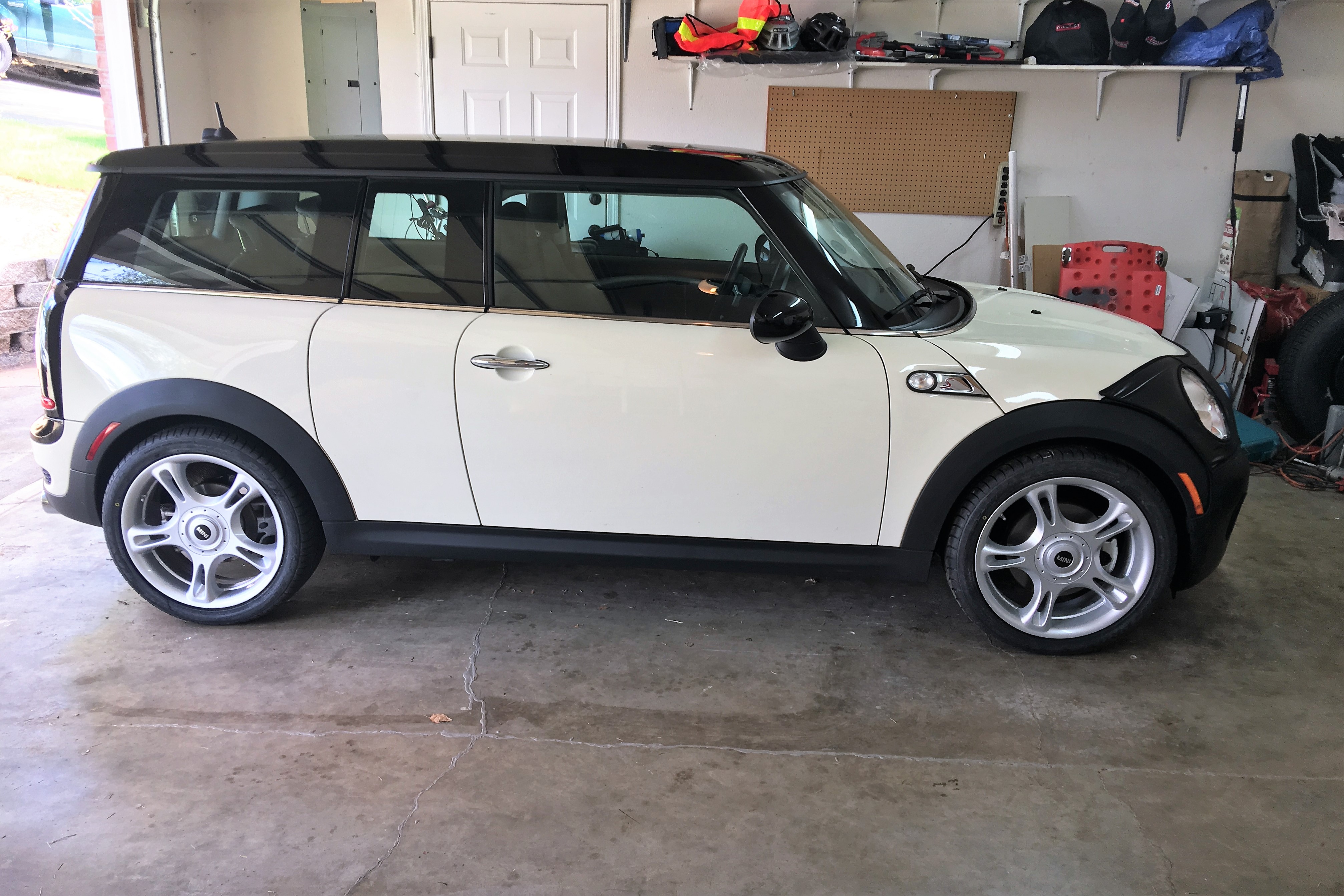

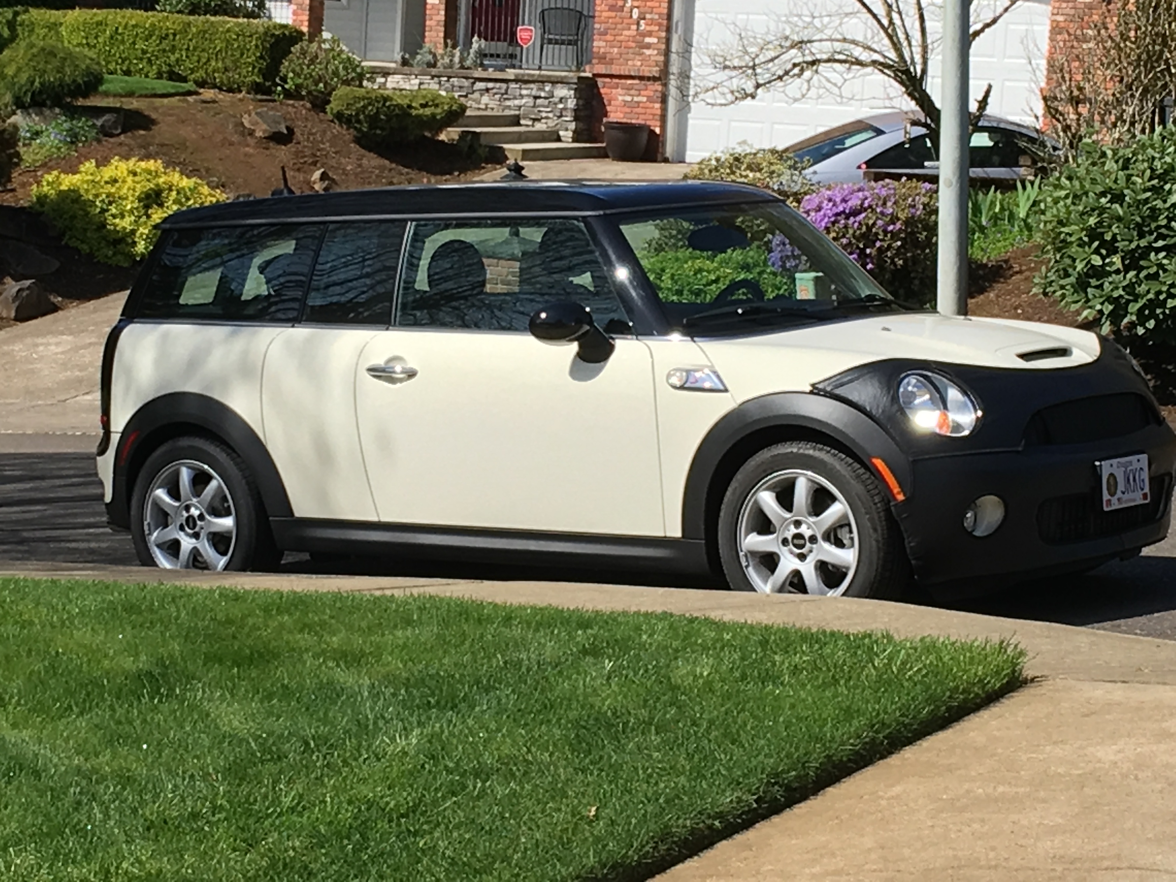

I have a 2010 Clubman S identical to yours...a friend passed away late last year and left it to my and I now have the adoption papers. It has less than 7000 original miles. I've done a couple of things to improve sound and performance and now it's time for suspension.

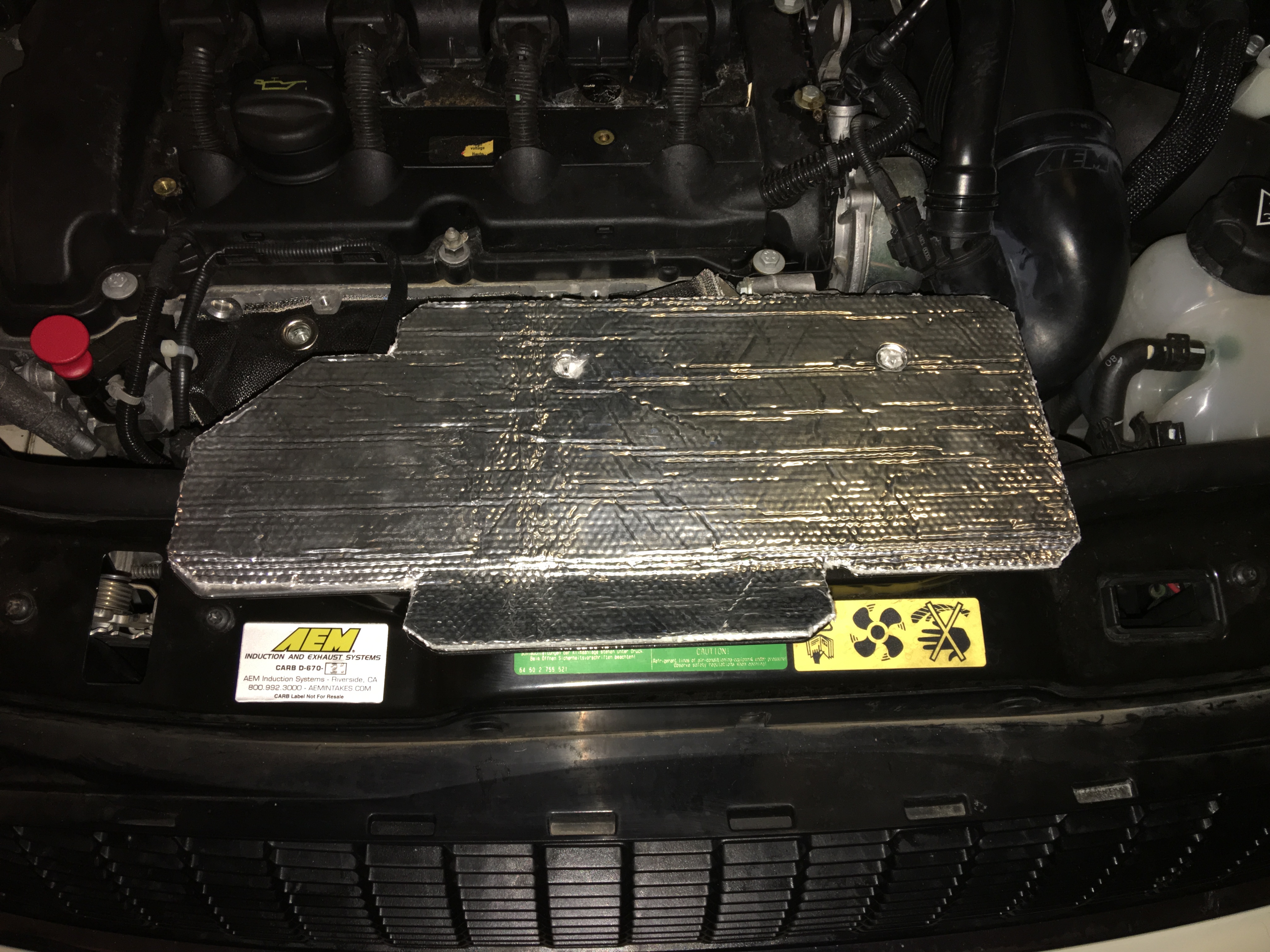

The AEM is ok and I did notice a seat of the pants change in performance so it had to be in the 5/10HP increase...I've been drag racing for some 40+ years and my derriere is a finely tuned tool...although I did to do some modifications.
I raised the powder coated shield up about 3/4" as I added a ceramic insulation under the shield, I also safety wired the bolts and the bolts are aircraft grade aluminum. I also got rid of the OE turbo shield which is almost useless and added an ALTA turbo blanket. The turbo blanket did seem to help a little in throttle response from the OE shield and does dissipates heat better also.
I have only driven one 250 mile cruise and the AEM intake attached to the hood did get pretty hot so I will also be using a heat shield on that. I also put the OE shield on the oil line from for the turbo and shielded that line close to the block.

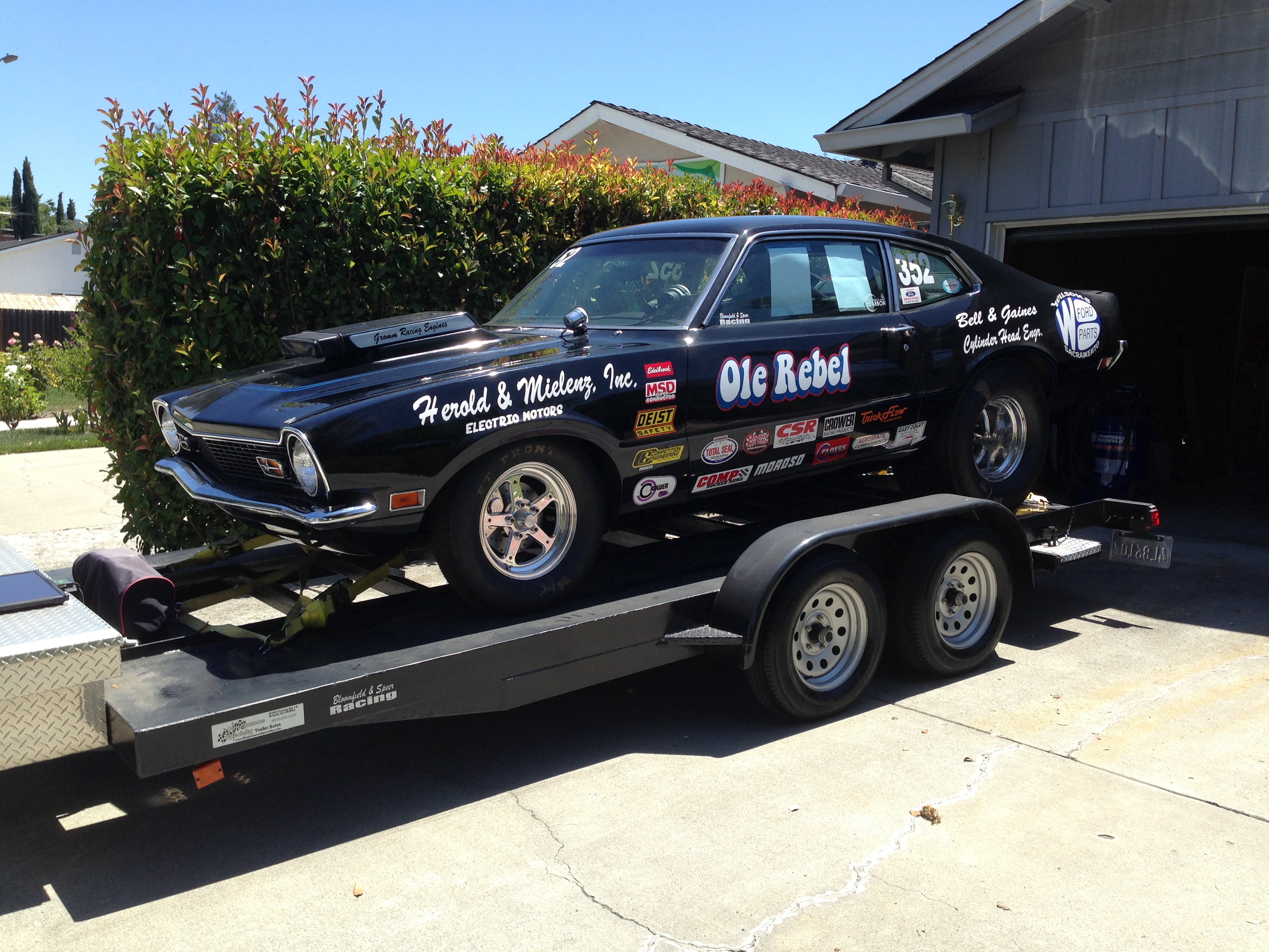

Picture of my last Drag Car...9.801 in the 1/4 @ 136
