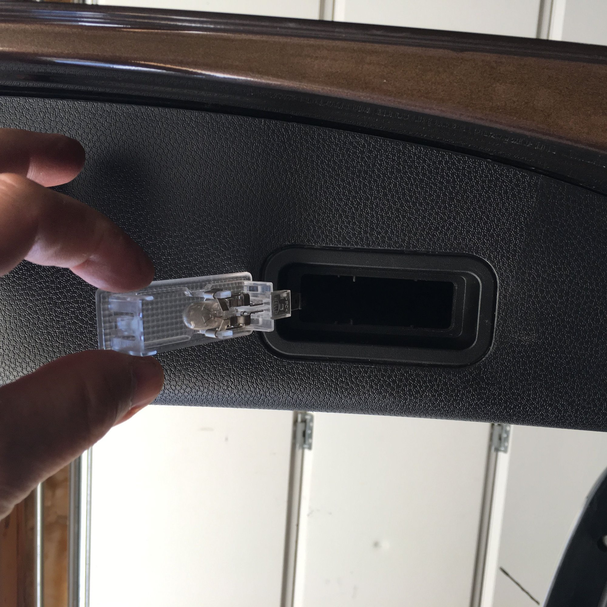

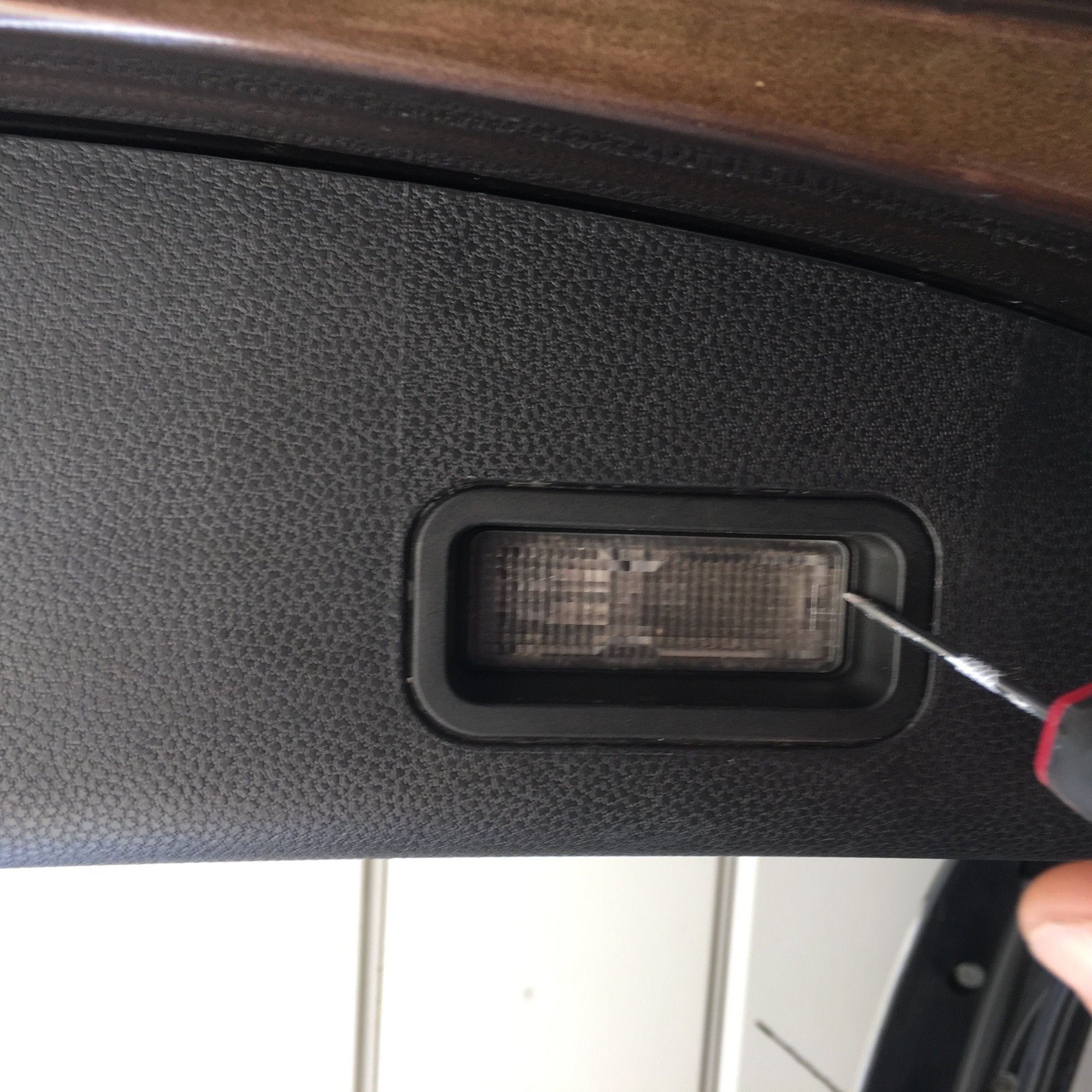

Super easy. They work exactly as the regular puddlenlights in the front doors. Just pry one end slightly. On my passenger side barn door, I pried on the end closest to the rear of the car when the door was open.
In these pics, the back of the car is to the right. I'm laying on my back looking up at the bottom of the door.
Looking up from below pass side barn door
Pry this end.
And there ya go.

Nice pics and description, thanks!
