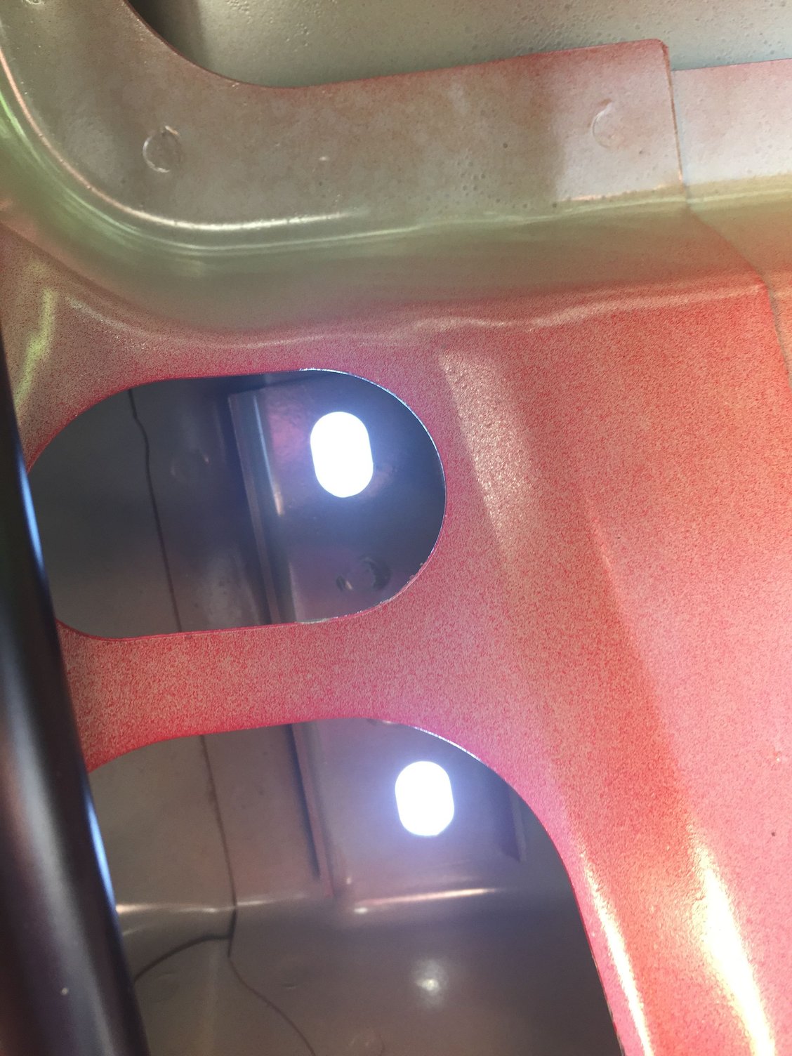

The first pic is looking from inside the car at the welded in braces from the factory. There are two slotted holes which I used as a template to drill through the roof. I used a drill that was the same size as the on in the hole saw.

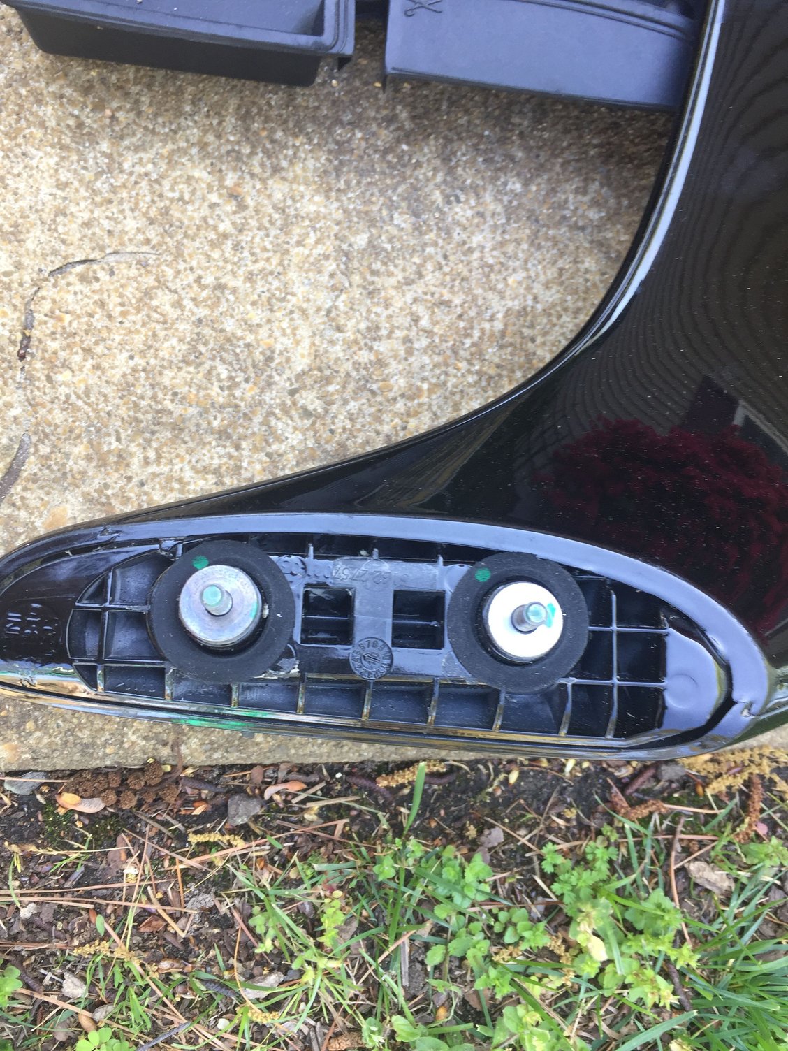

The third pic shows the underside of the spoiler with the expansion screws installed. The screws have a square end that gets installed in the spoiler boss (keeps them from turning when installing the flanged nuts inside the car. I also installed some silicone around the outside of the spoiler on each side.

Interesting, so it's like the R50/R53 roof rack set up.
