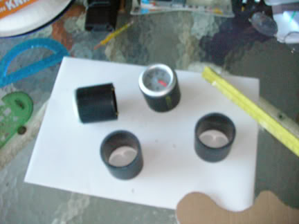

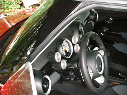

I made my own gage mount, out of 1/8" aluminum and 2" ABS pipe. I screwed it to the back of the tachometer, using an existing screw hole and a longer screw.

DneprDAVE- that's really great work. I may have to borrow from your idea for my gauges. I like the idea of making my own mounts, especially vs paying $120 for a mount setup. Thank you so very much for sharing your mounting solution.

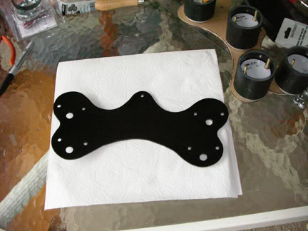

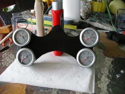

Custom gauge pods and mount.
I borrowed from Dave's idea above and made my own gauge pods and mount. I used 1/8" diabond (aluminum skinned ABS) and 2 1/4" ABS pipe.
Started as a 4 x 10 rectangle. Trimmed to this shape and filed smooth.
Mock-up...
Access for electrical access and lights for water temp gauge.
Access for light and boost line
Test fitting the pods and gauges.
Made a nice tidy wiring harness.
