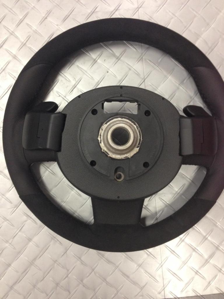

Do you have paddle shifters ?
https://www.northamericanmotoring.co...-shifters.html
If so you will have to mod the back of the wheel as most JCW thicker wheel are not notched for the paddles. If not paddle shifter and you already have the key pad button , then its a straight swap.
