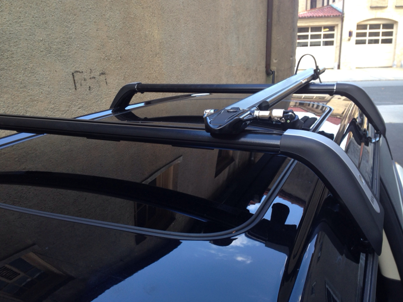

Finally installed! Thanks @ecs for the goods, and plasti dip for the paint. And that link with better install instructions...

Looks great

You are welcome. Came out good and looks great with the Rockymounts Nice set up.

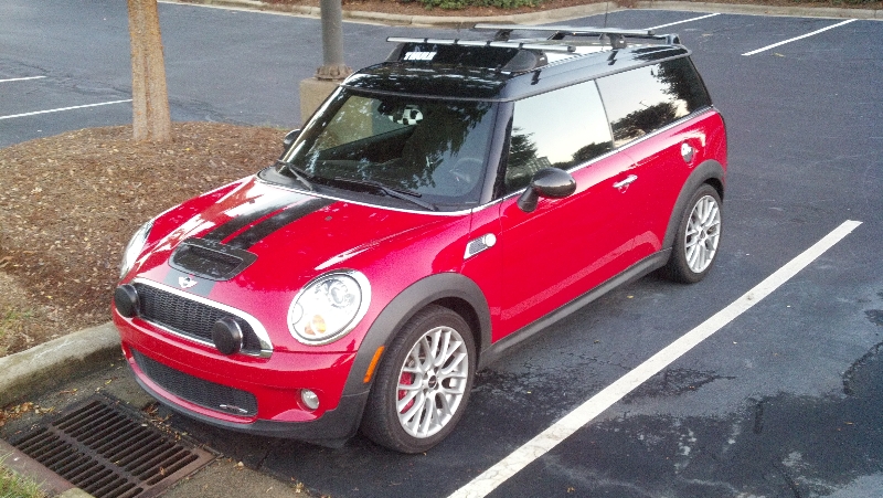

My wife, kids and I are big into mountain biking and cycling so we needed as much rack space on top of the Clubbie as we could get. So I installed a new track based Yakima/Thule rack a few days ago. Used Yakima 54" tracks with plus nuts, 53" Thule rapid aero bars, Thule 460r towers, Thule fit kit 3101, and a Thule fairing. This setup works well, very strong. The trakcs are bolted to the roof with seven plus nuts per side. I would not hesitate to put multiple kayaks or other heavy/large loads on this setup. Install was suprisingly easy also. The only custom work I had to do besides drilling the roof holes was to lengthen the mount channel on the bottom of the load bars by 4" on each side to accomodate the tower spread.
I did my rear brakes tonight, and tomorrow will be mounting up a bunch of Yakima Raptor bike racks to the bars. Thankfully, the long bars will fit four wide with room to spare.

Sounds pretty heavy duty. Got pics of this set up?

It is pretty strong. It was the strongest rack mounting method that I could come up with.
