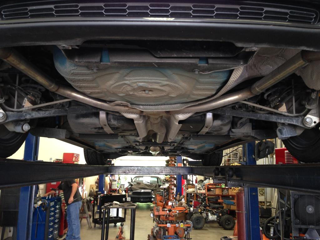

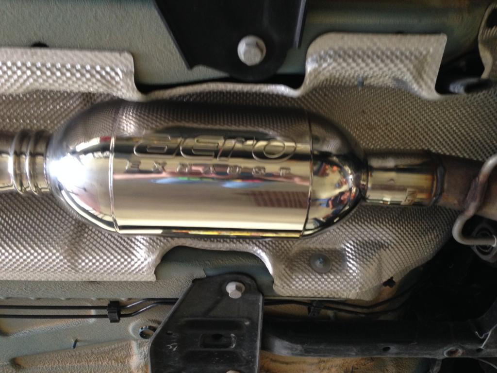

OK, I just installed the Aero Turbine, model AT2525 (2.5" in/out) . I removed the resonator and second cat and put the Aero Turbine muffler in it's place and removed both mufflers and replaced with straight pipe.
E6F0A-0306-4027-A03D-43485CF20151.jpg[/IMG]
I really like the sound, deeper, no popping or cracking, ie no ricey sound. At idle it's just a tad louder, but with the windows cracked and stereo down it sounds meaner especially when it gets above 3K . $87.99 for muffler and $190 for install it's sure worth the price. I can confirm my exhaust gas temps were lowered from a max of 1500F to 1300F so a plus for sure for the turbo life.
