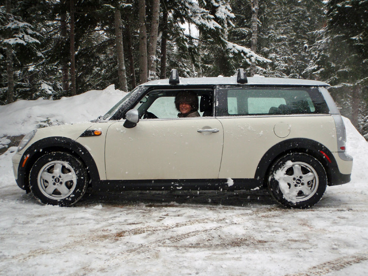

Very nice shoes, Pipra - and love your hat!
