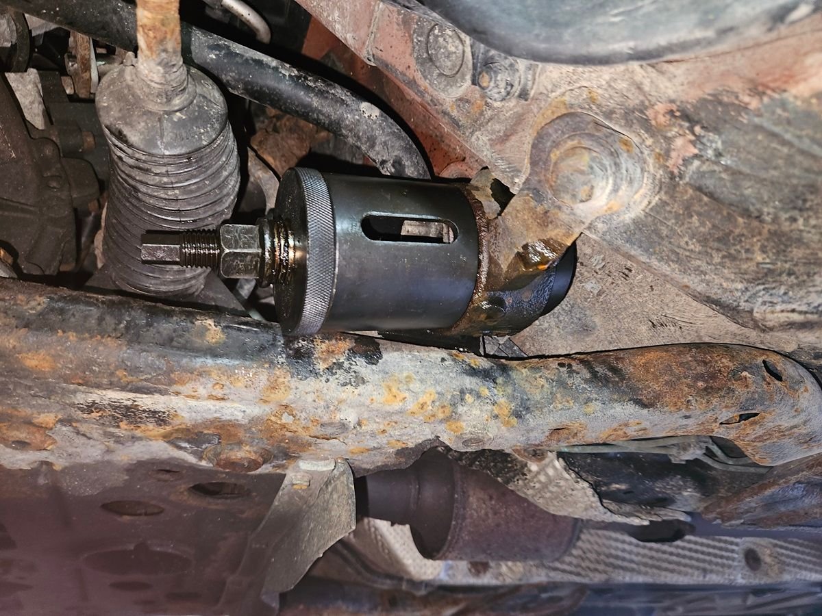

The first day was spent (unsuccessfully) trying to use the on-vehicle replacement method with
this tool this tool
. Mine came in the Red case, not the Blue case. From the reviews, it seems like there is a quality difference in the threaded bolt and nut between the two versions (with the Blue kit faring better), but I think my bushings were so stuck in their mounts that either kit would have had trouble completing both bushings on the vehicle.
Another issue with the Blue kit I received is that the fitting plates were not cut so that an installed bushing would seat evenly in the bracket - with an even amount of the bushing sleeve hanging out from each end of the bracket. Note the difference in the two halves of the installation plates in this image, and the plate on top would on on the back of the bushing bracket so it would never pull the bushing through to the correct "depth".
The other problem I faced before abandoning the on-vehicle bushing installation attempt was that I couldn't get enough force on a correct angle to re-insert the LCA post into the bushing. At that point, it was 1:30am, I decided to sleep on it and start fresh the next day. The installation tool's "bearing" (for between the nut and the plate) had broken apart by that point, too, and the threads were starting wear on the threaded rod (and I did keep the threads liberally greased - I just think 169k miles and 18yrs in the rust belt were not helping things, either). Clearly, the on-vehicle installation was not going to be the path forward.
