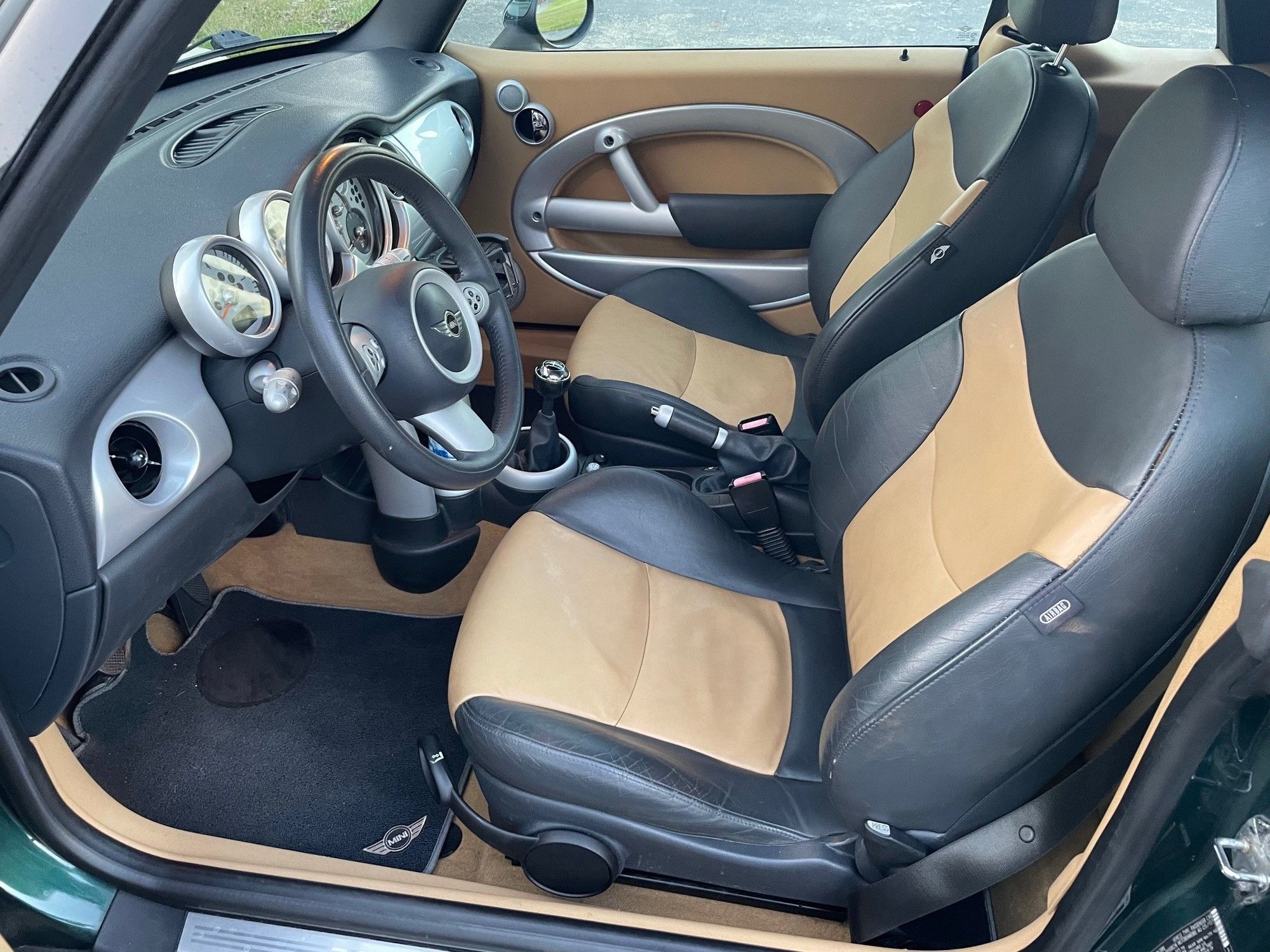

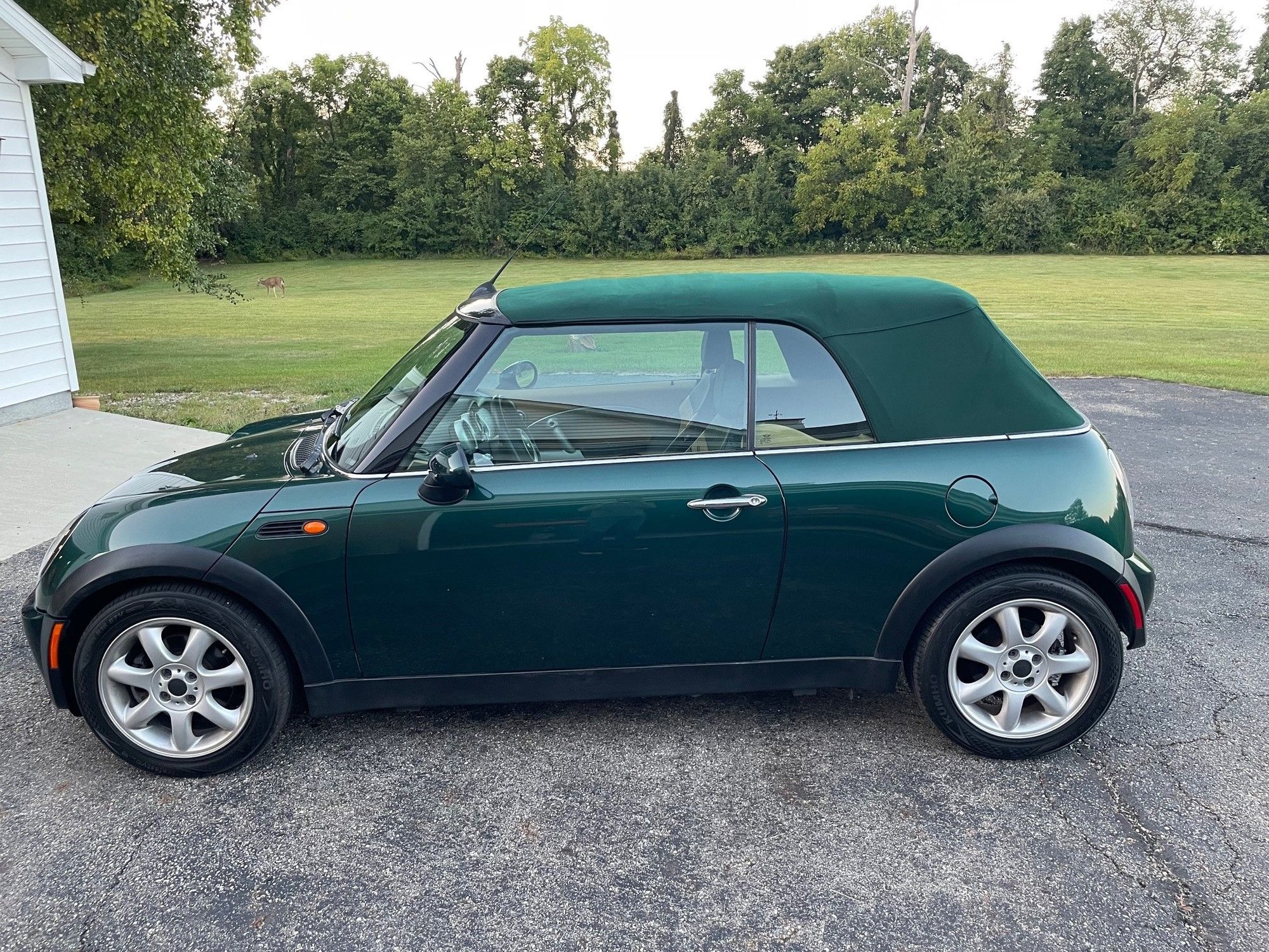

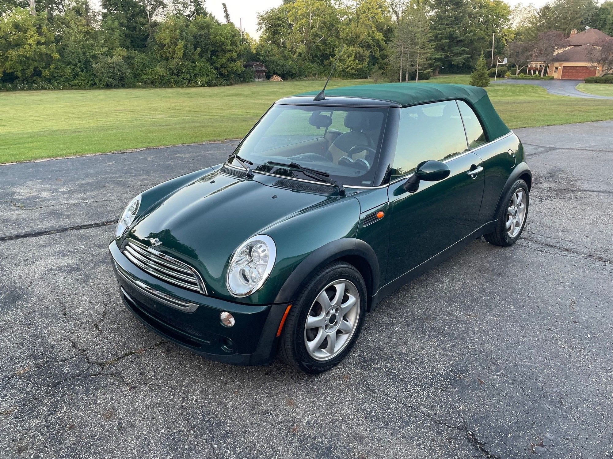

I bought a 2007 R52 with 11,200 miles.
I have a few questions.
It came with 2 keys, on one key the buttons do not work. Potentially the battery is dead, how long does it take to charge?
The radio does now work well is ECS Tuning the best place for a replacement radio?
What about speakers? I have the non HK radio.
How do you pair a Phone there is no Sync Button. Are those buttons worthless?
When the top is down the redlight on the top button keeps blinking.
Any specific things I should check?

After all that and still no pictures!
Welcome to the wonderful world topless MINI motoring.
Only four reasons I've found for running up the canvas.
1. It's raining
2. It's snowing
3. My co-pilot/navigator is whining about being to hot or cold.
4. Some guys throwing empty beer cans in the back seat and didn't invite me.
Topless motoring IS motoring at it's best.
And, two must have drophead care products: Raggtopp and Liquid Wrench dry lube for the scissor joints.
