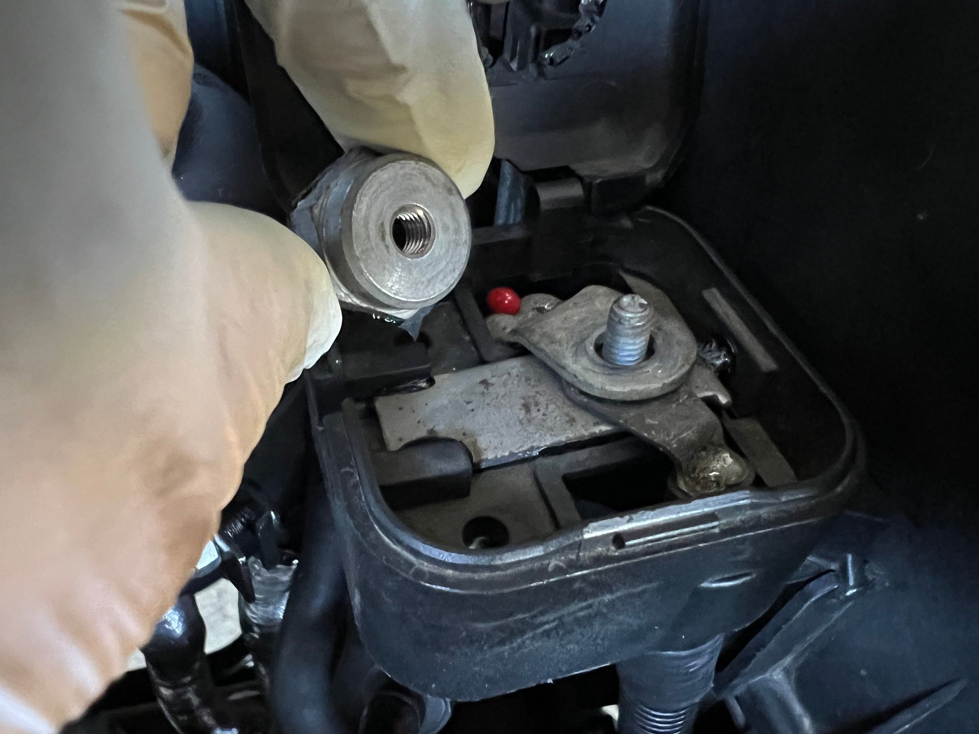

1. melted battery post box. I bought a new one, but want to figure out how it happened so I don't melt another. Battery sits at 12v and running it's charging at 14. Seems normal. There have been a number of body error codes, so I cleared them all and will see what comes back. Maybe that will give me a hint of where a short might be? Also to note that I have had other weird electrical symptoms - wipers coming on randomly, lights staying on. Maybe related?

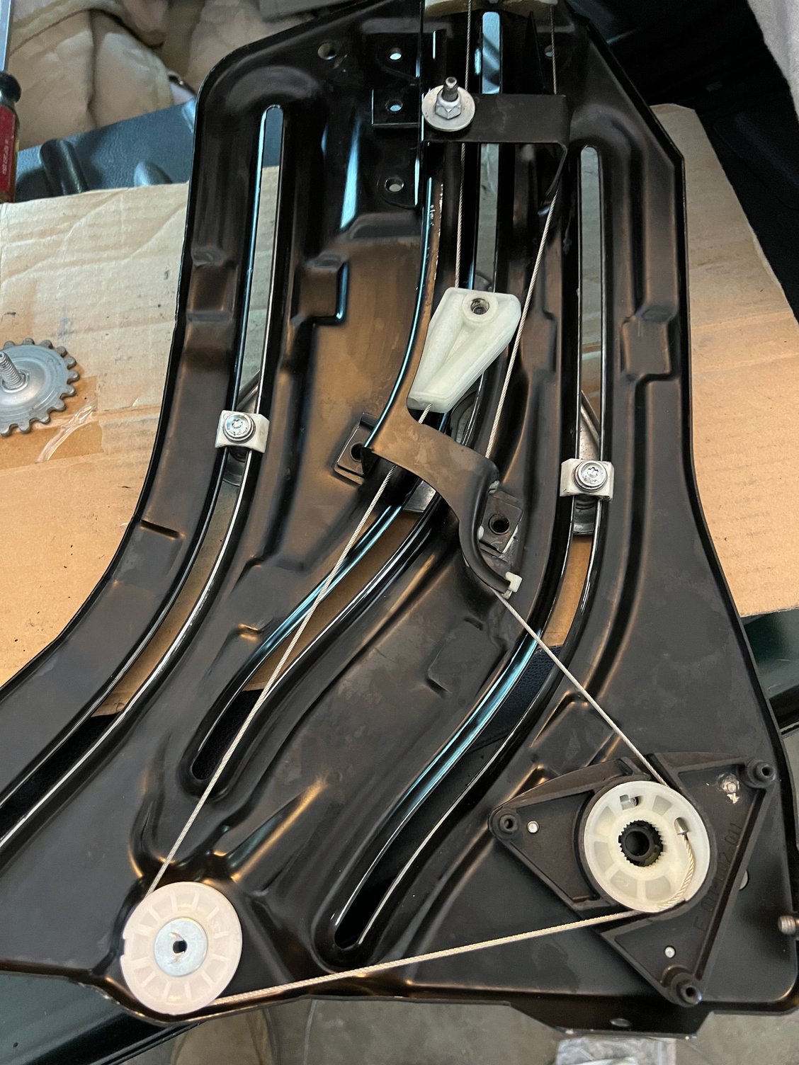

2. Drivers side rear window isn't working right. Today I pulled the regulator and found the cable had jumped one of the rollers and was getting pinched at the motor. I was able to put the cable back how it should be and put it back in. A quick test resulted in still weird grinding. Pulled it again and the cable seemed to migrate to getting pinched again between the motor and the cable feed area. That just doesn't seem right to me. But what is the real problem and solution (preferably without buying a new expensive regulator assembly)? Can anyone spot an obvious issue and solution here?

More on Item #1 - melted positive terminal box. I'm kicking myself now. While I had everything apart, I could have removed the starter easily and refurbished it. With the couple of suggestions about it, I'm thinking that must be where the problem is. Nothing else would pull that much current at that location to cause that much heat build-up. I still don't think it's the actual starter motor itself - it always seems to work fine. But I have had intermittent turns of the key with no engagement of the starter. I thought it was the ignition switch, but that sure seemed fine when I pulled it apart. My top guess is the starter solenoid. In my 35 years of car ownership, I've certainly seen my share of bad starter solenoids. Next guess is grounding or wire connections either at the terminal post or at the starter.
I did specifically look at the wires and connections at the starter when I was under the car and everything looked ok. So why might there have been heat build-up just at the terminal post and not everywhere along the line enough to melt the cable insulation, etc.? Maybe my second guess of a bad connection at the terminal post (if current is flowing through) is rising higher than my top guess of the solenoid. If there is too much resistance at that location, it would cause heat build up. It could also restrict the amount of current needed to actuate the starter solenoid and cause the random no start issues I had. Hmm... maybe I can find time today to at least pull that apart and see what I find.

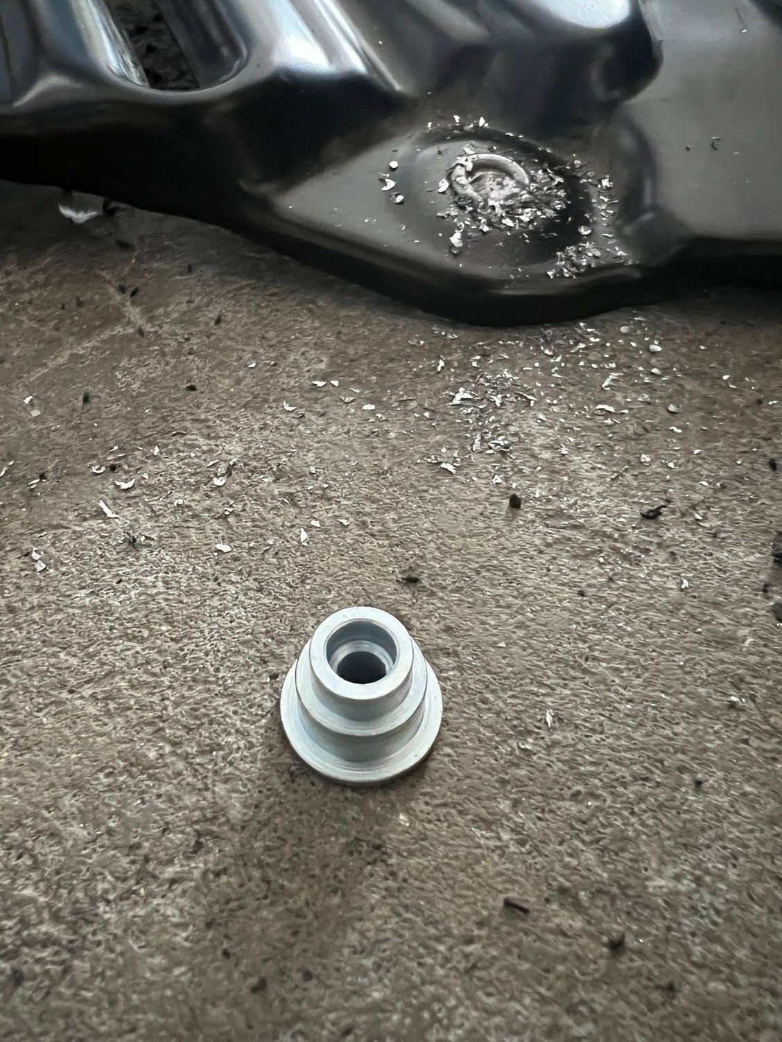

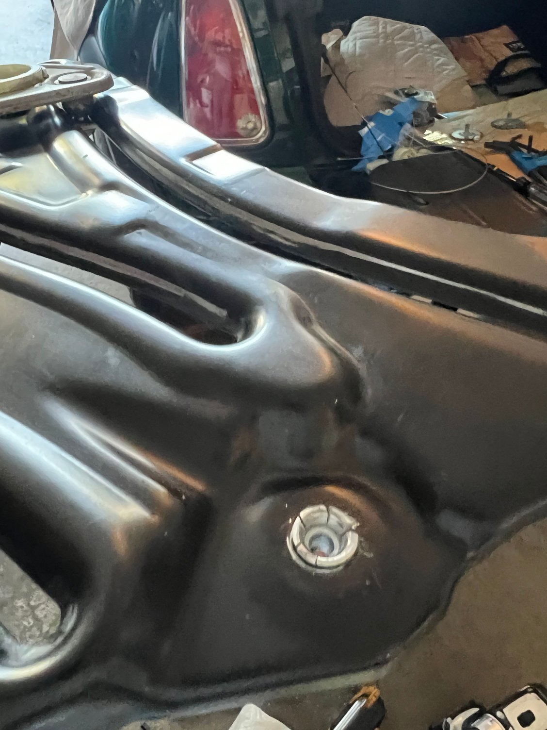

I figured out the window problem. The roller that is often seen blue or green was broken. So I bought a repair kit. No problem? Ha. I drilled out the old aluminum post. I can’t, for the life of me, manage to peen the end of the new one over the hole in the regulator. Argh! Any suggestions welcome, or I may just take it to a local machine shop to see what they can do.

Voila! The guy at the local machine shop took it to a press, no charge. There’s no way I could have done it without a press. In fact, it split the hard aluminum instead of mushrooming, which makes sense to me. Seemed pretty solid still. Good to go! It’s now the best operating window on the car.

Tackling the melted positive terminal post box. I took the connectors apart and didn’t find shiny metal - there was probably a bit of oxidation and the nut unscrewed pretty easily so not on tight. Maybe this was all enough to heat things up right there. I sprayed it with contact cleaner and scrubbed as well as I could get in there with a metal brush. Coated it with dielectric grease and put it back. Fingers crossed.

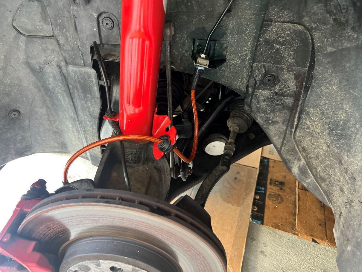

I ordered new (orange) stainless brake lines thinking I could just pull the lines and flush directly out the hardlines at each wheel (they didn't seem to be able to be bled at the bleeder screw - not much came out with the pedal or with the vacuum type bleeder. Well, even trying to bleed with the flexible lines removed, no much or no fluid would come out the rears or the right front. Oddly, it seemed to best come out the left front.(the one that was sticking). The right front was absolutely bone dry when I disconnected it. Since it's so close, I disconnected it at the ABS/DSC block and it was totally dry there. I blew air compressor air through that line and it wasn't blocked nor was there much fluid in it.

Pretty new orange stainless braided flex brake lines.
