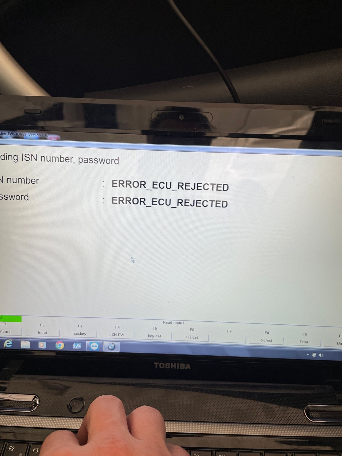

certainly that is my issue, this is me looking into the immobilizer with INPA. it HAS to be a comm issue between dme and ews, right?
Old Apr 7, 2022 | 04:39 PM
  #27
dearchristopher's Avatar
dearchristopher
Joined: Apr 2022
Posts: 35
Likes: 18
when looking at ecu via r50 > engine > EMS2K > immobilization seed
i get
immobilization seed
1. ERROR - ECU REJECTED
2. ERROR - QUERY OUT OF RANGE (translated from german)
what does “immobilization seed” do? i can learn it, or reset it

INPA did not get me on my way. i only have the options of
ENGINE > reset immobiliser seed & learn immobiliser seed (reset works now, learn does not)
IMMOBILISER > writing ISN number (this screen seemingly does nothing. i can’t make it confirm anything or error, or really do anything at all.
im hoping an install of ISTA will be the way i get past this. shrevrmini helped me get ISTA tonight, but the install isn’t wanting to work correctly.
im relieved that this is a normal EWS issue now that the car cranks. i just can’t tell where to go from here

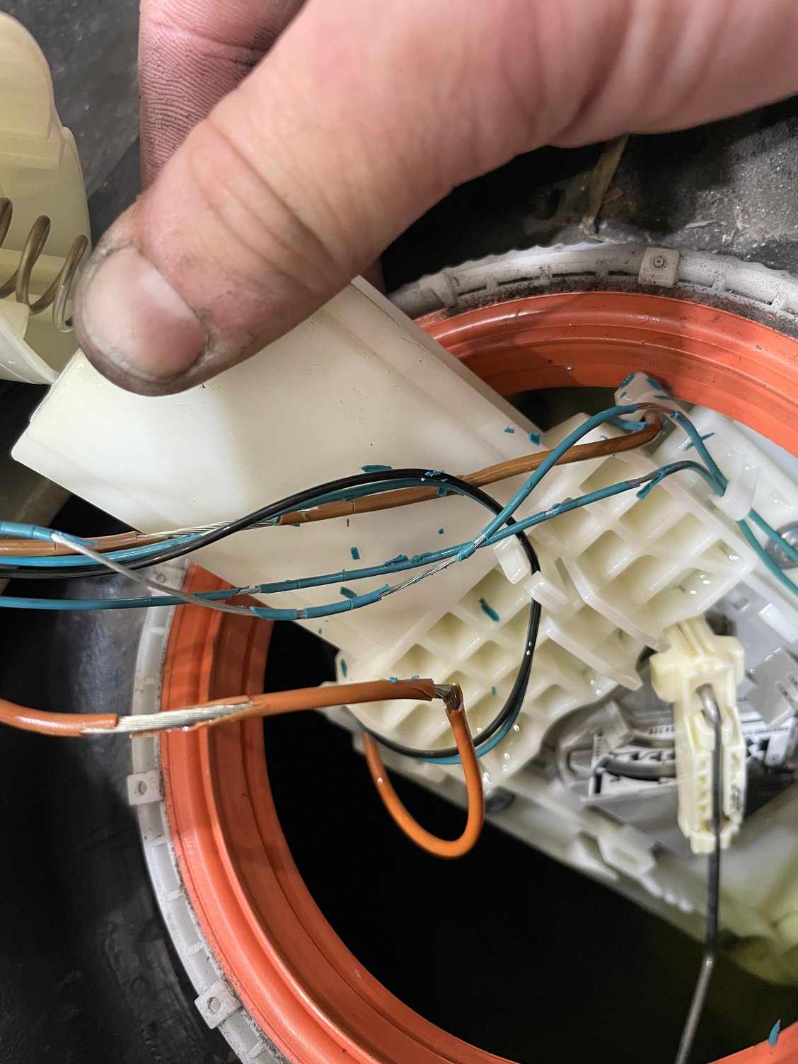

well i managed to confirm that i don’t have an ews issue anymore. the car will start and run on ether so i know i have spark. i replaced o rings in fuel filter side today, and decided to pull fuel pump and look at it. turns out the fuel had eaten through the plastic hose. broke the rest of the way when i opened it to take a peek.
going to try and source a fuel pump tomorrow, but i’ll likely be ordering and waiting.

Wow, bare wire insulation + fuel vapors = "Ach, Scheiße"!
Old Apr 9, 2022 | 09:13 PM
that gave me a good laugh. don't you love it? my only guess is ethanol ate it all up.
i have another pump on order, should be here tuesday. i am so ready to drive this car.
