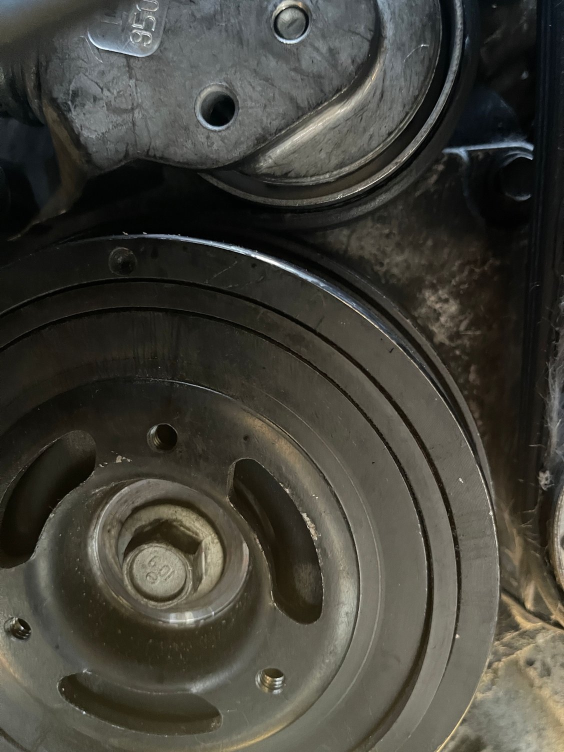

I went to install the new belt and the idler pulley is trashed, I'm pretty sure that's what is eating the belt. So didn't get that done, I have a new pulley on order.

Here is part of the drive belt
Looks like the dampener is coming apart.
I ordered a new dampener and front main seal.
