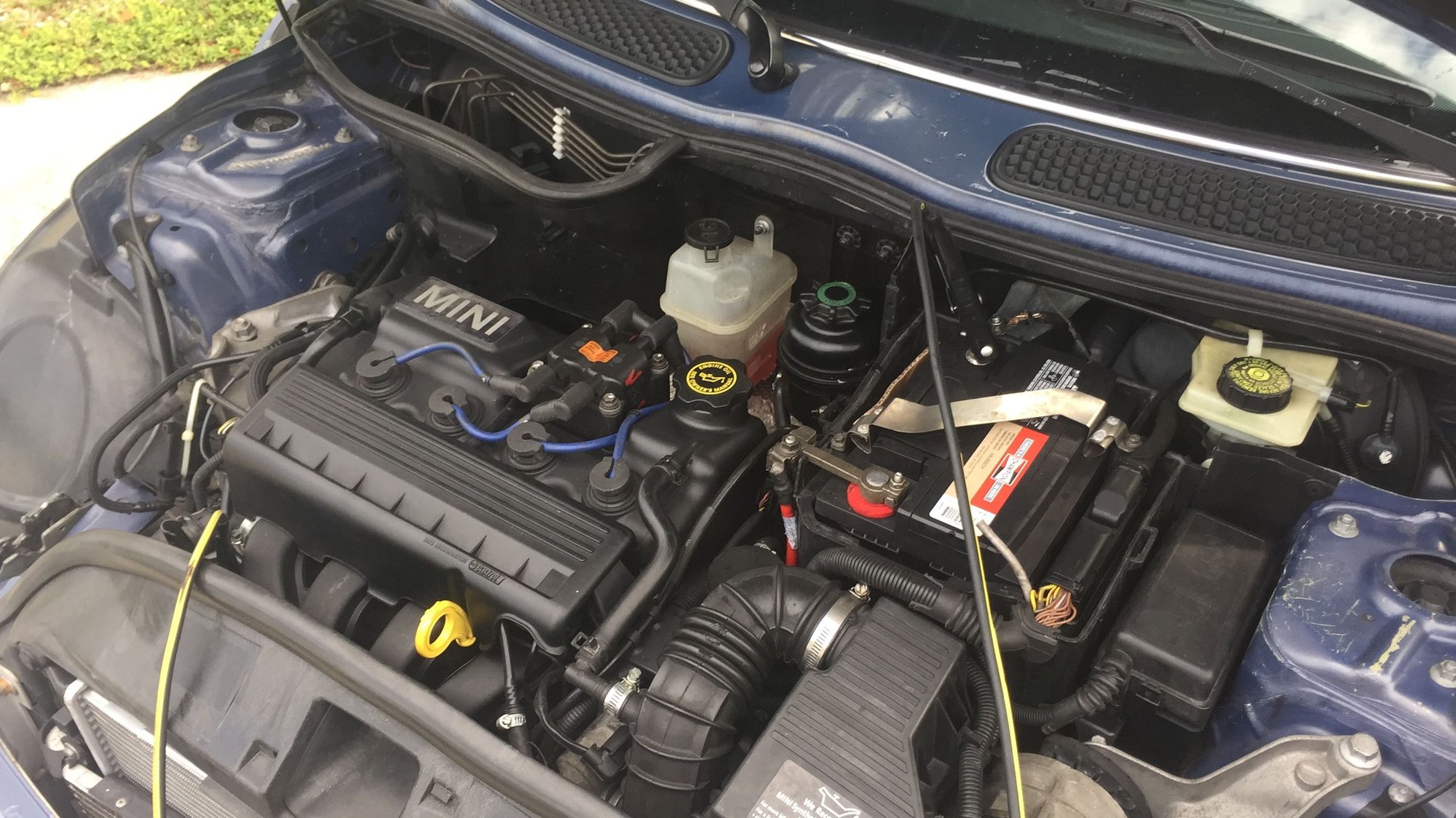

it seems that the problem with my mini no starting it was due to bad chassis ground.
so I think replacing the starter it was a waste of money!
because with the new starter the problem persist on/off.
i even disconnected the after market alarm and it kept doing no starting.
so thanks to you tube I learned to diagnostic a bad chassis ground connection by using a jump cable from negative battery post to a good know ground on the engine I used the alternator as ground the chassis and the car started right up.
i clean the passenger side ground to chassis with a grinder and apply dialectic grease so it would not happen again!
remain to be seen if the camshaft sensor error keeps popping up hopefully not!
Cleaned and lubed
Jump cable from negative battery post to alternator
