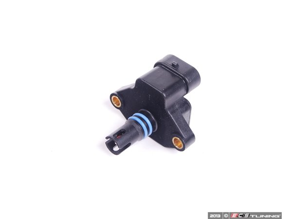

Here is the TMAP sensor near : (manifold) map is near the manifold
#9 http://www.ecstuning.com/Search/SiteSearch/12140872679/
and the MAP (above t-stat)
http://www.ecstuning.com/Search/SiteSearch/12140872648/

I have pulled both the MAP and TMAP to see if they had any obvious damage. The one on the front of the engine had a lot of oil on it. I cleaned it but it didn't make any difference. Will continue with leak checks.
