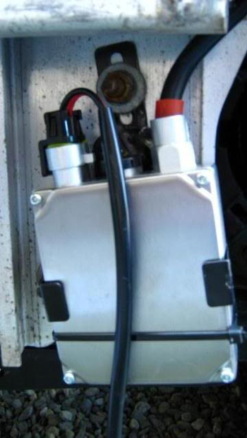

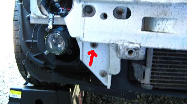

It is plug and play.
I removed front bumper, mounted using OEM bolt.
