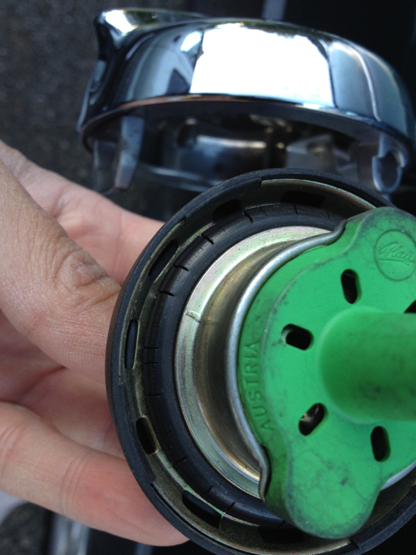

Btw when I bought my car the CEL came on after a 1,000 miles. I tightened the gas cap and reset the code because it was a very small leak evap code...and it went away for 4,000 more miles. Reset return in a few miles...when I inspected the gas cap this is what I saw...the seal around cap is cracked every 1/2". New gas cap ordered from Bavarian auto...no return of CEL for a few months now.
Attached Thumbnails Check Engine Light on, off, on, off...-image-1081551632.jpg
