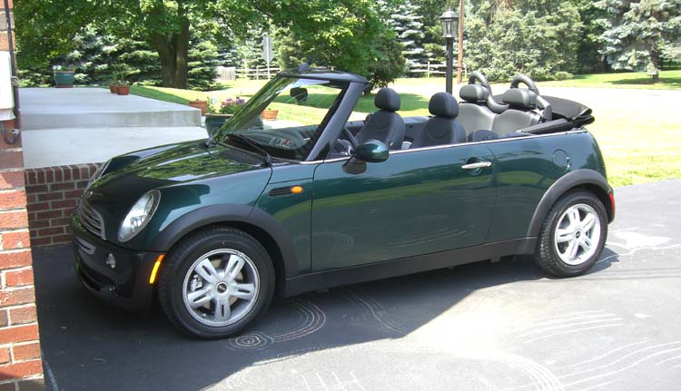

Pictures of the Unit and of my car are below... Thanks for any help.
Vince
