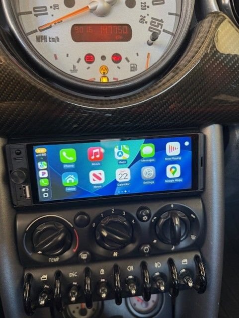

For those of you wanting to upgrade your factory stereo (non-HarmonKarden) I've attached an extremely helpful video. I now have Bluetooth-enabled music, maps, telephone/microphone, etc. (see pic, I used the same unit but did not install the backup camera ... maybe another day). Installation was pretty easy even for someone who's color-blind like me (wiring can be a challenge) and only cost me around $75 total ($50 for the unit and another $25 for faceplate/antenna converter/plug converter) and a couple hours of labor. And it fits so well that it looks factory.

looks good. cant beat that price.
will it run your obd scanner software / display?

Interestingly, it pulls up my OBD Fusion app, not the Dash Command app (doesn't appear on the touchscreen) that I prefer. It details speed, RPMs, coolant temp and trip info but that's all. I installed it primarily for music and telephone. I have the original six speakers plus a sub-woofer and the stereo sounds great. The small microphone is contained within a foam cover and filters outside noise really well during a call (exhaust for instance). I may or may not hook up the rearview camera. With a single din screen the view is not very large but you'll notice on the video I attached that it appears to be adequate. Honestly, the camera doesn't make much sense to me on such a small car with large windows and major sitelines. Overall, I'm super pleased with the result, especially for the small $$$ outlay. Quality seems fine but I'll gauge that in another 12 months if it's still functional.

Clean setup on the stereo; what brand is this unit?

It's listed on Amazon as "Bigorq" (see the link above) but it's marketed under multiple brand names. I was looking for inexpensive and found it in this unit. I will say, though, that I'm impressed by the quality for such a low price. If this one craps out within a year I'll just buy another one. It would end up costing me $4/month.
