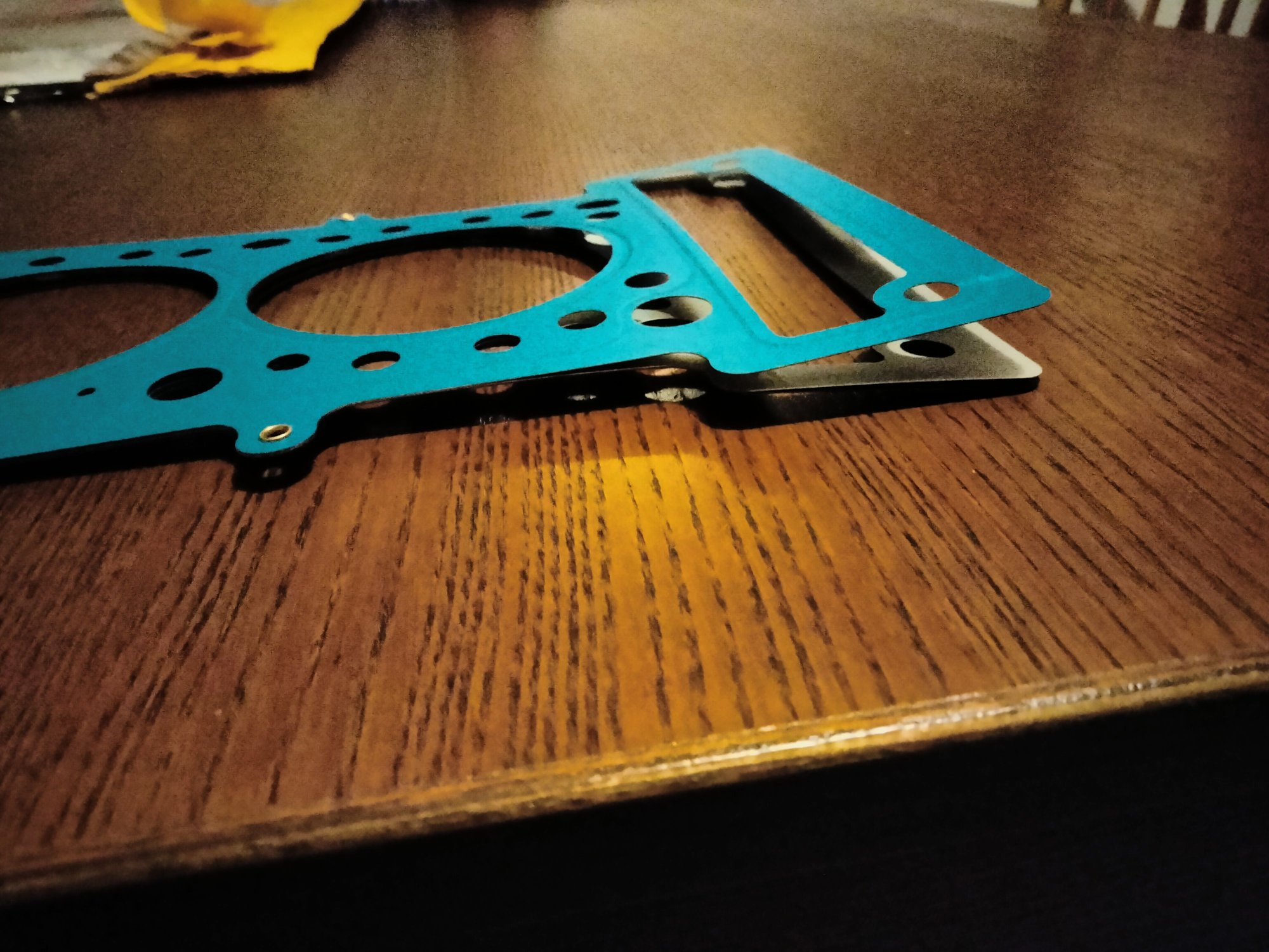

so the new felpro head gasket came and it's kinda tweaked. it wasn't even shipped in a box! i dont know if it will flatten out on the car or if i should return it
WTH???
'Seems to me that you don't really have any immediate need for the car right now(?)
After all you've been through - I'd say return it and try another vendor.
Totally unacceptable, what you received.

It's a huge bummer when you receive damaged gaskets due to poor packaging. It's happened to me before, too. Slightly bent is one thing, but that looks like the layers have separated....

yeah. i am returning it. it has to lay flat. the nubs on the block aren't very tall. even the previous gasket was a little bent. i have received a lot of bad stuff lately and returning a lot of it. shipping quality has really gone downhill. ordered a mahle .95mm gasket from autozone where i can go and look at it before i take it home. it's $100 but this is such a critical piece.
