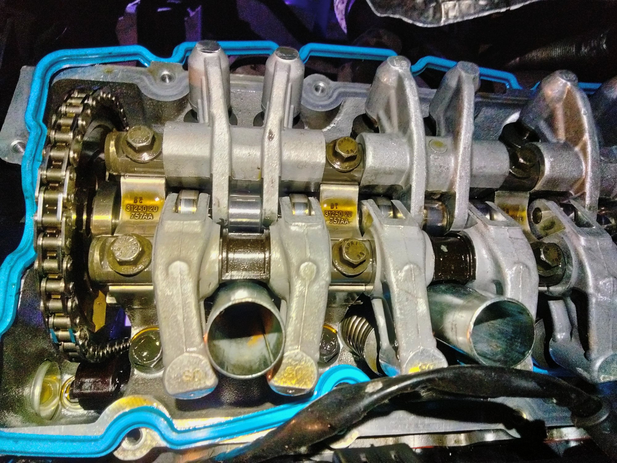

more bad news. i drained the oil and looking at it in a jar it looks like chocolate milk. i think my gasket already failed.

i might be castastrophizing. maybe it's just what oil looks like when mixed with assembly lube (i was liberal with that)

hard to tell in pics but looks fine to me

just did a compression test. cylinder 1 is reading zero! ive never seen that. i checked the other three cylinders and got readings around 160 but nothing for number one. that explains a lot. maybe one of the new valves broke, maybe the new gasket blew. all four of the new plugs are badly fouled already as well. decision time.
1. pull the head again and look
2. sell for parts
3. donate to local public radio and get a tax receipt
i guess since it's not running might as well pull the head off again

cylinder head off again. it took about 2 hours. the head gasket was all wet...so my suspicion of coolant in the oil was correct. the valves look a bit charred but seated. i will check the head and block again for flatness etc. i ordered new blots and gasket from felpro. the felpro gasket says "for imperfect surfaces". i am wondering if the bolts i used were maybe at fault. could they have been bottoming out? how do you clean out the bolt holes? i tried as best i could but this time i might try harder. i will also compare the new bolts to the original ones.
