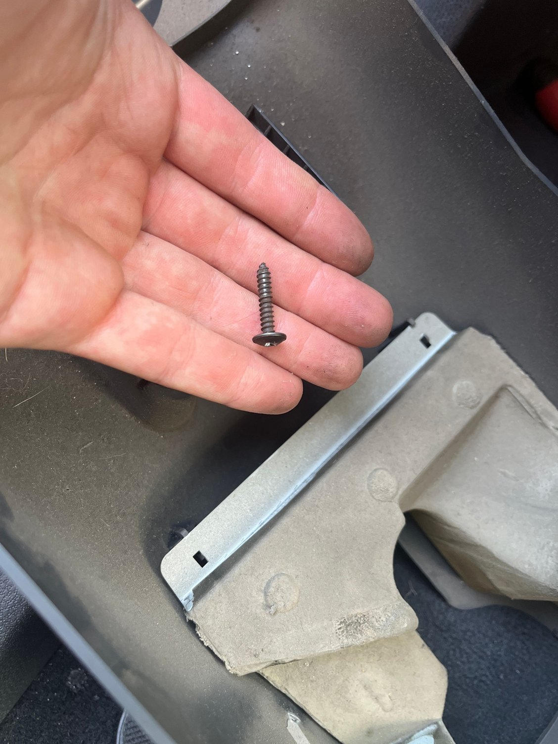

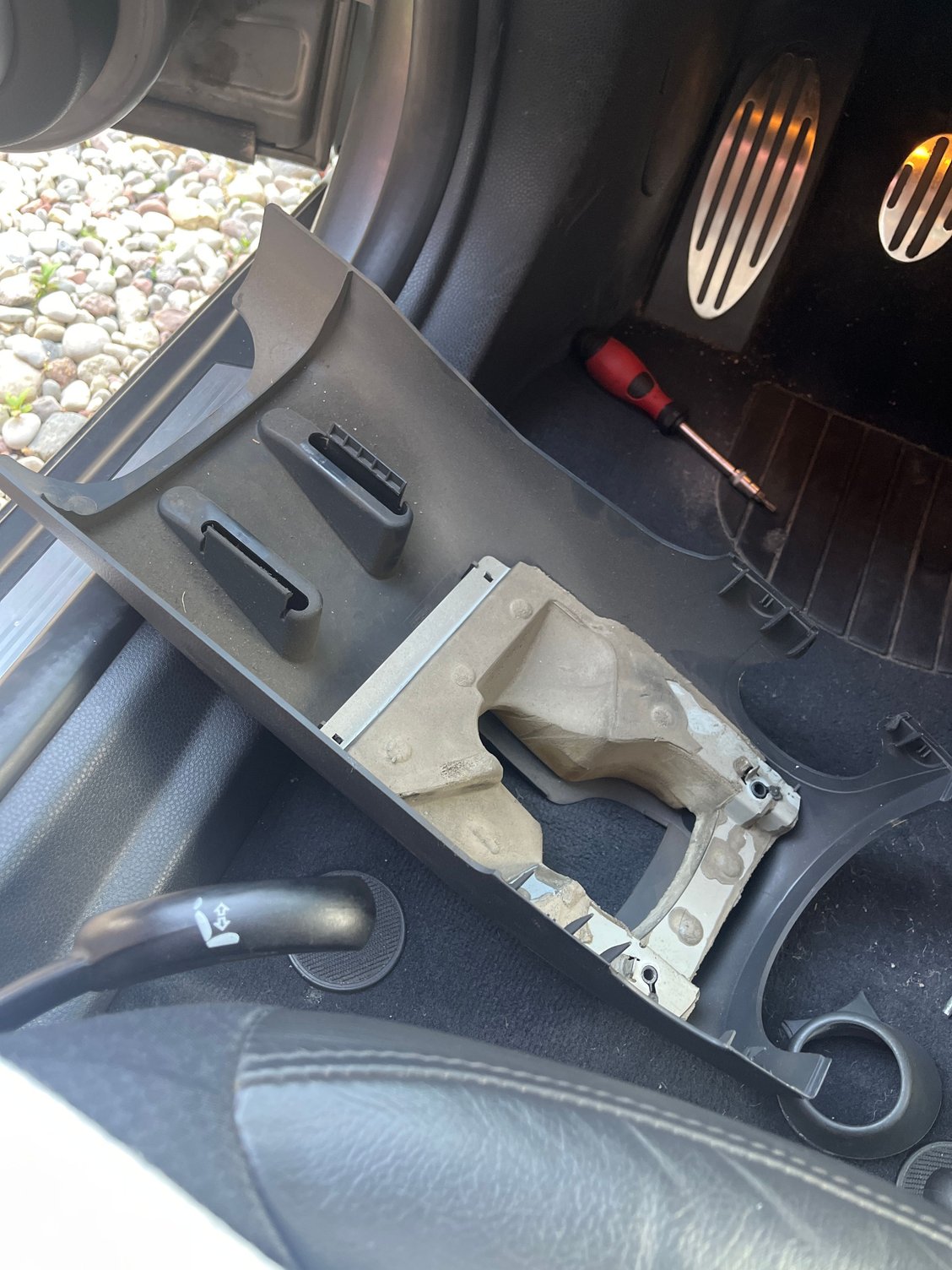

Update on the rattling noise (that sounded like a screw. Apparently it was a screw. Just removed the steering shaft cover on right below the steeringn wheel and found this screw. Picture below. Does anyone know where it might have come from?
