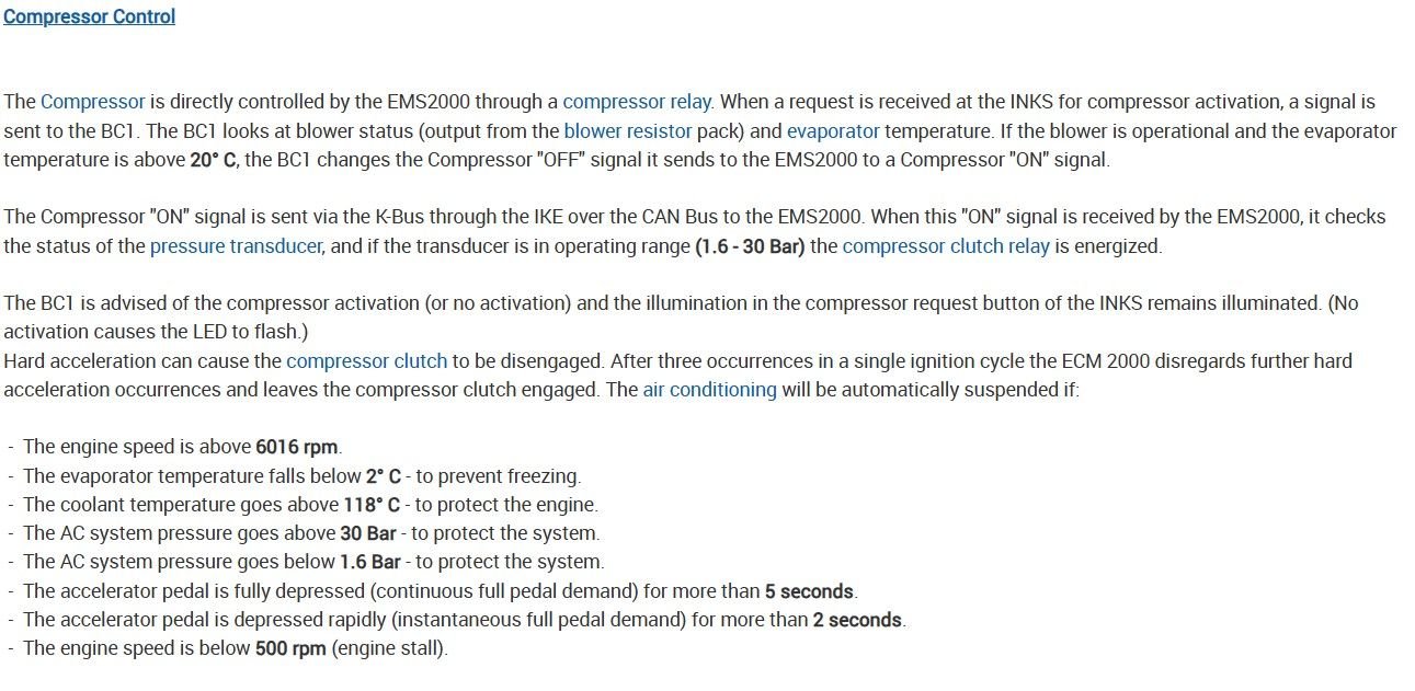

Looking at the schematic for the R53 MCS, I see an ambient temp sensor, coolant temp sensor, and evap temp sensor. All of these are inputs the DME and the DME control power to the AC compressor via the relay. There is also a AC high-side pressure sensor. If the evap temp or AC high-side pressure is below the set point, the DME won't energize the relay; if the coolant temp is too high, the DME will deenergize the relay and there will be no power to the compressor clutch coil. I'm not sure if the DME requires the ambient temp sensor input on the Gen1 for the Compressor to work ... I'll need to read up.

Oh, look what I found.
