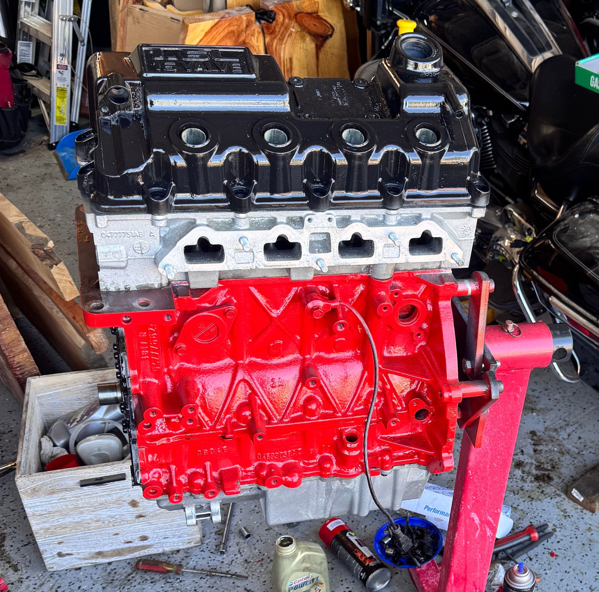

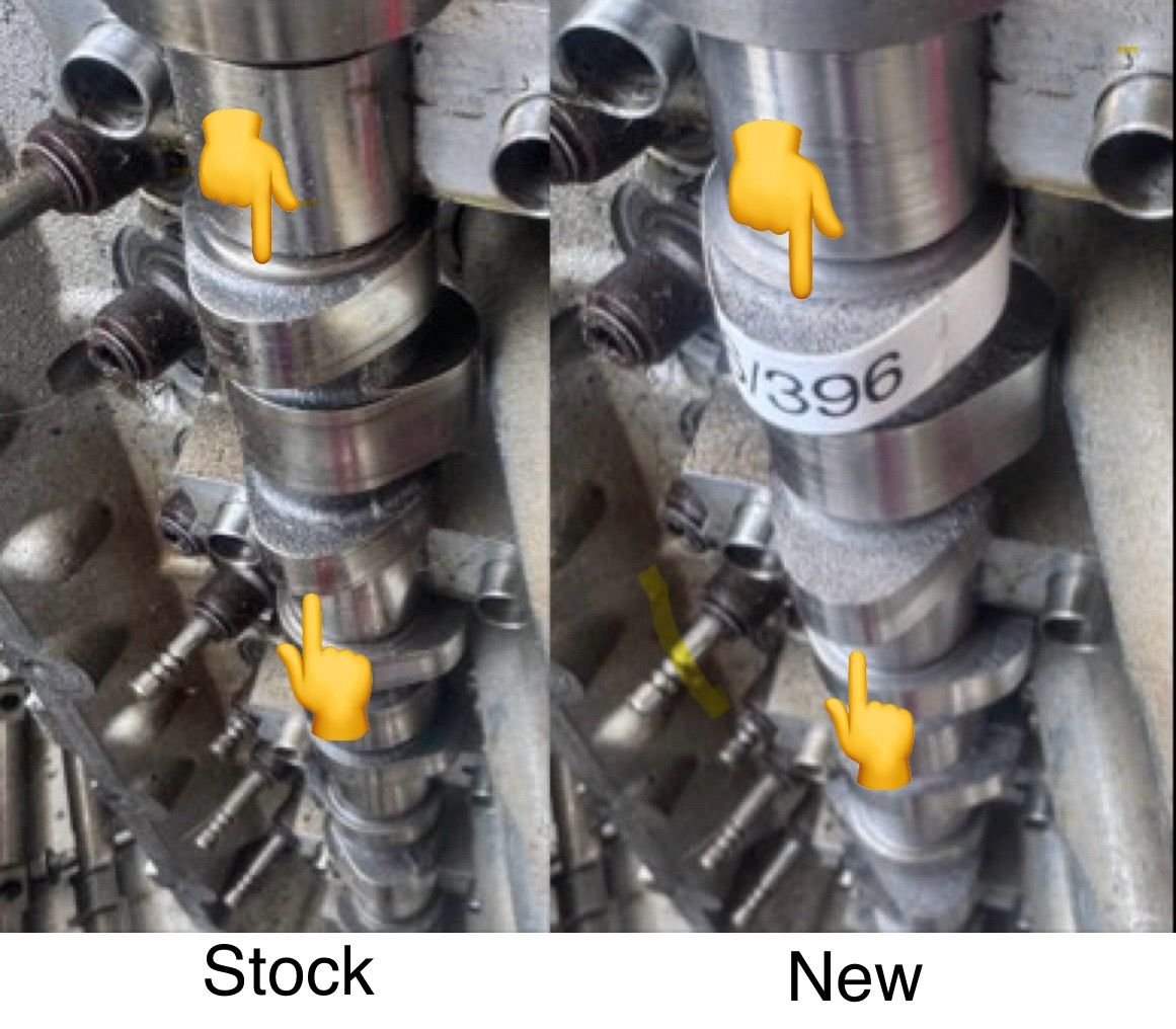

Just got done with assembly
Originally Posted by LeviCameron
Any update?
just got done with assembly of the short block. Will start swap sometime next week and probably take about a week to get done as life and work comes first. Will let you know when it’s all together and running.
New cam compared to the stock cam
Short block with my old head in it for pic
Took the old motor out on Sunday pulled the head off and tore it down, cleaned up all the ports and opened them up bit. Went thru super charger, cooling system, flushed out heater core, and a few other things. It runs amazing has great pull from about 2700rpms- 7100rpms still being pretty nice to it for the beak in but was brought up with break it in like your going to drive it and heat cycle it with care. Super happy with everything on this build and the outcome it’s a good daily that doesn’t leak anymore oils and hopefully has a long time before it starts burning 1/2 a qt every 250-350mile lol
