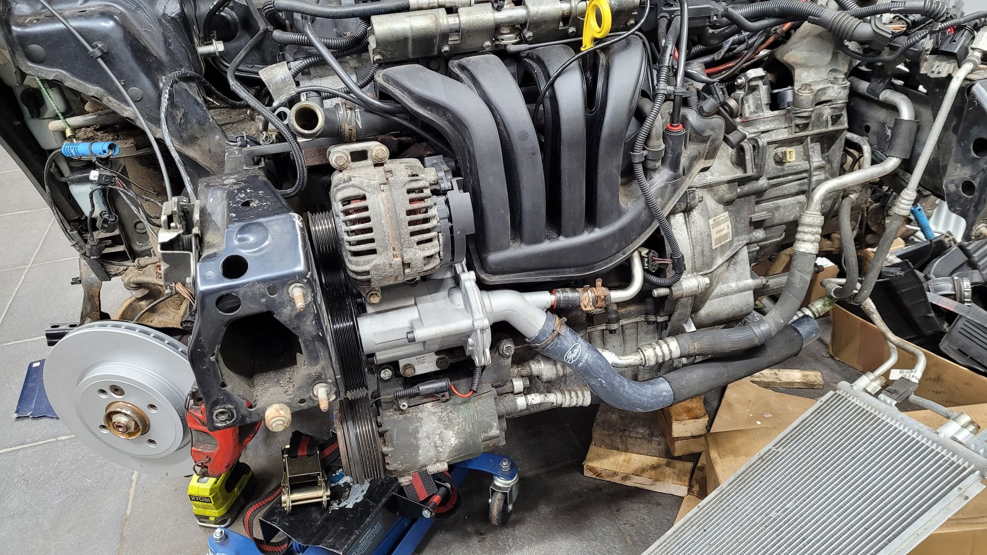

A little stumped here. This is the upper radiator hose on the passenger side where it will connect to the bleeder elbow piece. I assume this hose is supposed to sit into that plastic holder but it doesn't even come close to fitting. Also I'm not entirely sure how the hose is supposed to be routed back there because it's behind all kinds of stuff. There are various pipes and tubes in there I'm not sure if I'm supposed to be routing behind, in front of, above, below....
Old Mar 18, 2025 | 11:17 AM
  #31
Posts: 36,759
Likes: 2,548
I think its this guy your talking about? The OD on the delco hose look big. maybe the hose just needs slide more to the left?

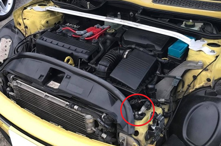

I think you are actually very close! Looking at my own photo that hose should end up halfway the alternator. Then the elbow piece will make the turn which then connects to the upper radiator hose.
Some photos for reference:
https://www.ecstuning.com/Search/Sit...h/17121475561/
https://www.realoem.com/bmw/enUS/sho...diagId=17_0219
Yeah, I think the AC Delco is the problem. It was under my make/model/year on Rockauto while the correct Rein was not, but the diameters are different. Arrrrgh.
Also why is this called "lower radiator hose" everywhere when it connects to the top of the radiator, not the bottom? Driving me crazy.
Originally Posted by LukasH
I think you are actually very close! Clip it in and I think you are there. Looking at my own photo that hose should end up halfway the alternator. Then the elbow piece will make the turn which then connects to the upper radiator hose.
Thank you! Yeah this is not clipping in and I can't squeeze it by outside the clip. I guess I could just break the clip off to make room but then the hose is just loose in there. I've ordered the correct hose. The project continues....

After further inspection you seem to come 2 inches short. I don't have pictures for routing from the thermostat housing unfortunately.
You want to rule out you got the wrong part. Does the bleeder valve part actually fits snug or is it floating around in the hose? Can you compare it to the old hose for length and diameter?
Any chance you can get your hands on a hose from Gates? I replaced my lower hose recently and it's a top quality brand while not expensive. (€10 which would be ~$12)
They're the same length but the old hose is 39.6mm OD at this end and the ACDelco is 42mm; old hose is about 35mm at midpoint and where it clips but ACD is 41mm there.. It's 2" short because I don't have room to shove it past the clip and can't get it into the clip. Bleeder valve fits snugly, ID seems okay.
