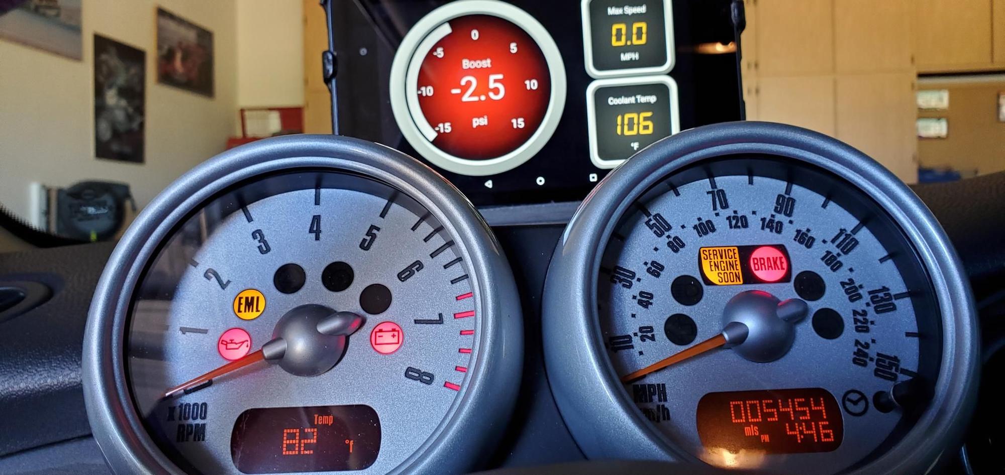

Your loss in boost is greater than I saw at 5k' at my former home (now at 7.4k' in easternmost AZ). Negative 2.5 psi correlates with the chart I found online (see pdf attachment) when understanding my own boost numbers (displayed on Android tablet from bluetooth OBD2 port dongle). I'd suggest rechecking your gauge against a similar method. In any case, no way known (by me) to counteract the effects of elevation.
