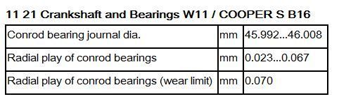

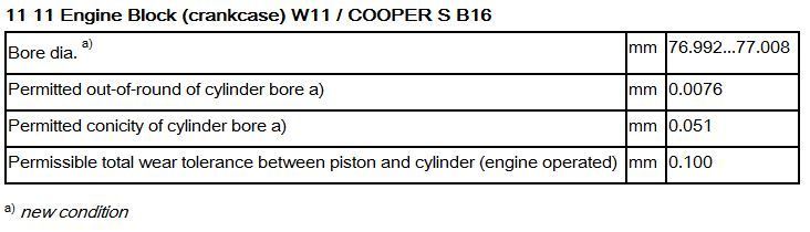

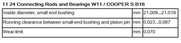

Hey folks maybe I am looking in the wrong spots but I am looking to machine my block and I seem to not be able to fund the clearances and the specs. Crankshaft, cylinder wall etc, head clearance for camshaft bearings.

Originally Posted by mrbean
Thank you very much.
