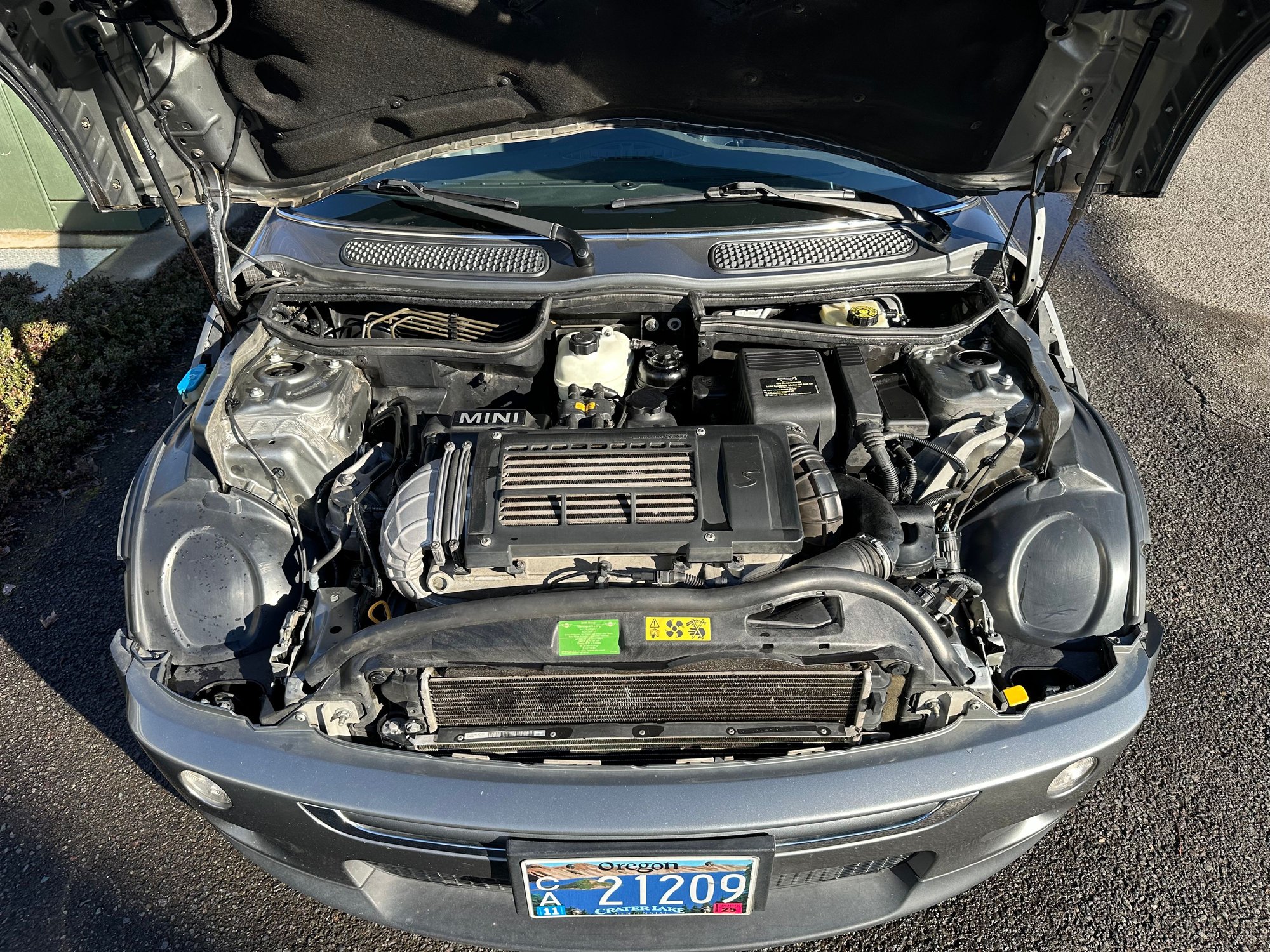

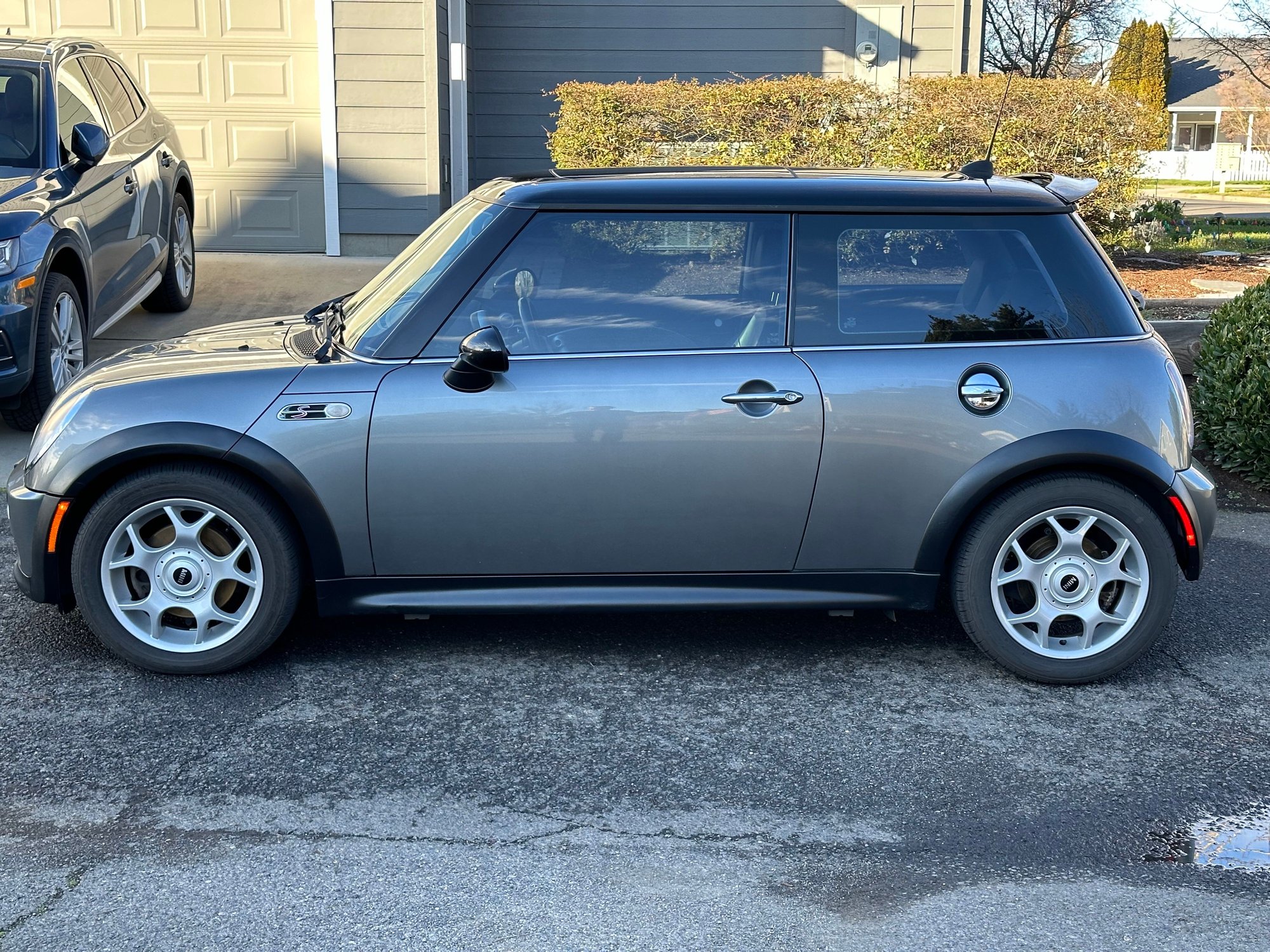

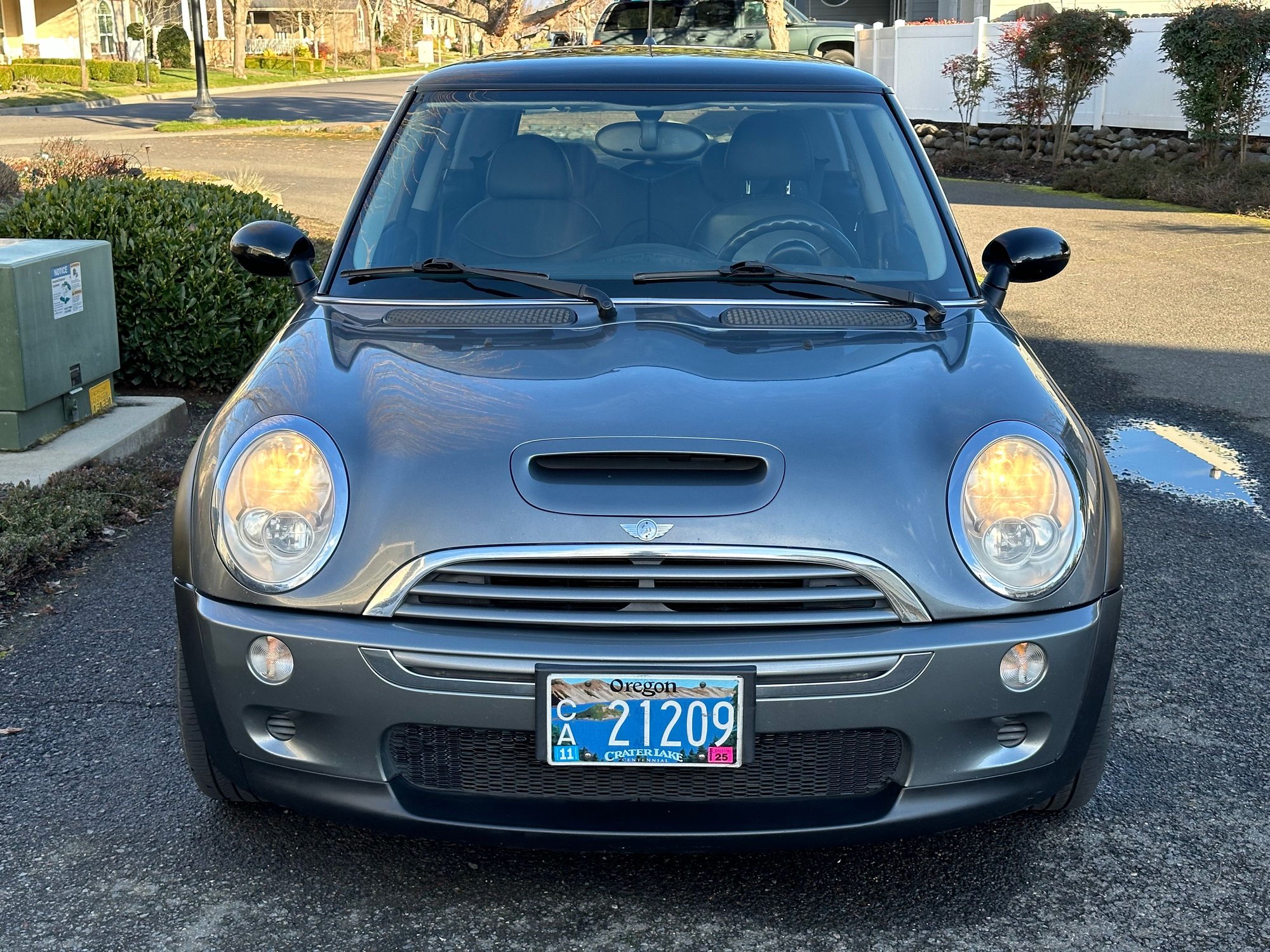

I just purchased a 2006 R53 no mods. I have been on the fence about buying Mini for years because of the reported poor reliability issues. I jumped on this 2006 because it was the last of the 1st gen and I figured most of the issues had been worked out by then. Secondly I find that the Mini has a strong emotional pull and I might be far more tolerant of issues as well as accept that "because its a Mini" it comes with the territory. I currently own a 2018 Audi Q5 (56,000), 2014 Jeep Grand Cherokee (112,000) and a 1959 GMC pickup (who knows). Still on my insurance are my three boys, 1998 Ford Ranger (203,000), 2005 Toyota Matrix (284,000) and a 2006 Honda Civic (245,000). So multiple brands, ages and reputations. I keep a running list of all things done to my cars so I have a good idea of maintenance and repairs. This got me thinking about reliability. I love stock cars and never modify them, except for perhaps a repair that might be better served with an improved part. Also each of the cars has a different driving profile such as the Jeep going off road will get a different life than the Audi which gets high speed highway driving. I maintain a reasonable maintenance schedule on the fleet. I have already noticed that my choices on the Mini are different. I am replacing the original alternator because it has 131,000 miles and it was on sale. It also takes any possible future electrical issues out of the equation (in theory). I am also replacing the bypass valve because of mileage and my boost gauge seems to be showing wrong numbers (long story). Control arms bushings need to be replaced but I will also replace swaybar links, inner/outer ball joints, swaybar bushings, outer tie rods. Why? Because it is a challenge and rewarding to work on your own car, troubleshoot and hope to resolve an issue(s) Also I will be dropping the subframe so as many have said, do what you can while in there. I am the forth owner of the car and the last person worked at a repair shop and got it from a client who was having some significant "supercharger" issues. He fixed it up at cost and no labor and drove it for a few years. I downloaded the Carfax and have those "documented" repairs, but any diy repairs/maintenance service will not be recorded. So data might be incomplete. The majority of work I do see was when it "broke" down....I think, I might be wrong but it was a tensioner that broke and caused issues. As you will see I bought a Mini that has had a reasonable amount of repairs done based on age as well as a single event recently so my thinking was that I have a fairly strong mechanical car and now its my turn. Overall any car that showed this level of "work" would not surprise me or concern me. I did not feel like this is a money pit, but this car is so fun to drive that I already know I will accept more issues than perhaps is desired. So with all that said here is the "history"

Nice looking car.
Seems like it has been reasonably kept an eye on followed by repairs/replacements.
Early in it's life - Oil changes seem to be spread way too far apart in my opinion. But that's just me.
Looks pretty nice for an 18y/o, well maintained with a fairly good maintenance record.
Congratulations!

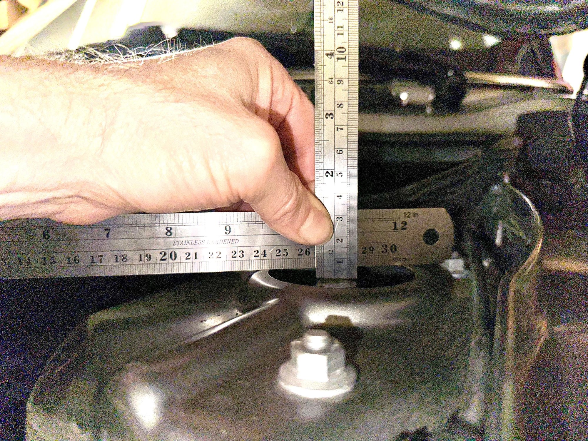

Can you clarify the "retaining bolt" in the steering knuckle issue? Also I poked around last night and can see that the front sway bar has red bushings. Clearly those have been replaced. Also I inspected the strut mounts from the top and both look clean and free of any cracks. When I measured from the dust cap to the top of the tower mount the driver side was 3/8" The passenger is a bit less, so it does have some "mounding" I didn't take the wheels off yet but I can make out the the words Delphi on the struts. Here are some videos of the suspension before I make any changes.

People have broken the pinch bolt in the knuckle that holds the strut in place. I expect if your car is as clean underneath as it is on top that it will be fine though. I had no issues with mine.
It’s good that the sway bar bushings have been changed. That likely means the subframe has been out of the car. It would be difficult (maybe impossible?) to change them otherwise.
You should also check strut tower flatness. There’s a decent chance they’re damaged. I had some minor mushrooming in my car, and I’ve always run lightweight 15” wheels with normal tires.
