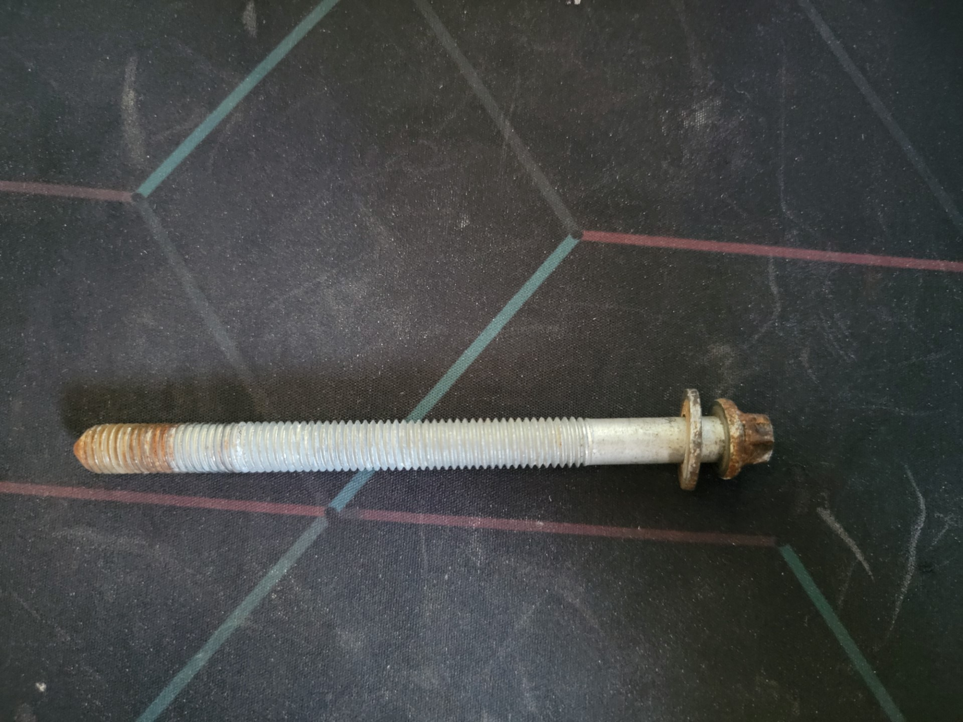

I believe this bolt fell out of my 06 mini cooper 6 while driving today anyone have any idea what it might be from? It is about 6 inches long. It may have just popped of f the road but i don't believe so.

upper motor mount. Goes in from below on rail. passenger side.

thanks for assistance it was right were you said it would be. Now to get it back in somehow.

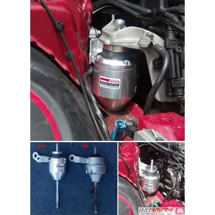

+1 this. Anti-seize is your biggest friend with this and many other parts. And the OE engine mount design is sorely lacking as you likely already know; just installed the 3rd one at 69K; next go-round it's getting one of these:
https://www.outmotoring.com/MINI-Coo...nger-side.html
