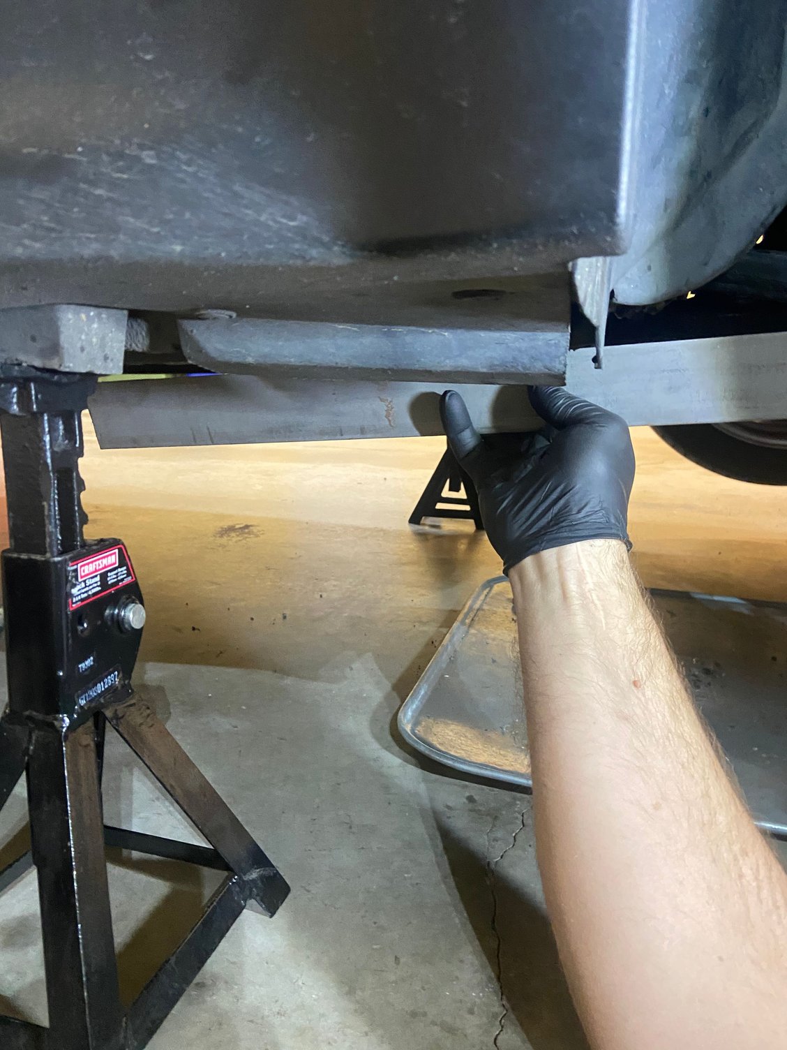

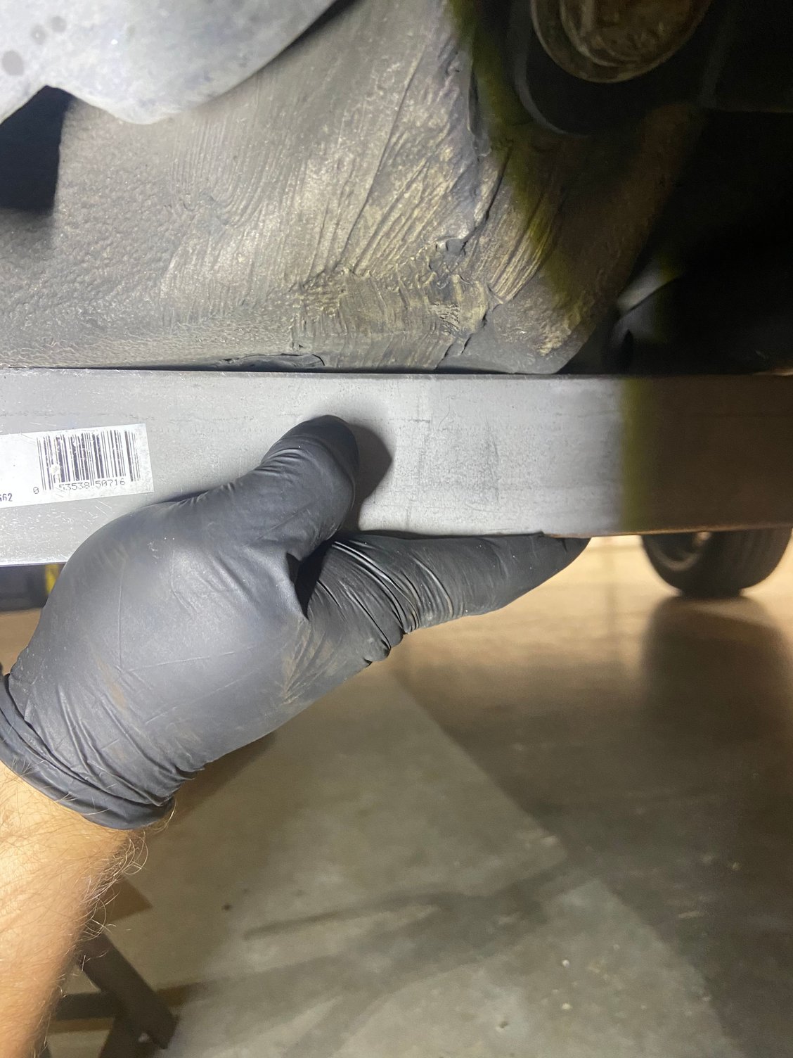

I did remember that the car fell off the jack the other day which has never happened to me before, but it fell onto a jack stand and i found a small dent in the chassis where it landed on the jack stand. It's kind of close to where the control arm bushing bracket bolts to the chassis, so I wonder if maybe that is part of the problem. I'm trying to find a frame shop near me that I can talk to at least. I'm also just tempted to put adjustable camber plates on it and call it a day. Any recommendations on adjustable camber plates? I'm kind of between vorshlag and Ireland engineering. I like that the bearing is replaceable on the IE plates, but the vorshlag plates look a bit more robust and I find fewer complaints about them, though they're twice the price of the IE plates.
