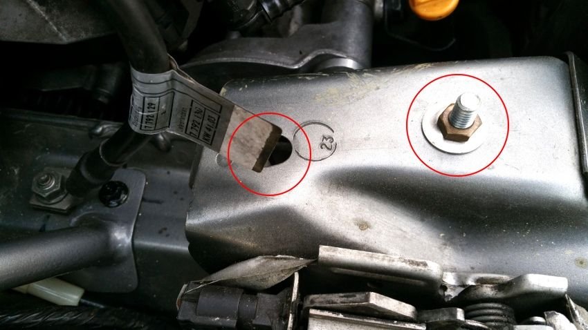

In other news, the left brace fits without surprises. I marked the holes today but won't drill until I know that there's a workable solution for the right side. Current thinking is to use a cutoff wheel on an angle grinder to remove the old ground stud and then weld a new one about 1.25" further back.

@Jason Cornelius Thanks. That's the how-to I'm following. Or was following until things went sideways.
@Here2Go I wish there was another frame-mounted stud nearby. I don't seen one. While looking for one, however, I had a thought: I wonder if a rivnut in the appropriate location would give enough metal-to-metal contact for the ground? I can think of several ways to attach the ground strap to it. A bolt would be easiest but I could also use a small metal block similar to the factory ground point. Drill and tap it and put a bolt through it into the rivnut. I could even relieve the hole a bit on the back so that the block would sit flush on the frame.

Embarrassing - Believe it or not I didn't have any 13mm nuts or bolts to mock up this example. I think of the 2wo holes; the preferred hole would be closest to the original
ground bolt location. Square nuts may still be available as an improvised "block". Grind, Ospho, weld.... The hood still shuts with no interference....
FWIW...you get the idea.
