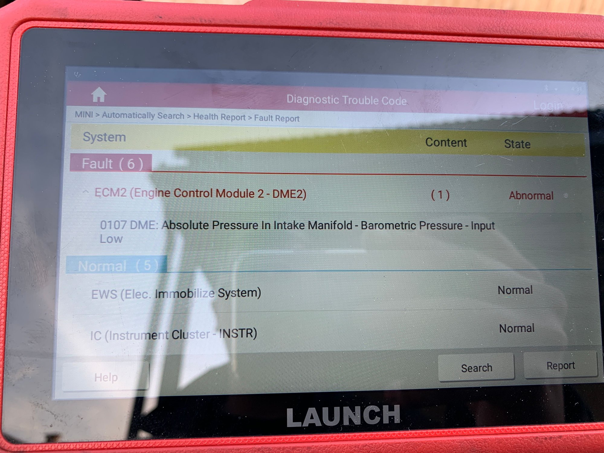

Spark plugs are half year old..I suppose the fuel filter was not changed for at least 10 years… but I am getting code p0107 ever since we got the car and we put on the oem sc pulley. Before there was a 15% pulley installed and the car was mapped. Thanks for any advice. I was thinking of swapping back the pulley and then see if the code and dsc light will dissapear.

Hi, I’ve ordered both sensors and there was no improvement.. p0107 still showing. I have just tried to change the tmap sensor and put in the map instead and the light went off but car was running incredibly lean. Please HELP!!

But isn’t the code for intake manifold low input??!?!

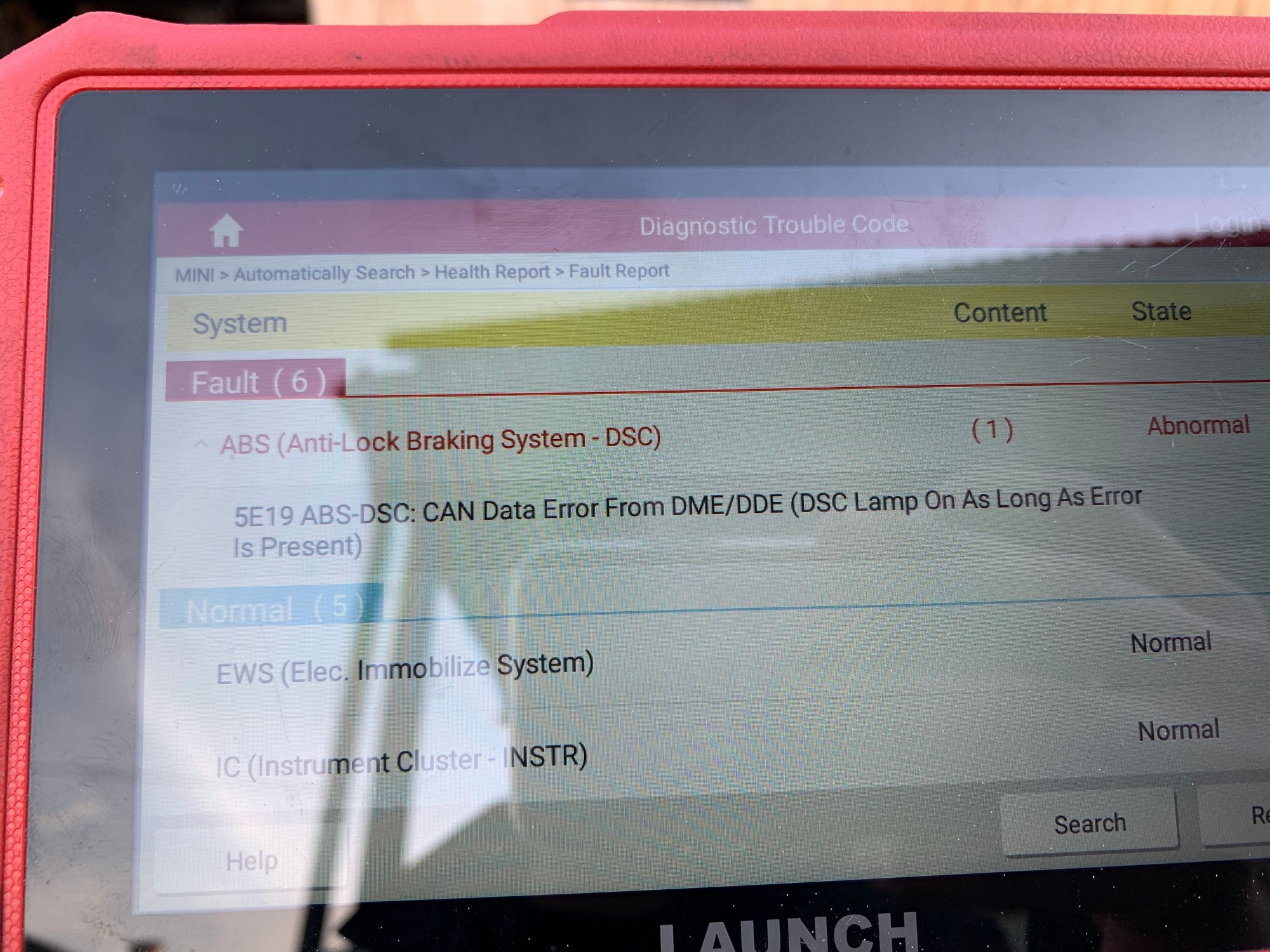

But i can’t even turn off dsc as it is always on..I got the code 5E19 CAN data fault from DME/DDE(DCS lamp on as long as error is present…. I really don’t know what to do!

How did you pull the can line code? Do you have Ista-D IT has a lovely function where it scans the Can and K line for a response/ping from each module. I think your in some form of Limp but not tradinaioal limp mode. Meaning something else is at fault and reporting bad info hence the light that wont go off and self limiting the engine. DSC/ABS errors can trigger this where the module is bad and it throws out there in the stream your slipping and does what it should when that happens if that makes sense. ALl wheel speed sensors working?
The 107 code could be a result of the main issue. Not the issue itself. Try disconnecting the abs module harness clips and re attach them. Also pull tmap connector check for corrsion and that its not all loose from years of vibrations that will throw random issues at you too I know that first hand.

Well I edited my post with things to try. The abs/dsc error can be a side effect and vice versa for the 107. Unplus the abs module or fuse clear codes power down re connect modules.

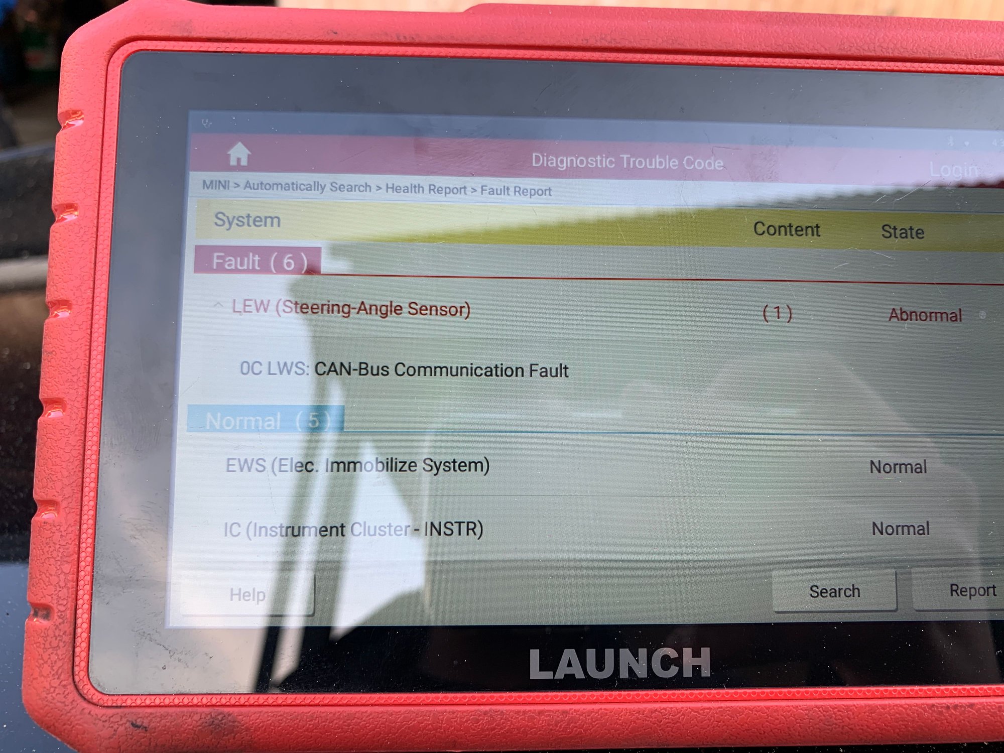

Also if the steering sensor is bad it will throw a 5e19 related code as a symptom of the steering so is that code valid I see for steering:? I honestly think you have a canbus issue either with a module or with wiring. Everybody has their own thoughts and opions on stuff. fwiw I was a tech for most of my adult life. That being said try to get ista d setup as it has in depth dealer level Can bus diagnostics and on screen step by step instructions and again its a dealer level package so can do stuff most people wouldn't even know existed. When it first links to the car it pings the entire Can/K system and displays a GUI flow chart of each module and if its working. Pretty sweet as the gui is well done and maps out the system and lets you send and receive commands over the can/k line.

Your error is “Barometric Pressure - Input Low”
It’s a pain if you’re new to it, but the thing to do is to check the pins on the cable for power and ground, or for resistance. I haven’t looked up the schematic but you should be able to find what signals the sensor is expecting to receive, and then test if it’s getting them. Then you can put probe traces on and read the voltage or current when the sensor is in operation. Sometimes, it can be the connector or the wire or the DME. It’s not necessarily the sensor.
Another method is to find a friend with a working car and swap parts to see if the fault follows the part. It’s SO MUCH cheaper than just buying parts and praying.
