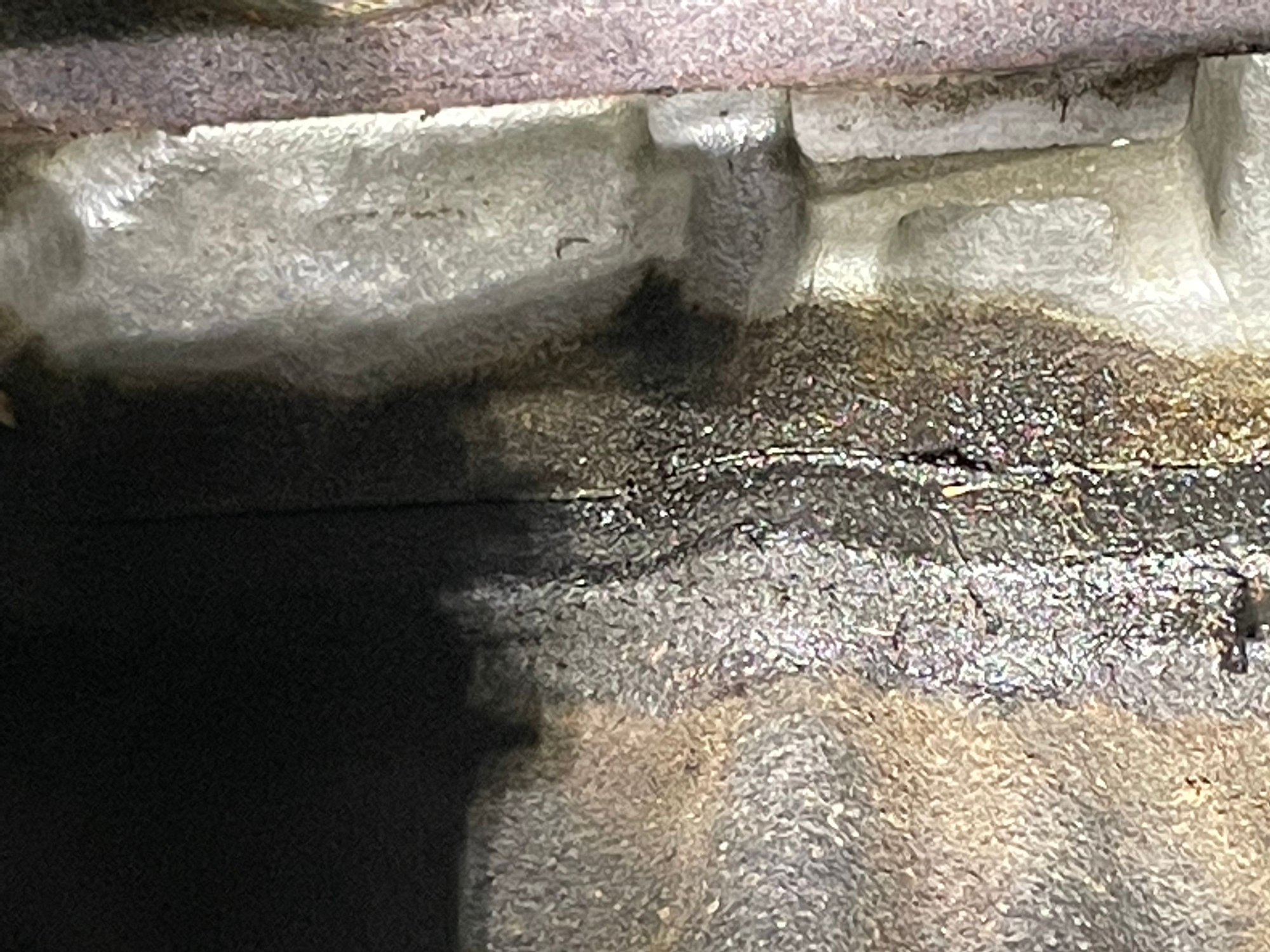

I’m in the midst of refurbishing an 80,000 mile 2004 Cooper S which a friend gave me. It needs a new clutch and so I’ve pulled the subframe and axles. There has been a lot of oil leakage, especially around the oil filter housing/oil cooler area. That’s much easier to see with the subframe and axles out of the way.
Drained the coolant, engine oil and trans fluid. No signs of contamination although the coolant was brown.

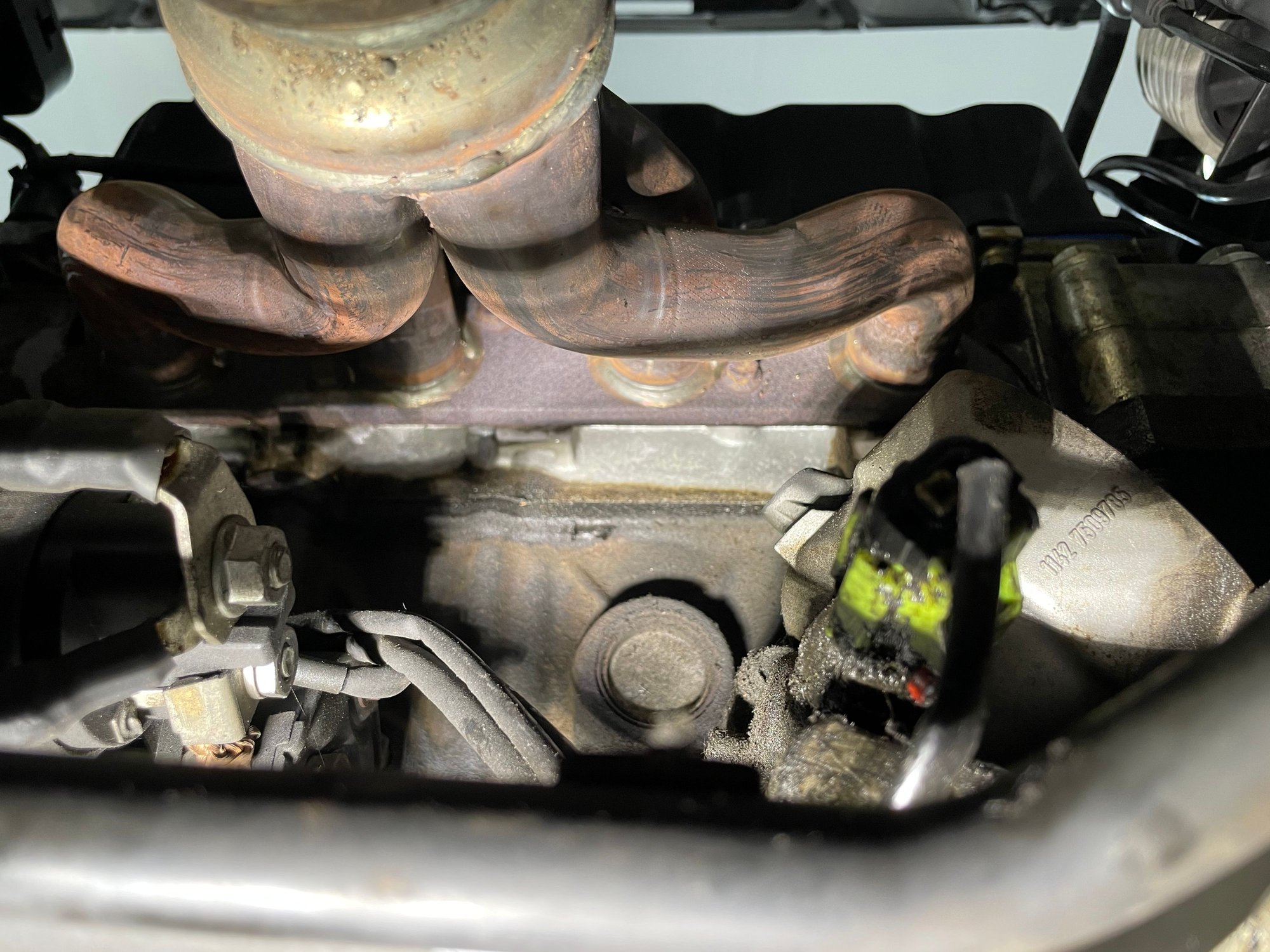

Pleaee look at the attached photo of the cylinder head area. There is no sign of heavy oil leaking, but seems to be some seepage or discoloration. I’d really like to wrap up this work without replacing the head gasket. What do you think?
The more I look at the photos, the more I think there’s nothing wrong.

It's more likely that oil is migrating from a leak somewhere else than for the head gasket to be leaking oil. In fact, in your first picture, there is a trail oil coming from above the head gasket. I would follow that trail. Leaking valve cover gaskets are very common on our engines.
Thanks!
Yes, I’m certain there are other leaks and I’m replacing all of the gaskets except the head gasket. I already did the valve cover gasket so it looks clean but the oil filter housing is a massive mess.
