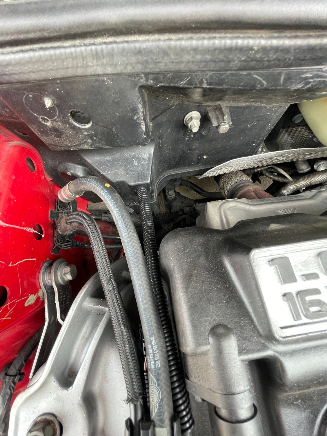

Hint: I stole the vacuum right angle that goes into the Fuel pressure regulator on old engine to replace the one that sits under the supercharger horn and was rotted out on both engines. Strangely both FPR right angles were in great shape, and both the ones under the horn were rotten. The one on my 05 is also fugly under the horn but intact for now, whil3 the FPR is perfect on it too… I’m guessing it is the location under the horn that kills them?
next junkyard trip I’m going to grab another FPR right angle if I can find one to proactively replace mine.

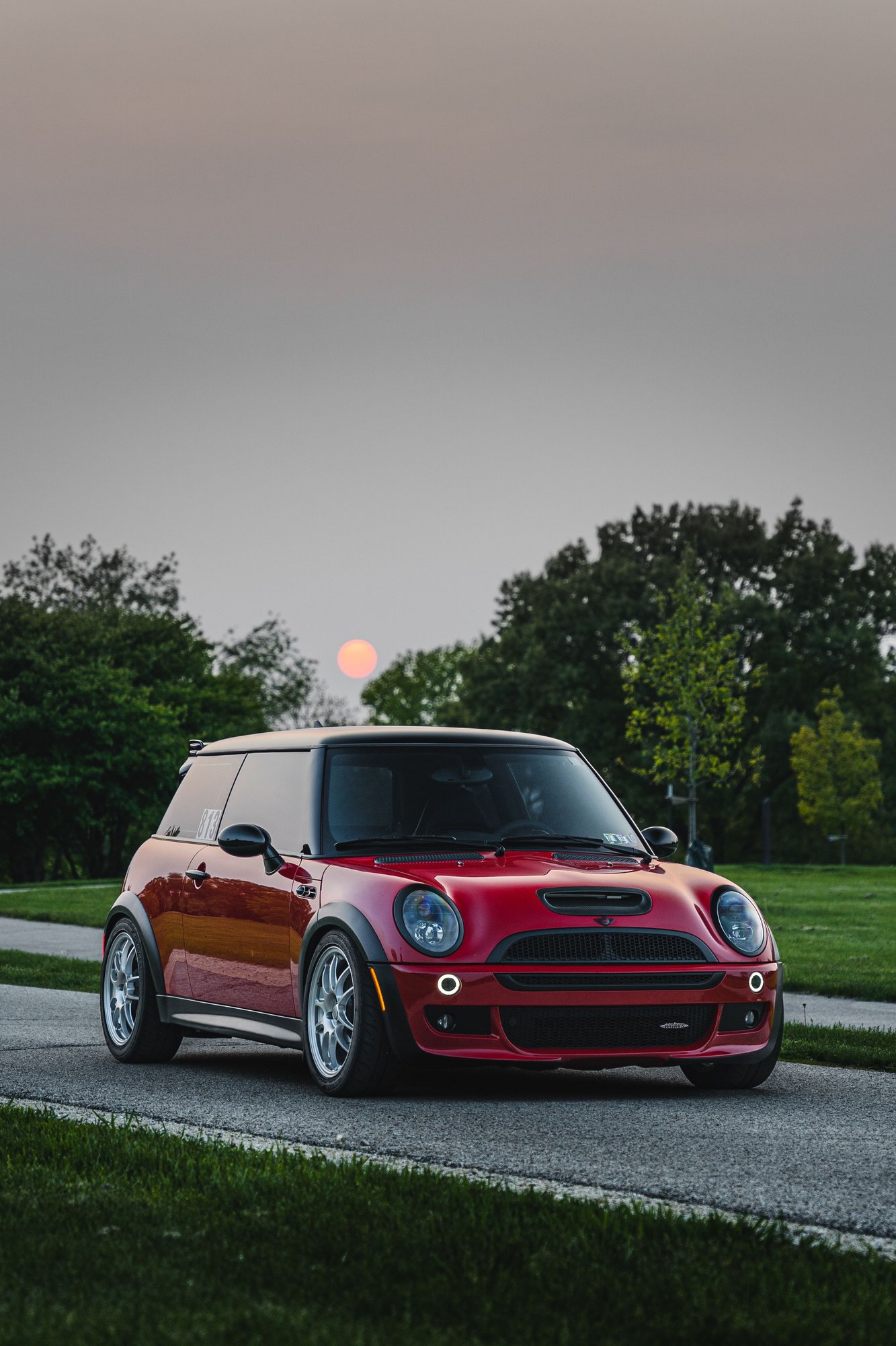

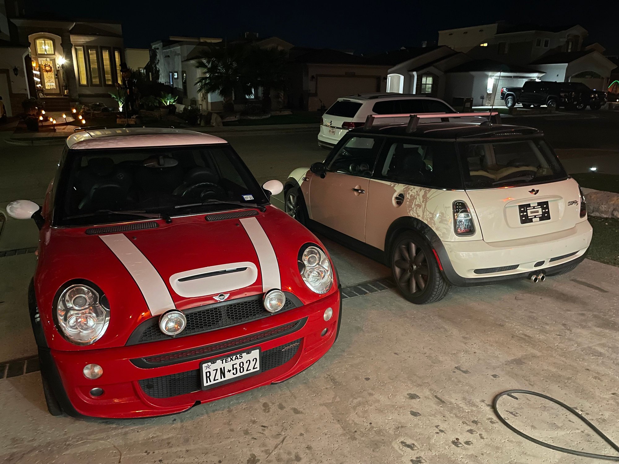

It’s back together! Took a little over a year to get back to running, thanks to all who helped us figure out things and provided good vibes.
got one wheel left to put on then we can get it off the stands and take a test drive.

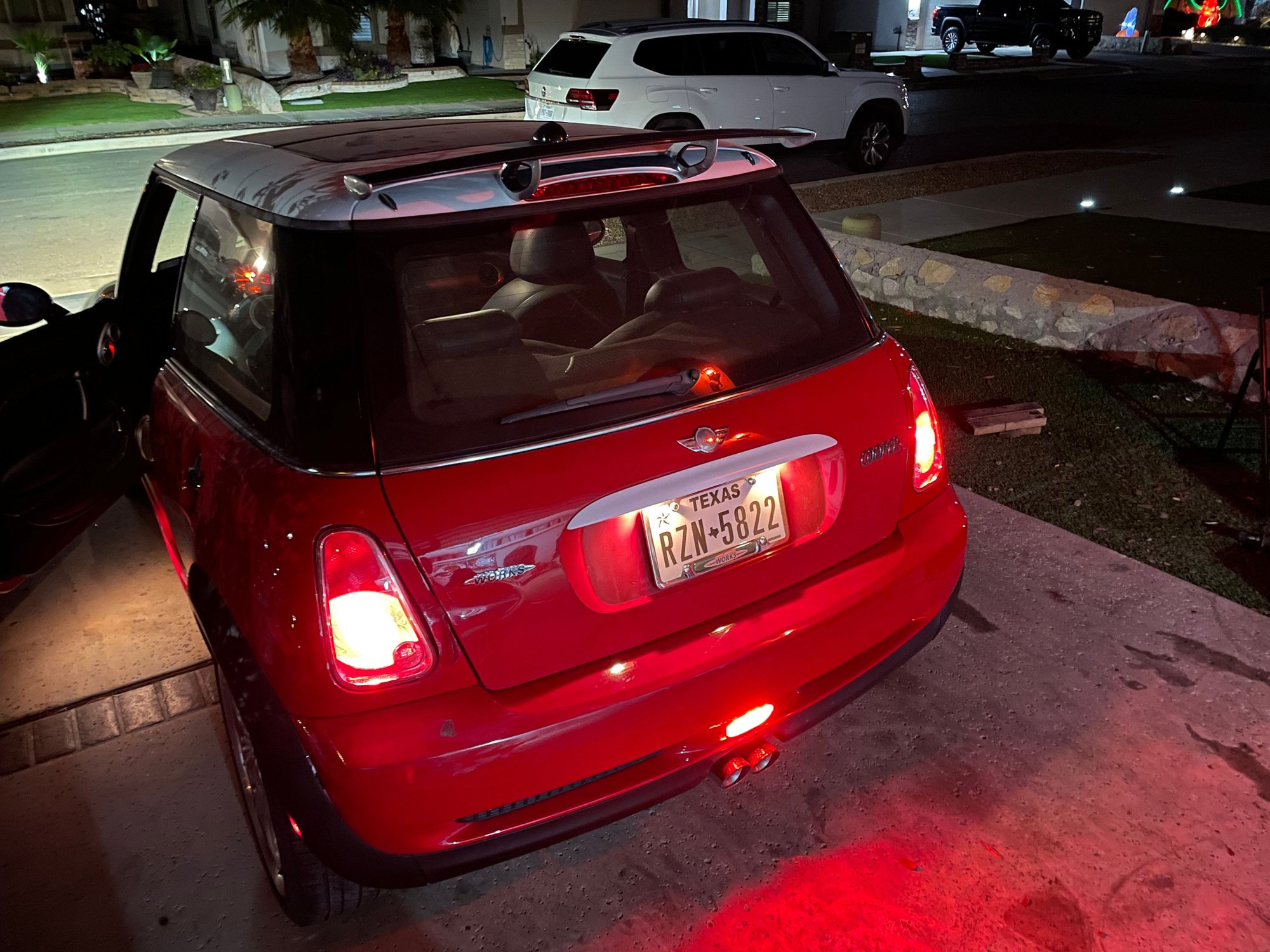

Btw, the clear reverse housing with red zevo LED looks great as rear fog.
Old Oct 1, 2023 | 10:30 PM
  #130
Onizukachan's Avatar
Onizukachan
Joined: Oct 2017
Posts: 571
Likes: 369
From: El Paso TX

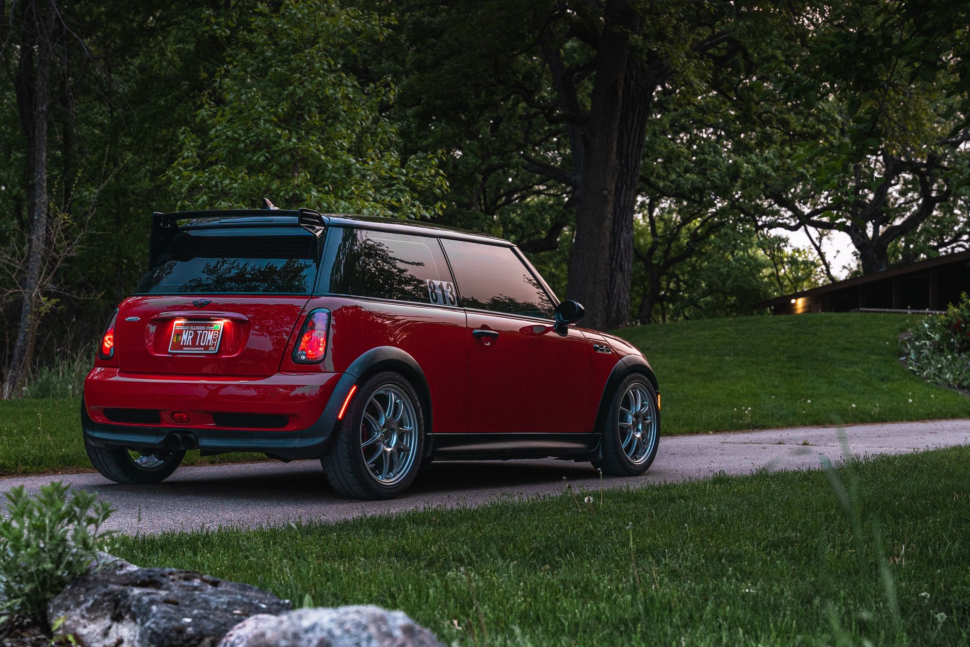

A few more pics.
I have the feeling we will need to change the DV over from JCW and/or the crank pulley as it doesn’t have the oomph it should, it pulls just like the donor car did despite having a 16% pulley on it now, JCW tune and injectors, jet not as hard as my S with a 15%.
but drove it about 11 miles and the clutch is firmer than it was at first and it runs nice and drives well.
Will have to hook up computer and clear codes and see if any do come back.
basically we are almost back to where we were 13 months ago!
rear Fog accomplished with Sylvania red LED and the reverse housing from a pre facelift,
Had to go fill it up with fresh premium since the last time was Sept 2022…
both together at last.

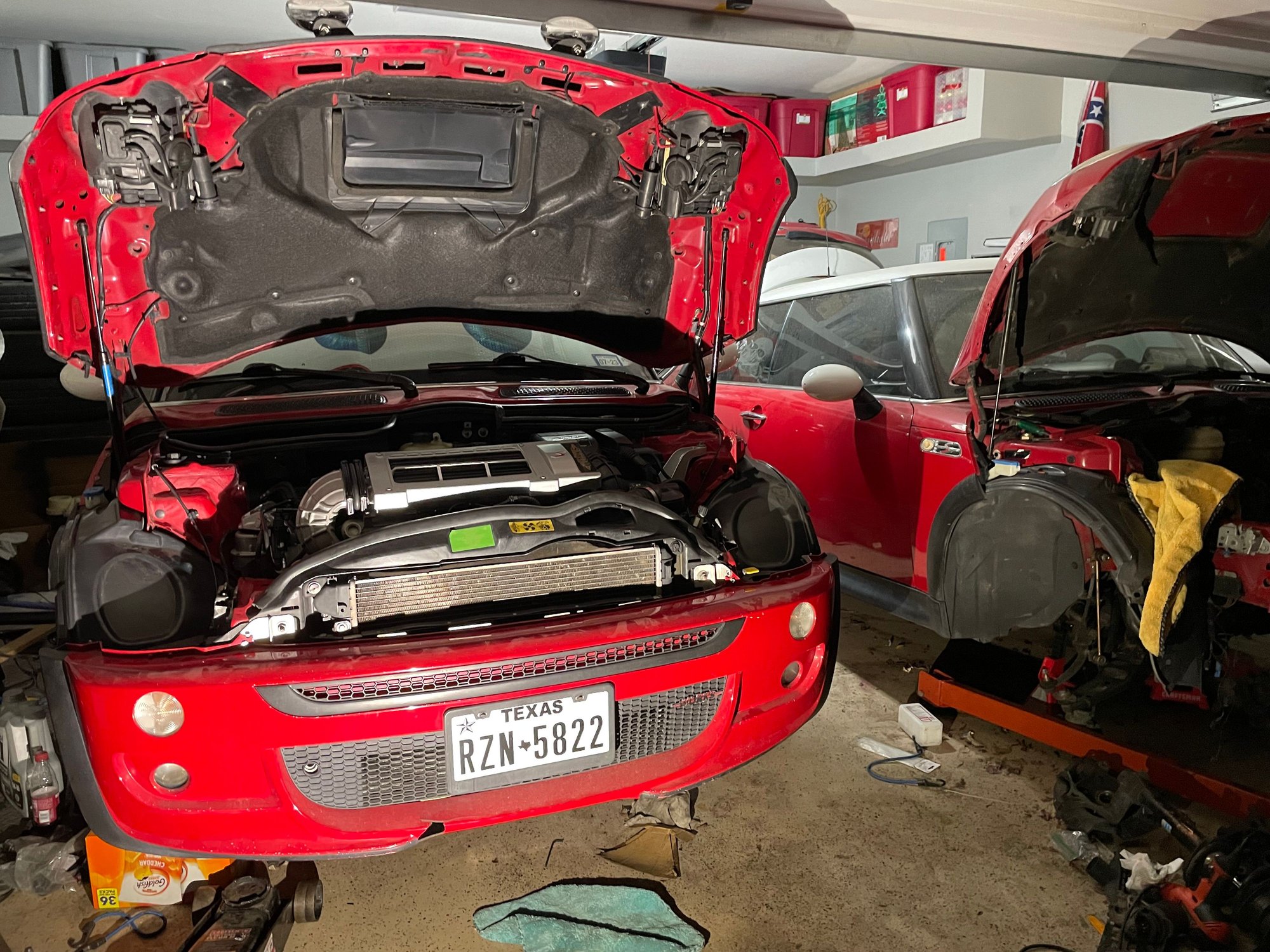

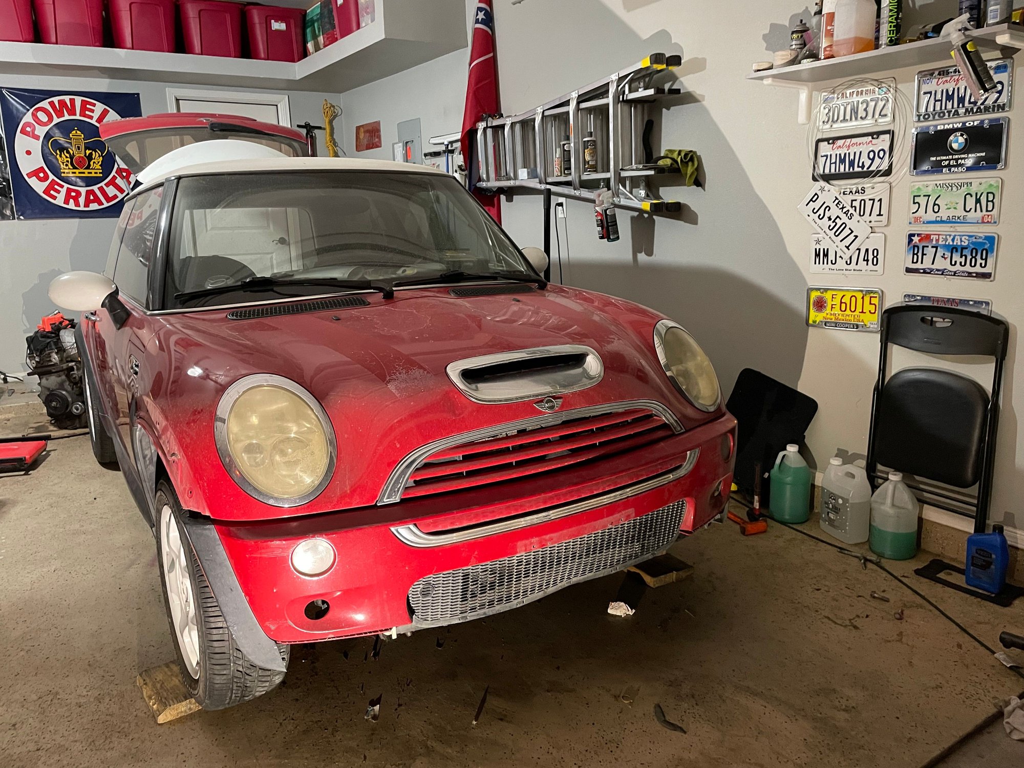

It’s been a week and over a 1/4 tank of fuel, and no CEL.
double checked exhaust manifold to head tightness one last time and reinstalled the heat shield.
also I was stupid and forgot and slammed hood last week which caused the top headlight adjuster to pop loose, luckily cranking the adjust full low got it back in place, and then was able to re-level to match the other side against my garage door.
so we can call the re-engine on Chili a success!

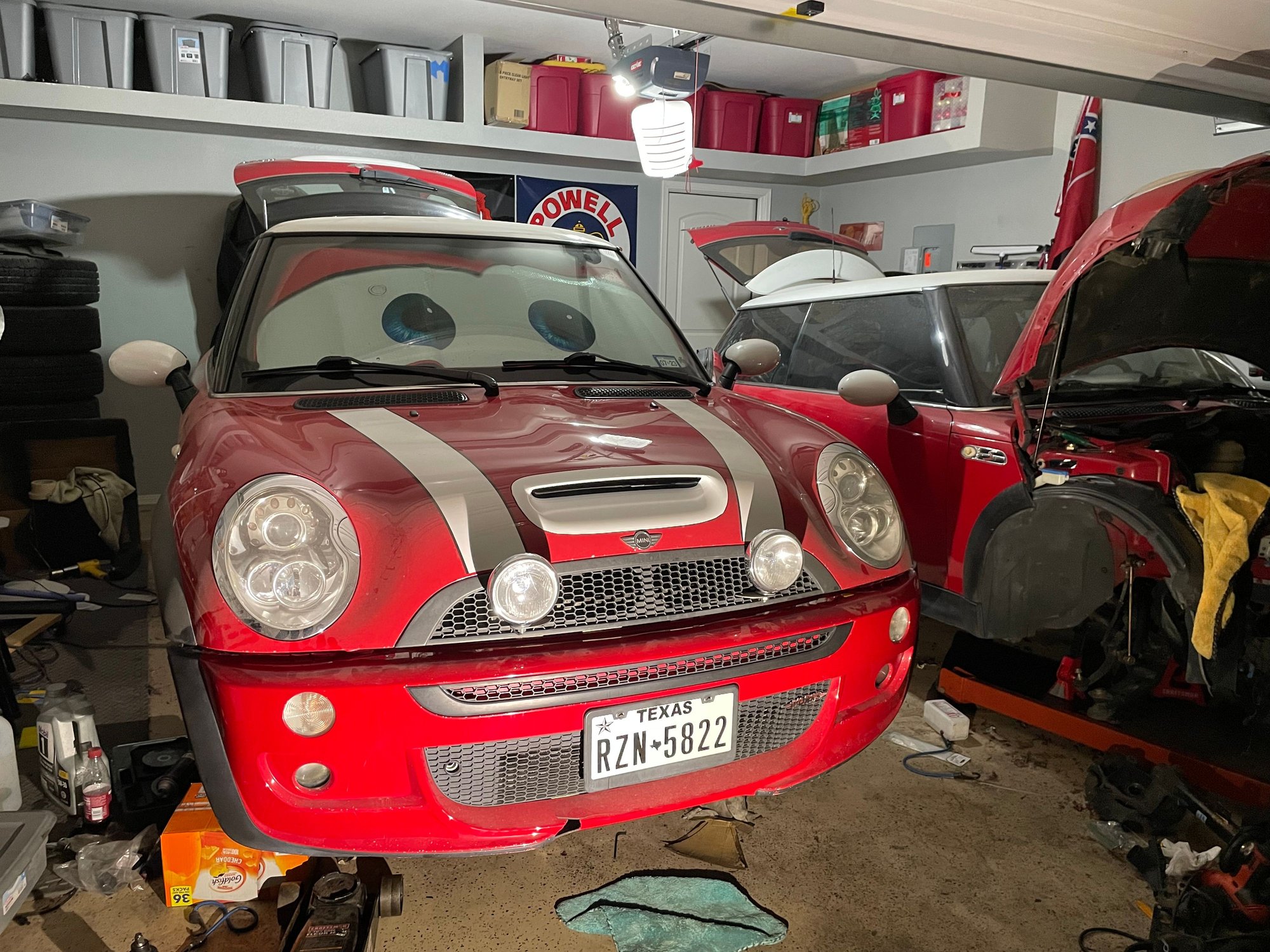

Parts car is back together, everything I wanted off it is out, except the rear strut assemblies.
ie complete engine for chili, tall gear getrag trans & factory exhaust manifold as spares, fender trims, HK speakers/ amp and front strut assemblies for my car.
front 02 I still need to install in mine, but Figured since I swapped the newer fronts over to replace the 160k originals, I should do the rears as well before we roll it out to the street, but had to get car back on its own front wheels first.
also have cool aftermarket PFL extended door armrest and we took the aftermarket glovebox divider for Alex’s Chili and between this parts car’s iPod adapter and the one Chili had, we’re able to put together a complete working one that needs installing.
the one fault it has now is the key remote, swapped mirrors and then programmed mine to his car so have narrowed it down to the remote itself, have seen the solder in batteries but not sure I want to cut a FL key open, may simply see if BMW can order me a second key and keep this one as the spare.
parts car looks like it is up on jacks still with no trans or engine in it, but it’s down and I can take the rears off and swap them around now. Force of habit, I still put the blocks of wood under the wheels for jack clearance, though as you can see, it was certainly not needed!

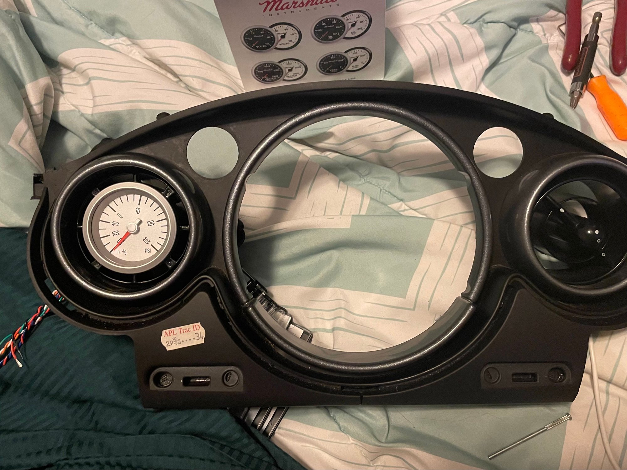

Parts car is gone, got iPod adapter back in Chili and it works correctly now, still have Sirius, BT Aux, and of course radio and cd. All working.
found a New in Box Scosche Passport so now the Mini iPod adapter also charges the iPods.

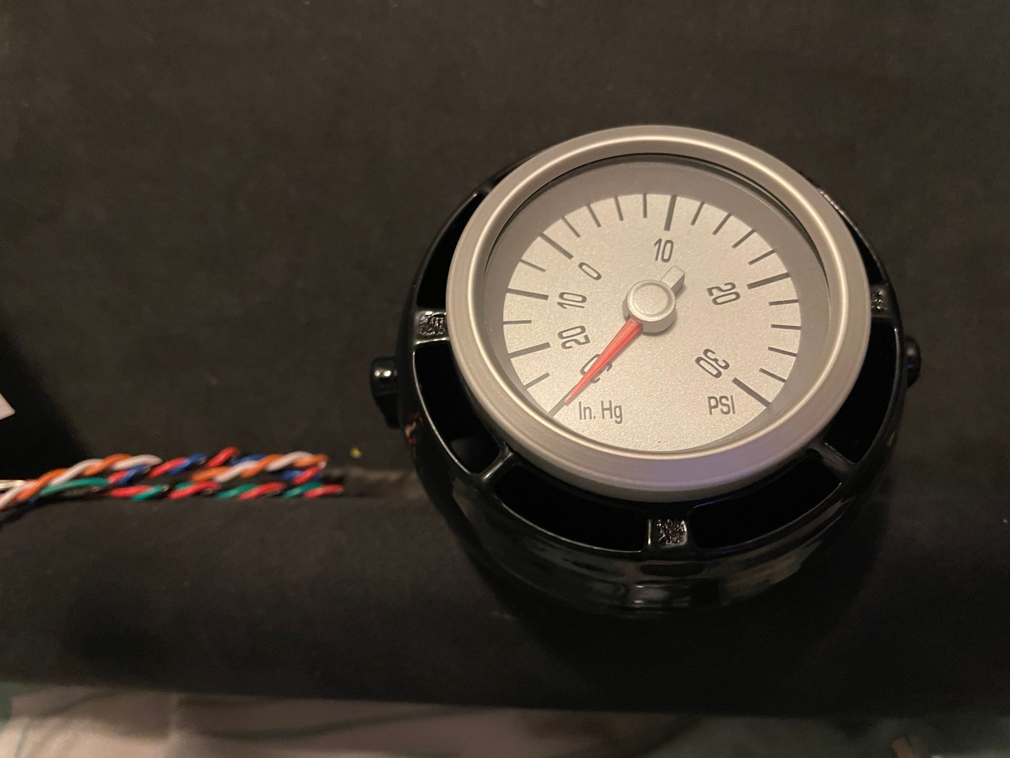

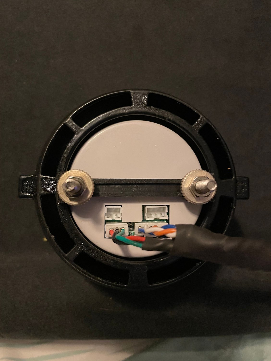

Have this to install this weekend, but will need to get a correct black non restricted T (tried pulling brass restrictor out, no dice, then tried catching it with a drill bit, it went deeper) and correct sized rubber vacuum boost line as the clear vinyl one supplied does not even fit the T nor the boost sensor anyway.
and I need to solder in wires for the boost sensor to run back to the gauge but I got the connectors on, loomed the wires and heat shrunk them into bundles so it will be easier to install thru the vent.
maker is Ido3Dprints.com, I got it laser sintered and looks much much better than the typical 3d textured print, it’s smooth and glossy. Also has a lifetime warranty for cracks splits or melts.
three layers of thin double sides tape on bottom of gauge and 2 across top of gauge and it stayed perfectly in place.
cut the back “brace” off the Marshall supplied retaining bucket and reused it as a retaining plate for the back of the gauge.
Can you explain the laser sintered part? Looks like typical FDM style print that has had an acetone(?) bath/treatment to melt the layers down. Is the material ABS rather than PLA? Thanks
Old Oct 20, 2023 | 08:02 AM
  #139
Onizukachan
Joined: Oct 2017
Posts: 571
Likes: 369
From: El Paso TX
You’d have to ask the maker. That’s what they call it on eBay. *shrug* I just know it looks hella better than raw and is very smooth and polished.
and yes,it’s ABS, not PLA
https://www.ido3dprints.com/product-...-52mm-hvac-pod

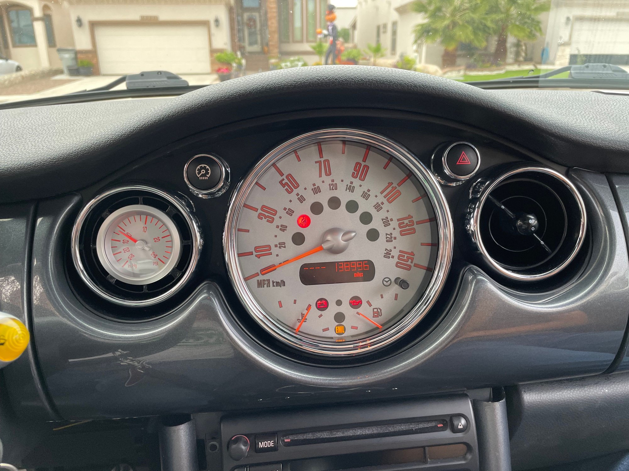

Did a little test fit in a spare dash center left over from Route 66.
glad I did, didn’t remember the retaining humps are clocked 45 degrees on the vent so had to take the gauge back out of the mount. Had to reclock it at roughly 45 over with it half in, then fiddle it the last 2-3 degrees to be totally right and then remount the rear brace part again to lock it fully down again. Just need to solder longer leads on the sensor wires, heat shrink and braid those amd we will be ready for install tomorrow.

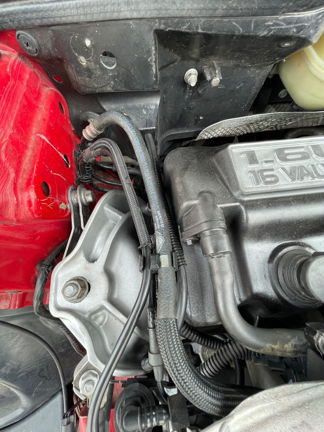

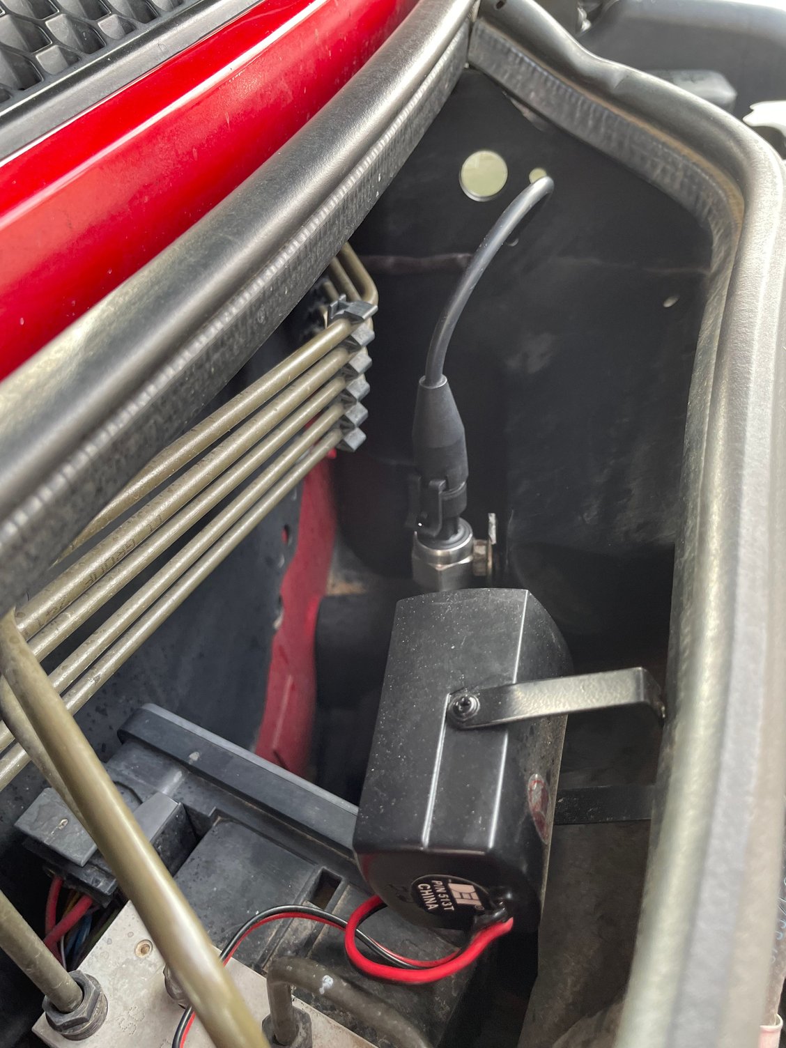

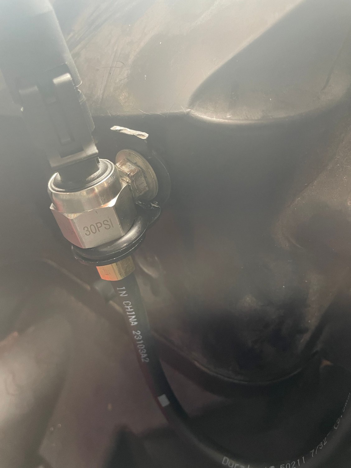

We are doing ours a little different than all the DIYs. Not running hose all across the engine then back to the Booster area, because this isn’t an analog gauge, came up with a better idea (I hope)
Went ahead and put in the vacuum hose and T from the FPR nipple and ran it straight back with the other evap and fuel lines to the plastic wall. Slightly expanded a pre-existing hole with an unibit, then thru the wall and left a few inches of slack in a “drip” loop. That way if we even need to lift up engine for tensioner, mount etc there is slack there to allow for it.
made up a right angle bracket to hold the sensor upright and low enough so it’s out of sight, but with easy access to unplug it and bolted it in thru an existing hole.
stopped there for night, tomorrow is find 12+, ign and illumination, then connect ground, and run the 3 wires for sensor out the firewall, sleeve it in heat shrink amd solder the sensor pigtail.
before we did so though, got a 9v battery out, twist connected pigtail amd played with the guage to make sure it worked. It did show us at less than 0 which is correct since we are at 4,000 feet ASL.
Interestingly, bmw orange auto overrides the white illumination, so if you wanted you could set it up to have white illumination daytime by connecting that white wire to ign+ as well, then turning on lights would auto trigger the amber instead via the orange wire. I don’t think even with it being recessed into the vent it will be needed, but it is night to know it is an option.

Photo dump time.
Came out very nice, & still quite a bit of airflow around gauge, like very very slightly closing the vent butterfly. Not much lost.

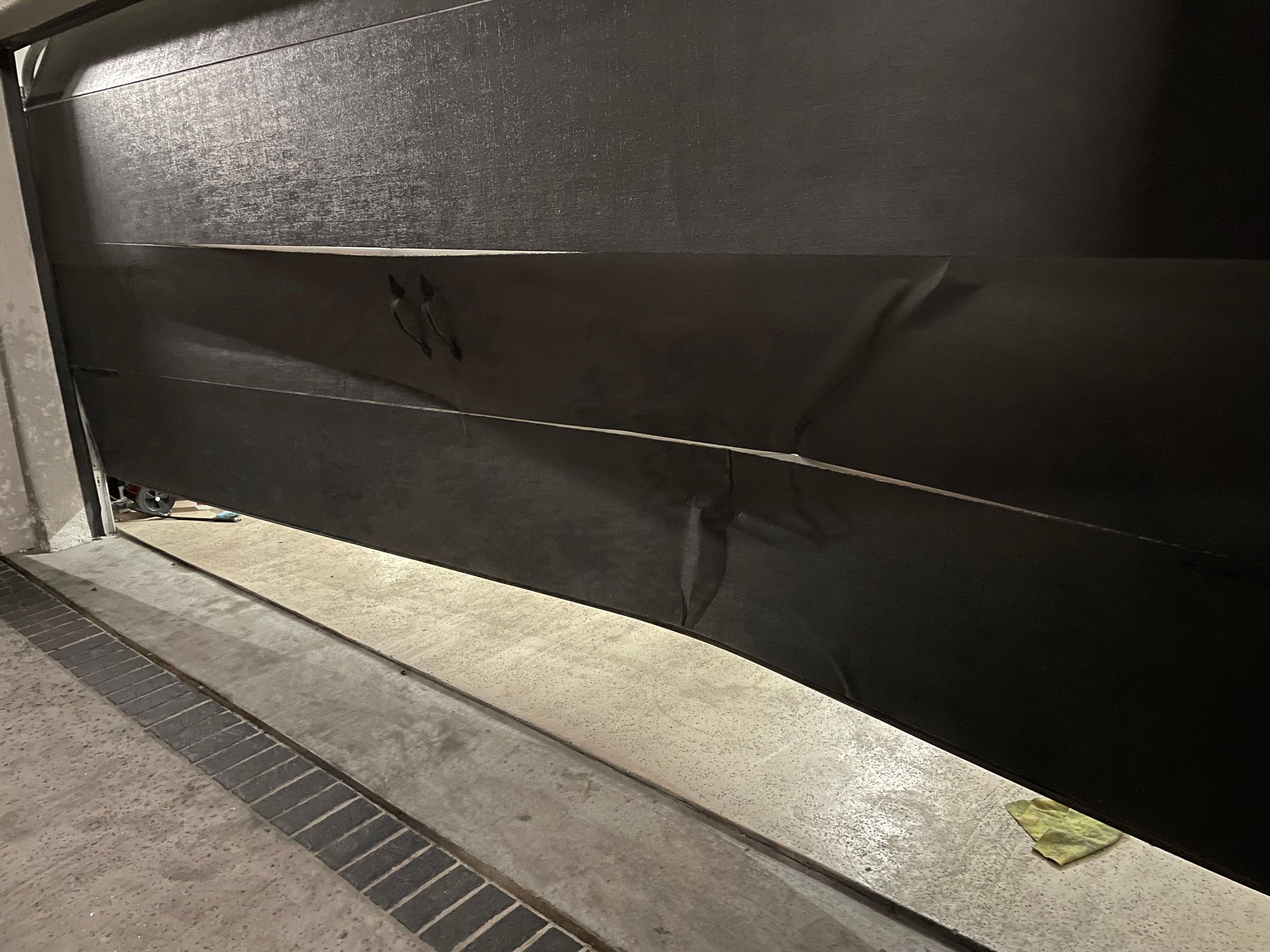

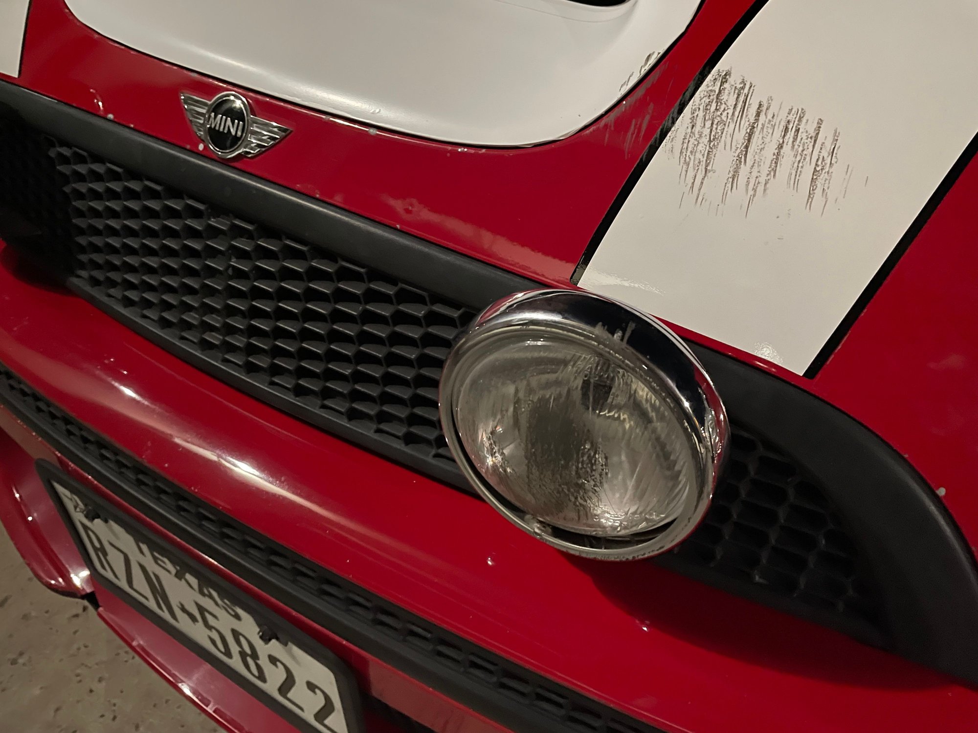

Took it to a trunk or treat car show a few blocks away.
because the clutch is easier on this one let my wife drive it while I drove mine.
She said she could drive stick.
She can’t.

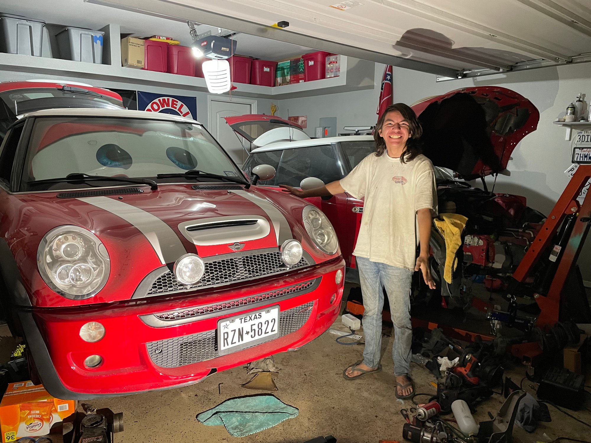

She drove it thru the garage door.

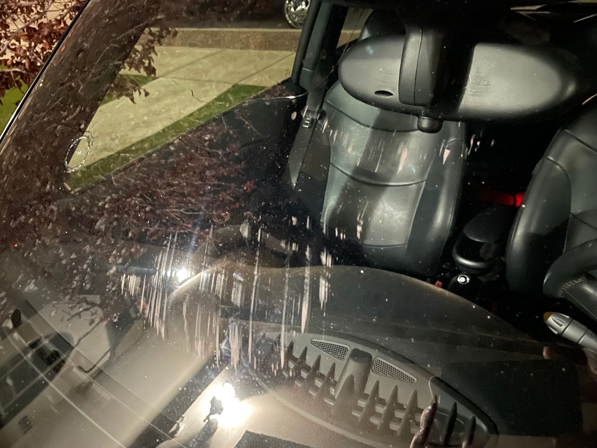

Now I need to buy a new garage door and learn how to install that, and buy a new windscreen and new OEM/Mini driving lights for Alex’s JCW.
the windscreen is pretty severely scratched, and the poor OEM driving lights took the brunt of it. The lenses are smashed back into the housing a good 1/4-3/8” and since they don’t turn on I’m pretty sure the nice new cool white bulbs I put in them are now kaput.
At least the aero bumper was ok but F me. Every time I finally get everything fixed…

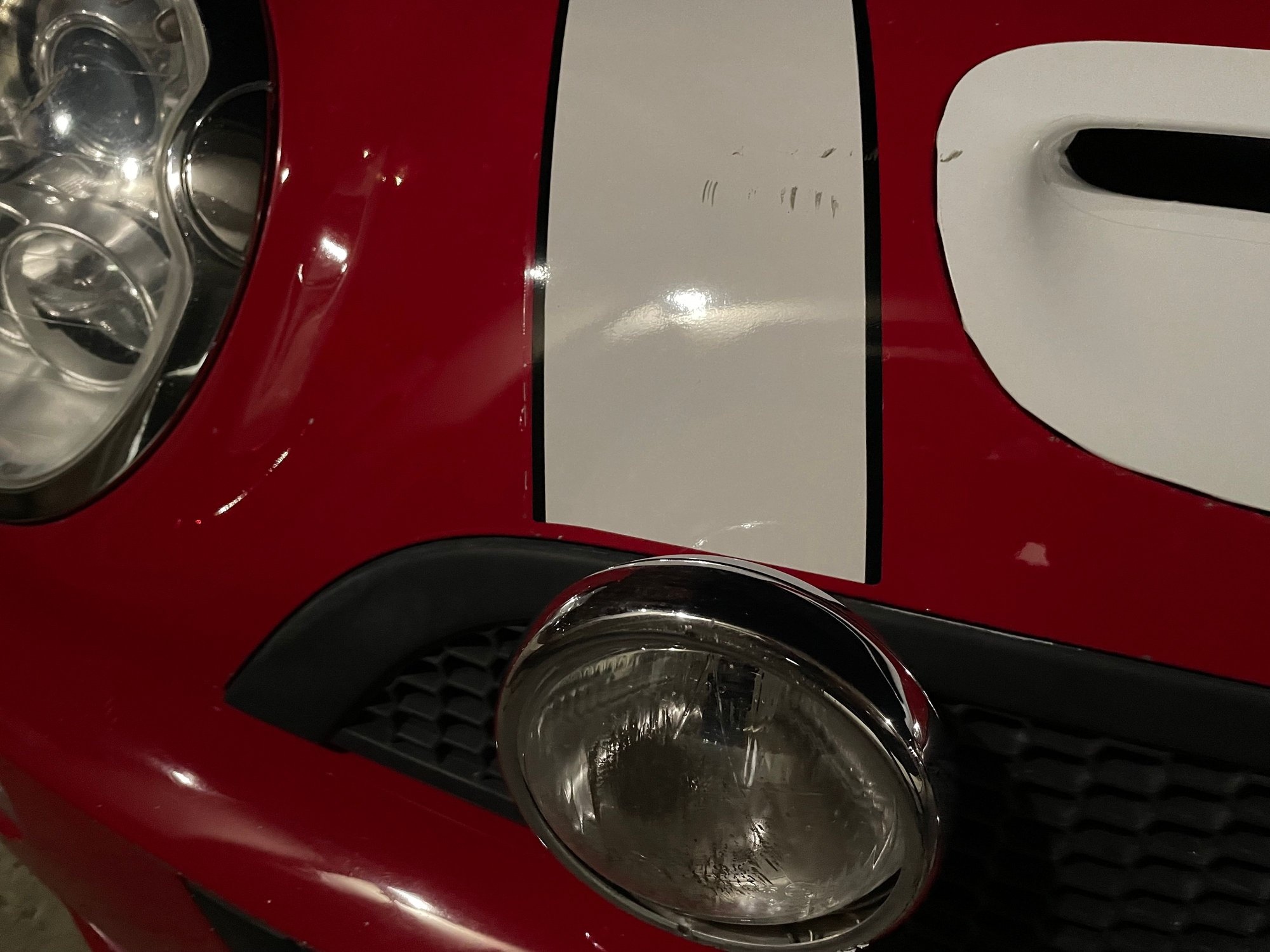

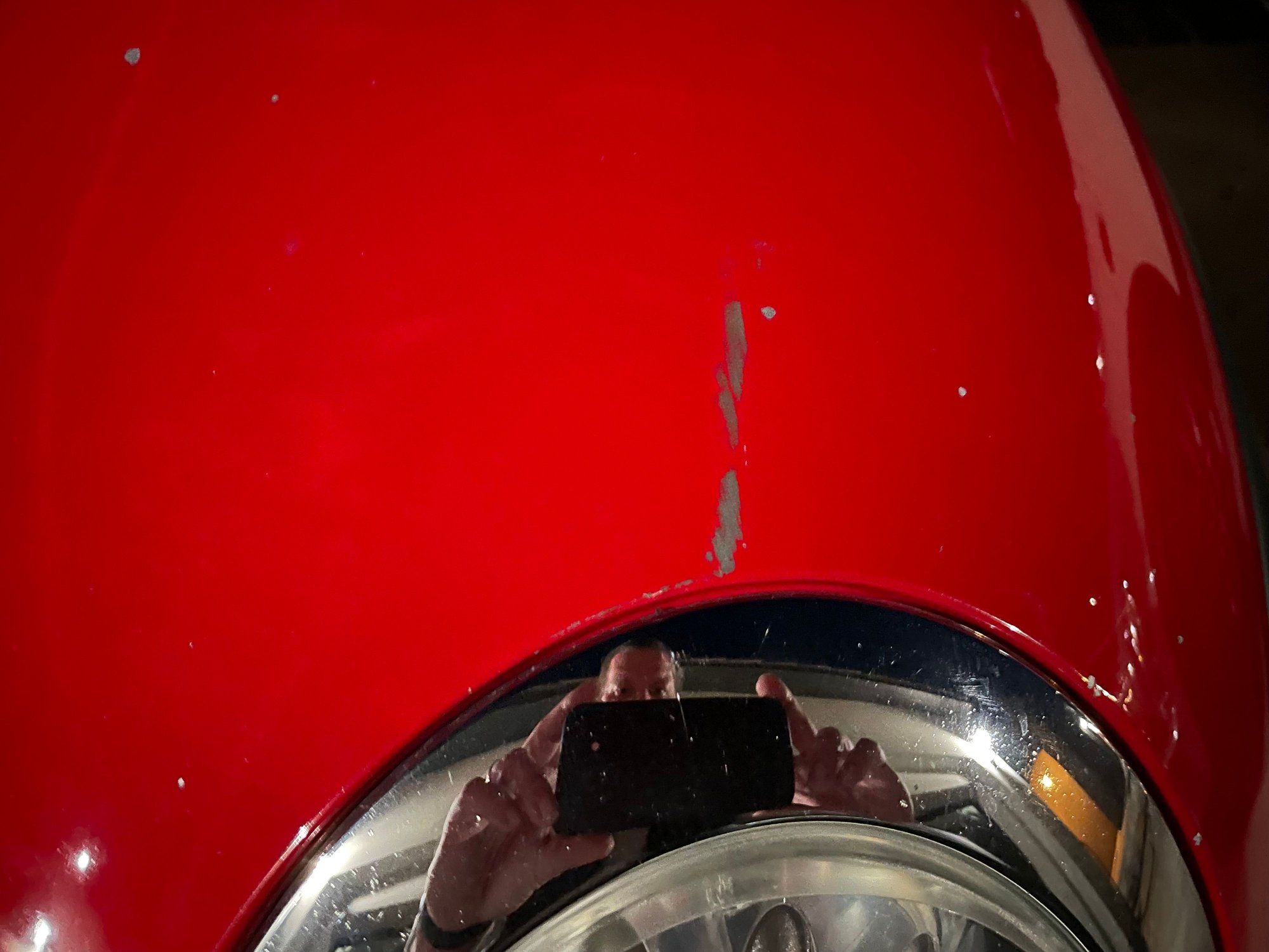

surprisingly enough I Salvaged everything. What felt and looked like scratches was thick paint transfer. Couple scratches on headlights and some super minor scratches in the stripes…but got really damn lucky. That and it had a good coat of wax.
Other than a few scratches, only true damage is a Short in the wiring for one of the driving lights, but managed to polish out all the paint transfer from everything and correctly reseat the lenses in the buckets etc.
about to go figure out where this short is and fix it.

The short was one of the H3 bulbs itself got distorted on the backside so it was a short to ground. Other than that everything was fixable.
Ordered a new set of nokya 55w 3800 for them and we should be good,
other than the garage door which is totally bamjaxed.
